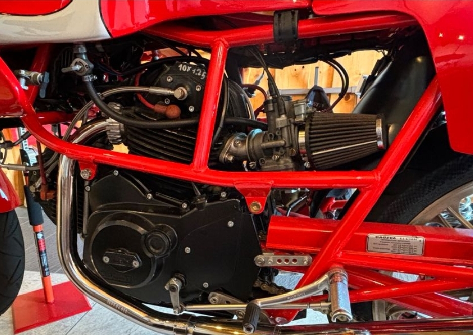

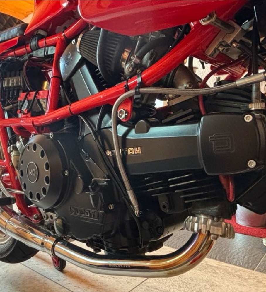

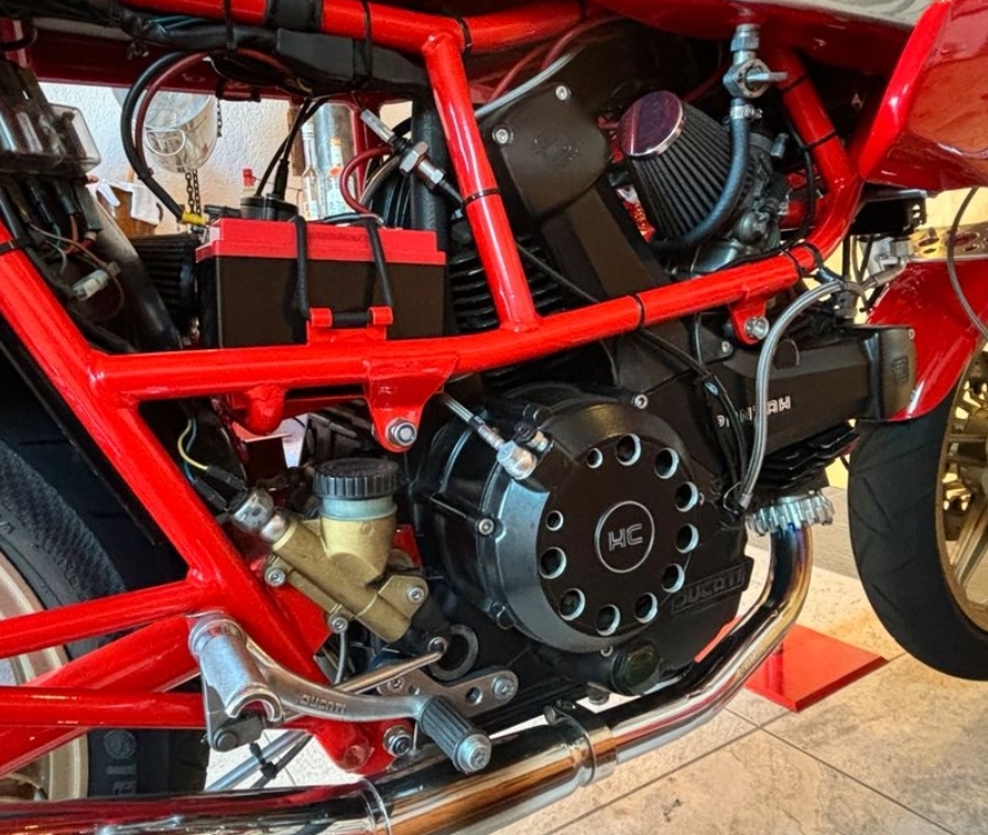

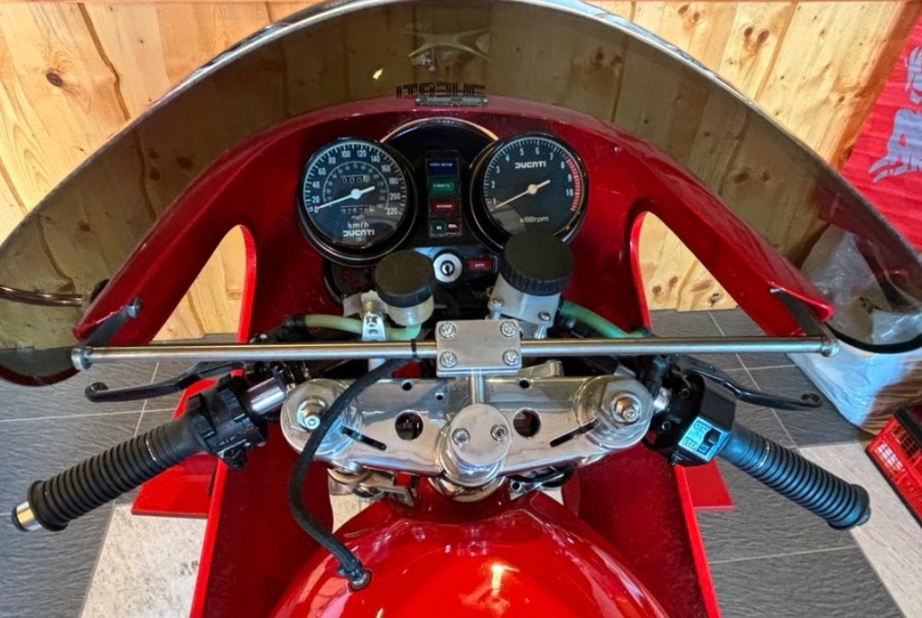

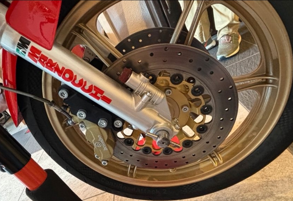

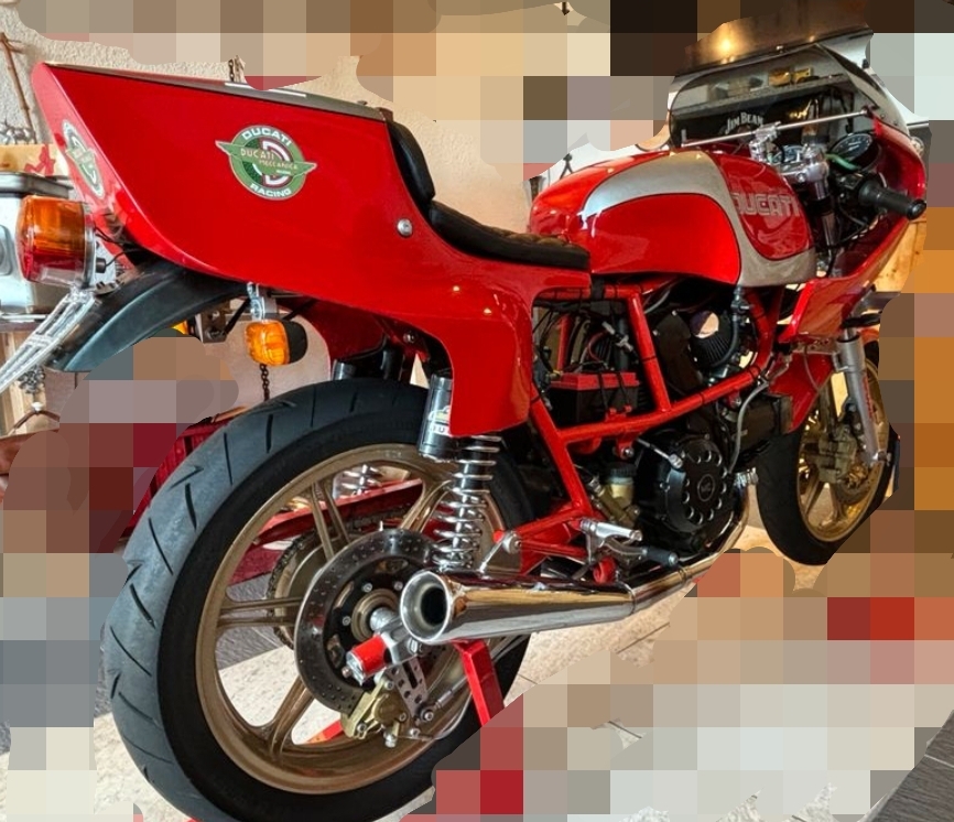

  3. Hello,
    I add here some pictures about the bike. Normaly there is an original black exhaust with it (that should be the original one instead of the mounted contis).
    Anybody any info about this model?

  5. So what can we see in the photos?
    Standard Pantah frame, painted red, later front forks and brakes.
    Late Pantah-type engine but dry clutch and external oil feeds, finished in black.
    Not made by the factory; somebody has made a special from it.
  6. I believe that Ducati homologated a 750 race bike by producing the 650 Pantah in limited numbers for one year. Maybe they shoehorned one of the racing engines into a standard Pantah frame.
