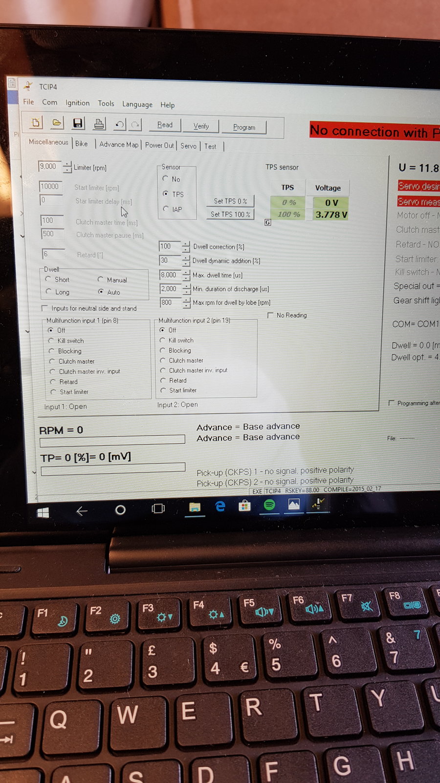

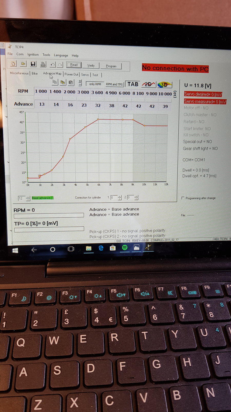

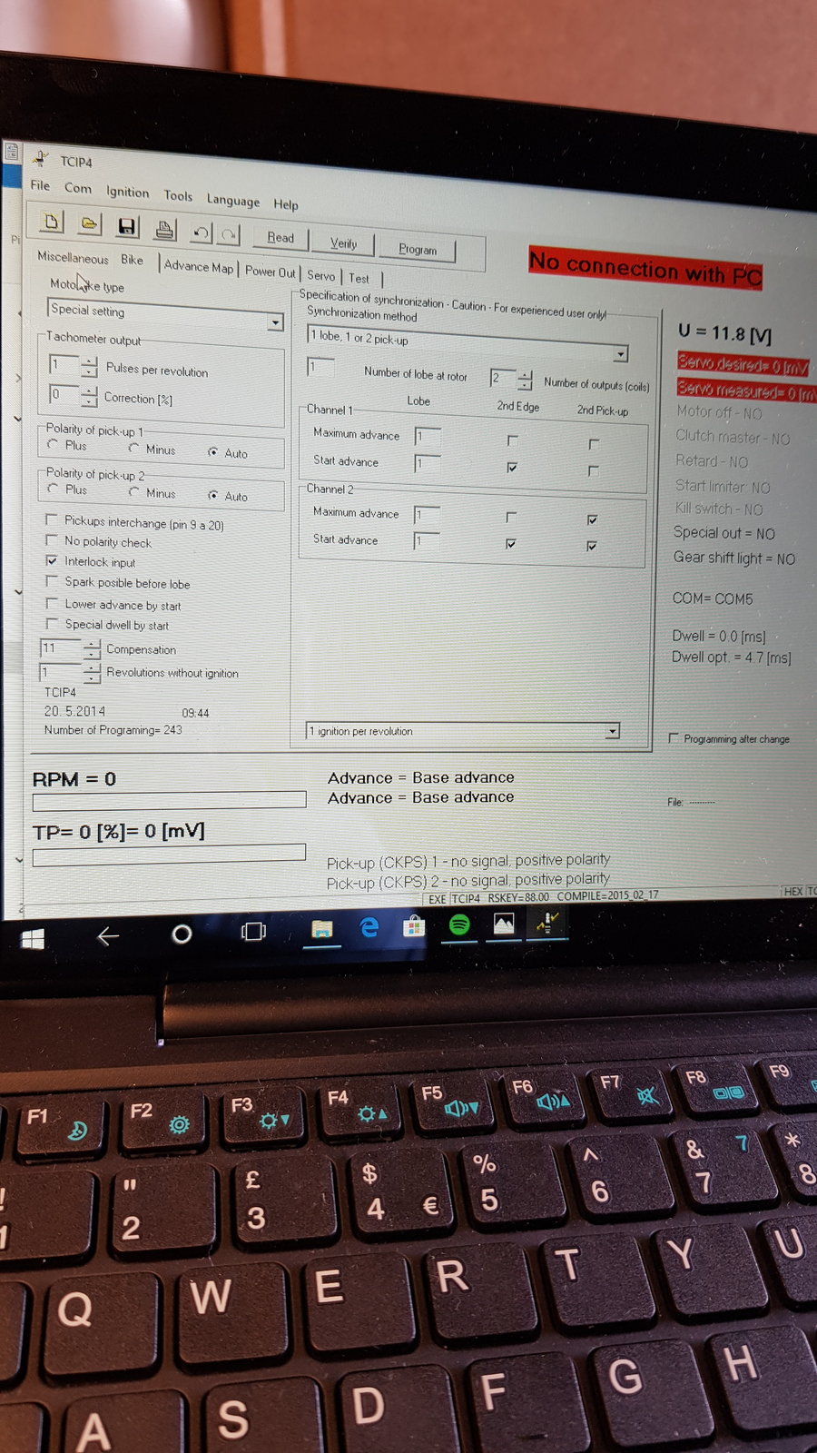

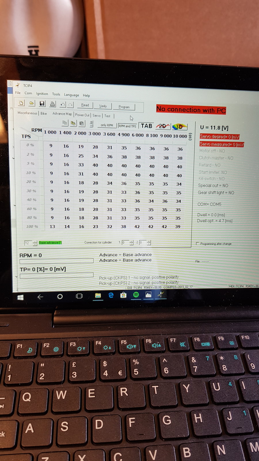

  7. Ok, as promised!! It's set up with the TPS so I included the 2D and the 3D versions. I use one of the outs for the shift light, which is currently set at 8000 as it revs a lot easier than a standard engine. I'll probably reduce this down as it doesn't need to be up there to enjoy. Hope it helps. I can list my mods if you need 20181110_112754.jpg 20181110_112908.jpg 20181110_112921.jpg 20181110_113048.jpg
  8. Hi Ian, Thanks for the pics, it's really interesting to see. I'm amazed at the amount of advance you have at the top end... are you running high comp pistons too?
    Here's a couple of pics as to what Ive figured out works on my bike for a comparison if anybody is interested......

  9. I am indeed running JE high comps
  10. Great to see both set ups, I will set mine up with the TPS and start with the supplied map but really unsure about adjusting etc. Apart from the FCR's, open air box, K&N filter and a lightend flywheel mine is standard with regards to pistons etc.

  12. You can download the software easily from their website. You could leave your laptop with them, but they may want it on their computers, ask them. For the TPS all you do is set up the 2D map and then click the box for TPS and set the 0 throttle and 100% throttle voltage levels. Then when you click the TPS map it automatically comes up with a basic 3D map, which can further be fine tuned. Hope that makes sense
  13. Hi Ian, ok thanks for the advice. with regards to the TPS when setting are the voltage levels set automatically or do they need to be manually set? Is it a case of fully closed to fully open and they set themselves, bit like a PC3 setup.
    Thanks for the advice.
  14. Yes, you select it at zero throttle opening, click a button, then fully open and click that. Mine came in at a little over 4 volts at 100 percent throttle.
