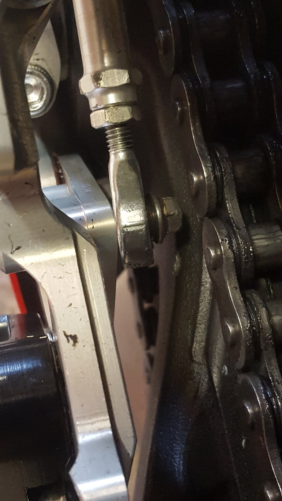

  1. Hi, i fitted some used DP rearsets to my 1299 today, all working ok until I got home and noticed that the nut that holds the gear linkage rod to the foot rest lever is rubbing on the swingarm slightly.
    I have checked the fitting instructions and all looks correct - the only thing that could be an issue is that they are for an 1199 and not a 1299 although I understand that there is no difference.
    Has anybody come across this before, any help would be appreciated.
    Cheers
  2. File it down or fit some spacers / washers between the rearset and itd mountinf point would be my advice.
