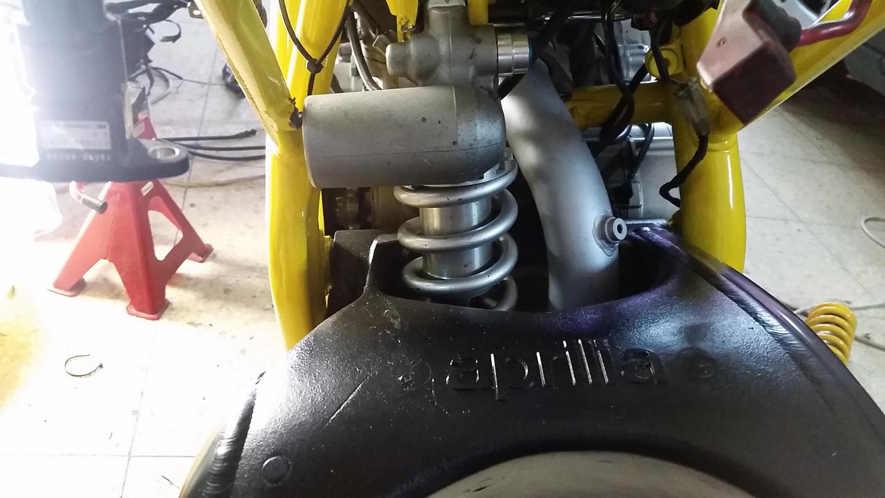

  1. Having had a look at to see why wheel's where out of line by 14 mm, I found that one of the swing arm pivot point's was 5 mm further back than the other one and it was out of level with the other one by 5 mm again. Oh dear silly buggers.
    Another problem I did find was that the Cagiva engine runs a 530 pitch chain and the Aprilia rear wheel sprocket run a 525 pitch chain. Do you think I can find 525 sprocket for the engine or a 530 rear sprocket. At the moment I have a bought a set of 520 pitch race sprockets to help line up sprockets which are double the price of normal sprockets. Any one no if there are 530 pitch sprockets available for RSV Mille or 525 pitch sprocket's for Cagiva. My other option i suppose is have a look for a Cagiva rear wheel on ebay and see what they look like any suggestion thanks.

    I used the Cagiva wheel with the RSV swingarm on my Raptor.
    I think thats the easiest and cheapest way to make it.
  4. Thanks, Have thought of this, only found one rear wheel for a Cagiva, asking to much money for it and it's not complete need disc and rear sprocket carrier. Got the two Aprilia wheels for song. will sort something one way or another. Have not done a lot to it lately other bikes and stuff getting in the way at the moment.

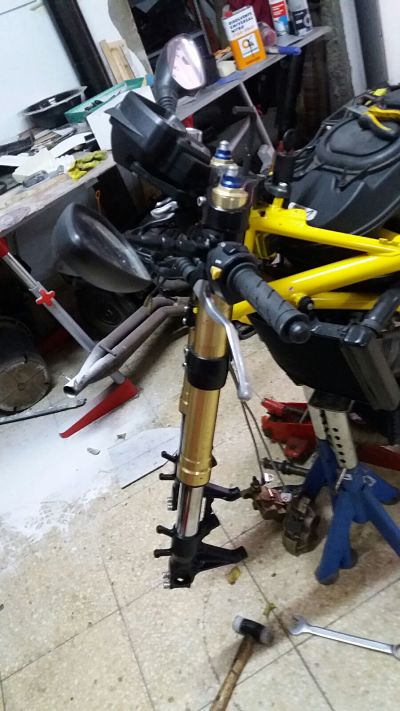

  6. Yes I agree with you. I have now a complete front end of Aprilia RSV mille fitted straight on. I am trying to keep the project mainly Italian I have some MV part's lined up.

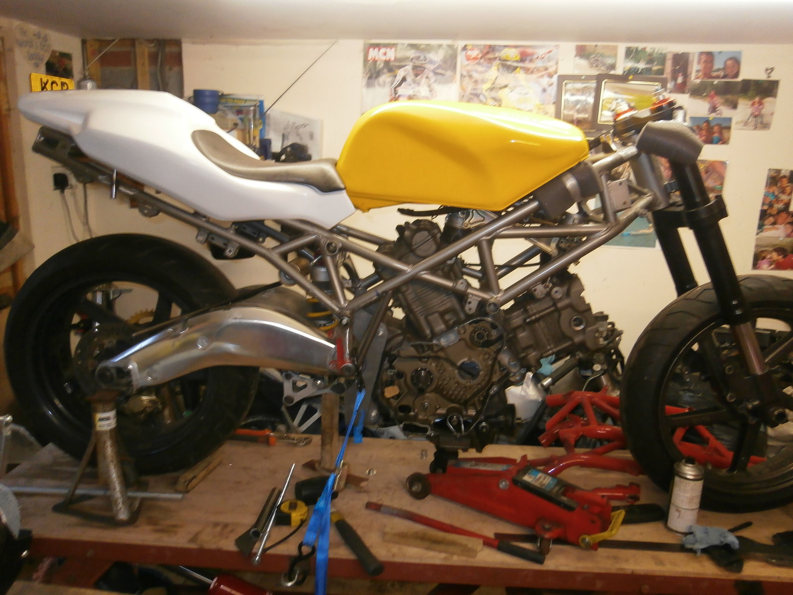

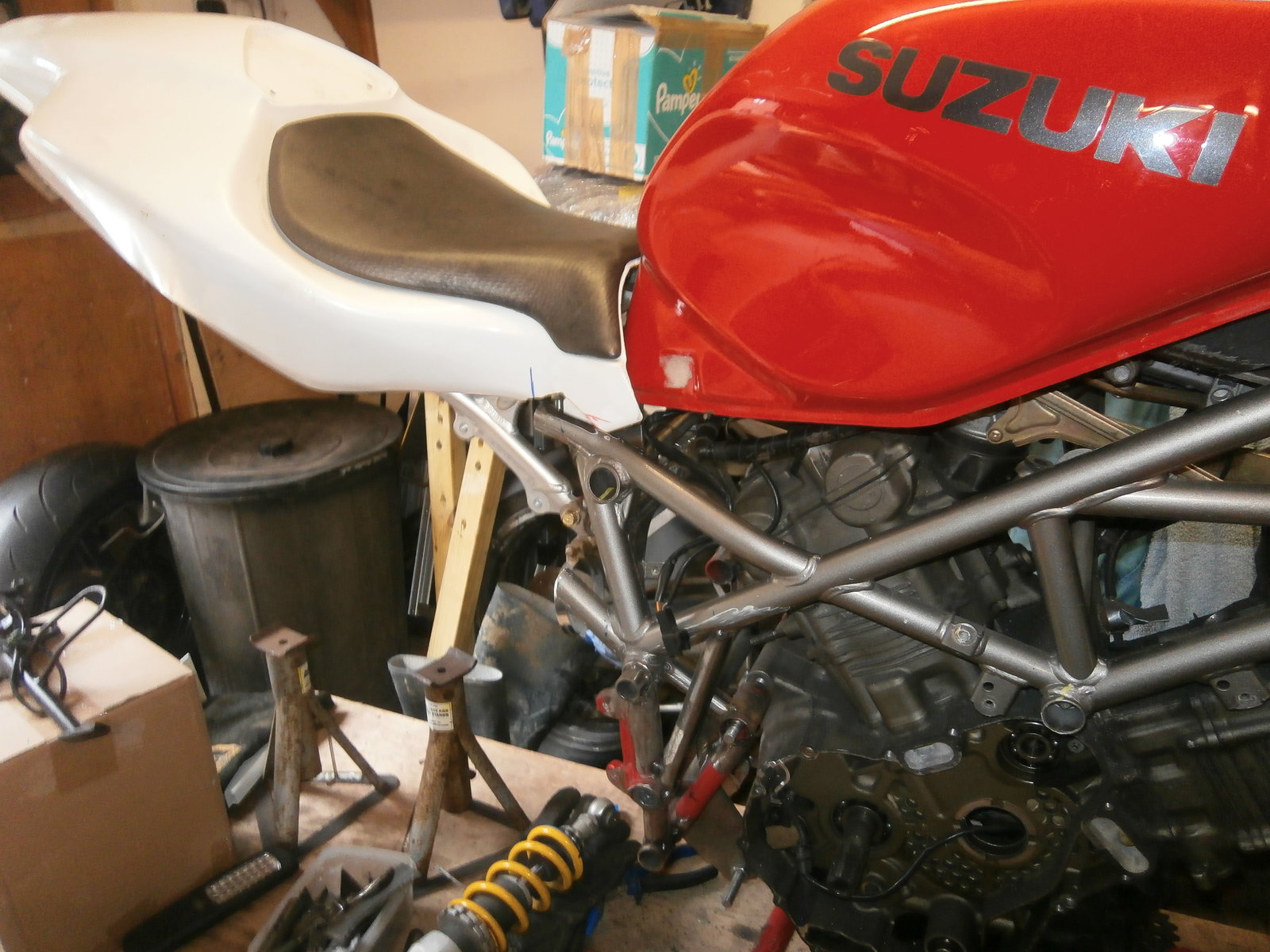

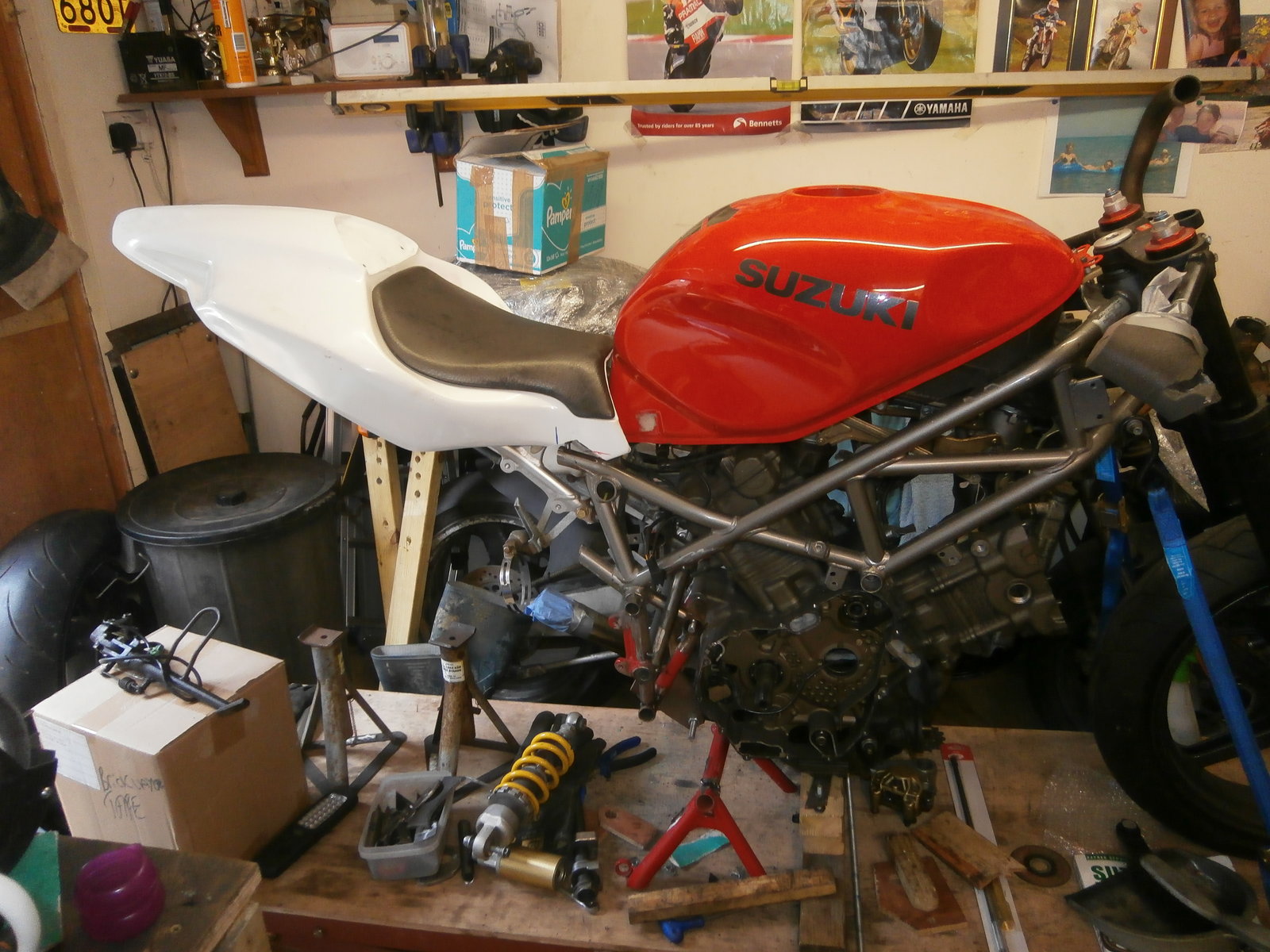

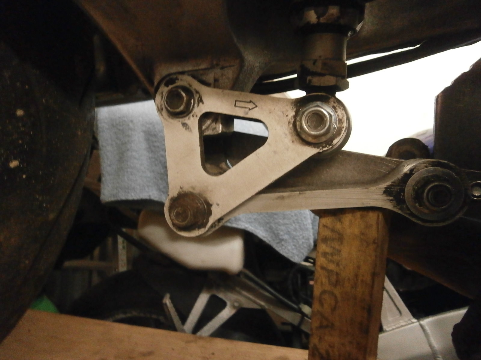

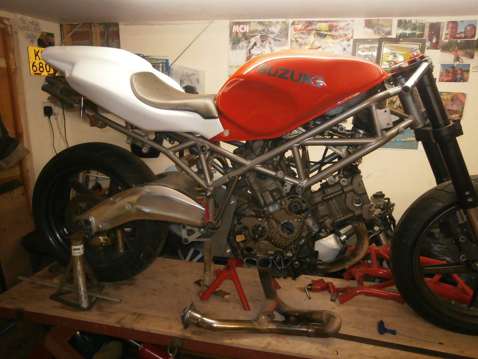

  8. P1130002.JPG P1130003.JPG P1130004.JPG Been tinkering, got MV F4 seat unit which i like the look of the seat pad came from USA half the price inc postage than anything here. Got a sub frame coming from Italy again inc p&p half the price of whats on ebay here, just got to wait for it before chopping the rear frame off. Tired a 916 tank just didn't look right to me, got a TL tank for a tenner, fits like it was made for it just a couple of minor mods when i am happy with it.
    I got some idea of how i want the faring to look anyone got ideas or opinion what might look good.
    Having fitted a Aprilia rear end any one no of a rear shock the same length as the RSV Mille with a remote reservoir as the shock at the moment has fixed and is in the way of where i want to route exhaust, so i can look for cheap ones to try and make work. shock length is from bolt hole centers 300/315mm long.
    On lower shock linkage there is an arrow is this just simply for this way forward or is there a reason for it. P1130002.JPG

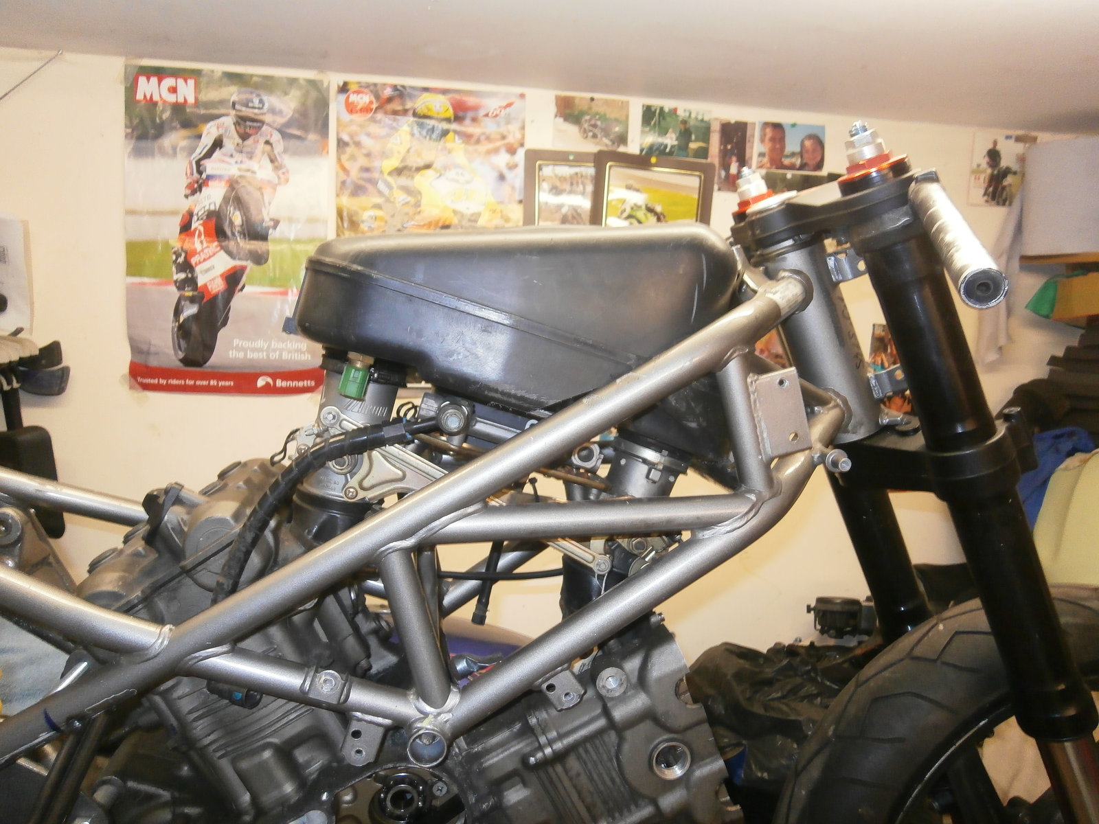

  10. On the air filter, I presume it rests in the bottom half below the seam line? If that is the case would removing the top of the airbox above the seam line give you more tank fitment options?
  11. Never thought of that. Thanks. Air box is from TL1000s had to cut in a couple of places and heat it up and use metal tube to from shape to fit in between frame tubes. When I finale decide on tank/air box will determine what lugs bit's of frame to be modified
  12. MV F4 seat unit fitted, waiting for some parts from MV for seat unit sub frame been six weeks now:expressionless:, never like the engine brackets so scraped them, made others. Every thing stripped off now, frame going to be welded up properly.:)
