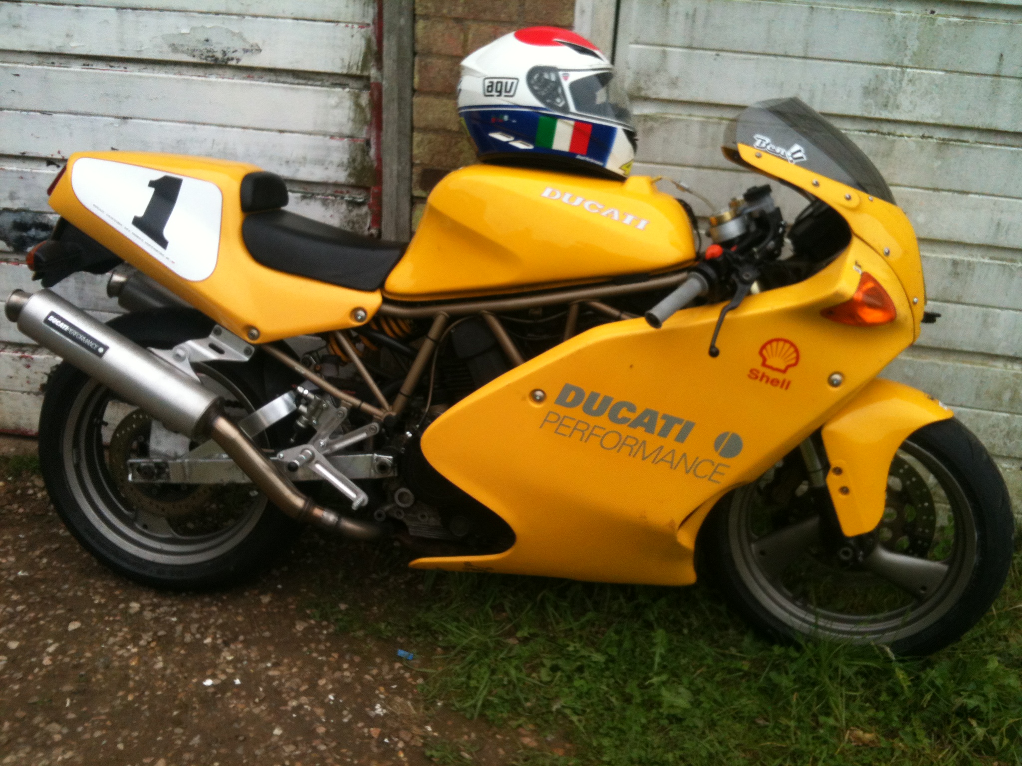

  11. Well, SL cans fitted , bog std airbox with BMC filter ... and it pulls like a train and is much nicer to ride :) - Still a tad slower than I'd hoped for but I can work with that.
    Out of interest, what is a reasonable top speed for the 750 - It might be that my old one was faster than most!
  12. Mine has read 125 on the speedo.........so as yours is yellow, I guess 110 might be somewhere near........
    ........but FFS we can see you don't live at home any more............paint that bl**dy shed!!!
  13. Oh well this pulls 120 easy! And I would paint it, but it is 'camo' no one suspects what's behind a skanky garage door ;)
  14. I say easy, only today with the new found good set up does it manage it.
