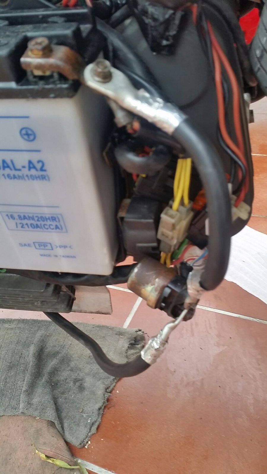

    I resolved the slow straining on starting, which actually has all ways been a problem with cables etc. getting red hot. By making myself a new heavy duty cable kit and it and now spins up no problem now like a new bike..

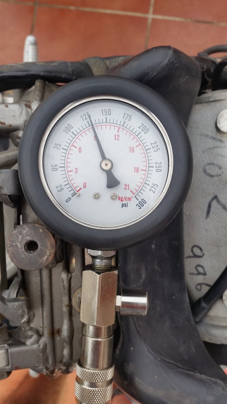

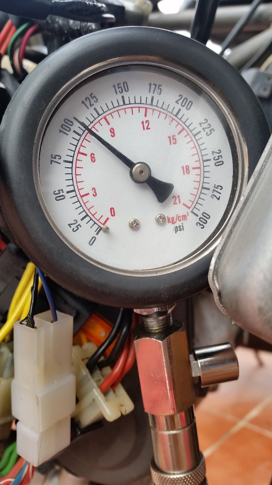

  10. Thanks duke.
    Within ducati specs according to Ducati 1999 workshop book??? but I have to say I googed it and it does seem low according to a few post I saw. . Mines an sps engine. So 9 on vertical and 8 on horizontal it says in the book. within limits I guess not then?.
    bt nevertheless I assume from that the valves are good as u say.
    I'm wondering if the vertical cylinder is higher compression because the piston is compressing more due to a small flat spot on a big end bearing only for the V cylinder.?
    .... clean plugs, not oily. dry, no fuel on that pot for some reason.Maybe 2 problems?
    But it doesn't explain why it is not firing properly on that one.
    I really am trying to avoid a engine tear out. And at the same time learning more things. I enjoy to an extent. apart from my lack of Ducati special tools. So I have been trying to avoid the possible inevitable

  11. Not sure if the numbers shouldn't be a bit higher? but at least you've not got a silly low reading (like my Lemans that had 70psi vs 155psi) so I would think your valves aren't bent.
  12. yep agreed.

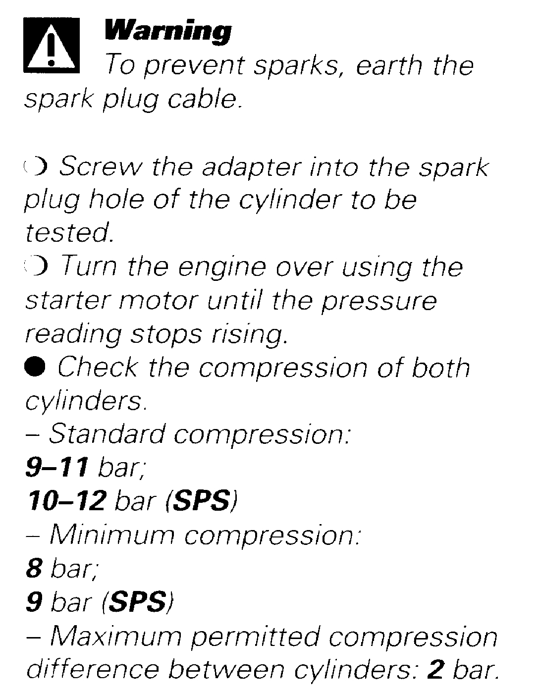

    actually the numbers are spot on for either a 996 or a 996sps. according to the book.
    ufff 70/155. wow. I guess the left failed.
  13. yep. uff
  14. The case on the outside looks in tack, no oil leaks. would that mean normal compression?
  15. not sure which book that is Nick but I wouldn't call 110 psi 'spot on'. Did you have the throttle cranked fully open during test? If not then do it again as bound to be an improvement. Also worth repeating again with a wet test to see how much cylinders (particularly low one) bump up. You probably already know a comp test is better than nothing but results have to be interpreted - a leakage test would be better but appreciate that this is a greater outlay.
  16. ah ok. thanks.
    it was a dry test. with plugs not firing just to test for leaks. so pressure from starter only.
    From Ducati 996 workshop manual
  17. I'm amazed that the procedure doesn't mention opening the throttle but maybe those figures are dependent on closed throttle. Even removing other plug and Using a fully charged battery with good cranking speed will make a slight difference to the figures.
