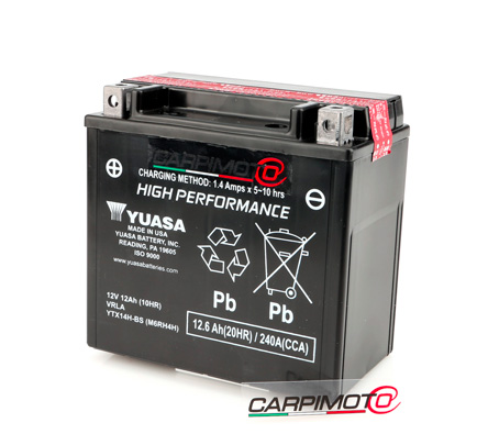

  8. Thanks to the post of @Exige I also purchased a larger battery, but to have even extra margin, I got the Yuasa YTX14H-BS, where the "H" stands for "High Perfomance" and it gives 240 CCA instead of 200 CCA as the non-H model.
    It can be purchased for 70EUR here:
    https://carpimoto.it/it-CH/33669_YTX14H-BS-Batteria-Yuasa-YTX14H-BS.htm
    Btw. before that I had a lithium battery, which after less than a month burned my rectifier. I think that lithium batteries drain too much current when charging, hence overloading the rectifier, or maybe have some diodes in them creating inductive high peak voltages.
