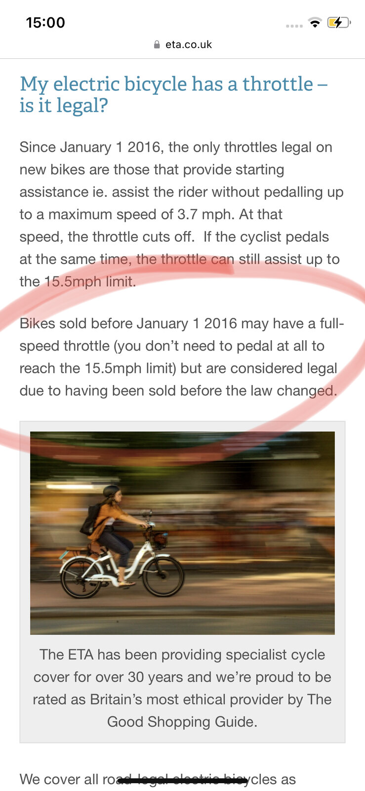

  9. I’m pretty sure that eBikes manufactured before 2016 are allowed to have a throttle. One of mine does (it’s thumb operated) and FWIW it was bought from a reputable bricks and mortar shop rather than some dodgy eBay drop shipper.
  10. if true, the source should have included that in the interests of thoroughness. :upyeah:
    https://www.eta.co.uk/2023/05/10/e-bikes-speed-restrictors-and-uk-law/
    Thoroughness is a rare commodity. Incompetence is the norm. In my experience the vast majority of people are infected with Dontgiveafuckitis and they think “close enough is good enough”.
    NB: that says “sold before 1 Jan 2016” but I’ve read elsewhere that the exception also applies to eBikes manufactured before that date even if they were sold after it.
