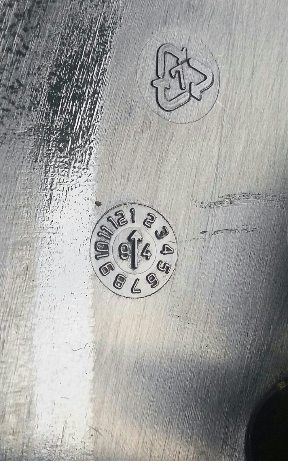

  4. I have some December 1994 Airtubes from a 916 lying around. If you want some pictures let me know.

  10. @Akorenika, thanks for the offer but I have an early set here. I would like to replace one outer cover but wonder why there are 2 part numbers as I can’t see the difference on photographs.

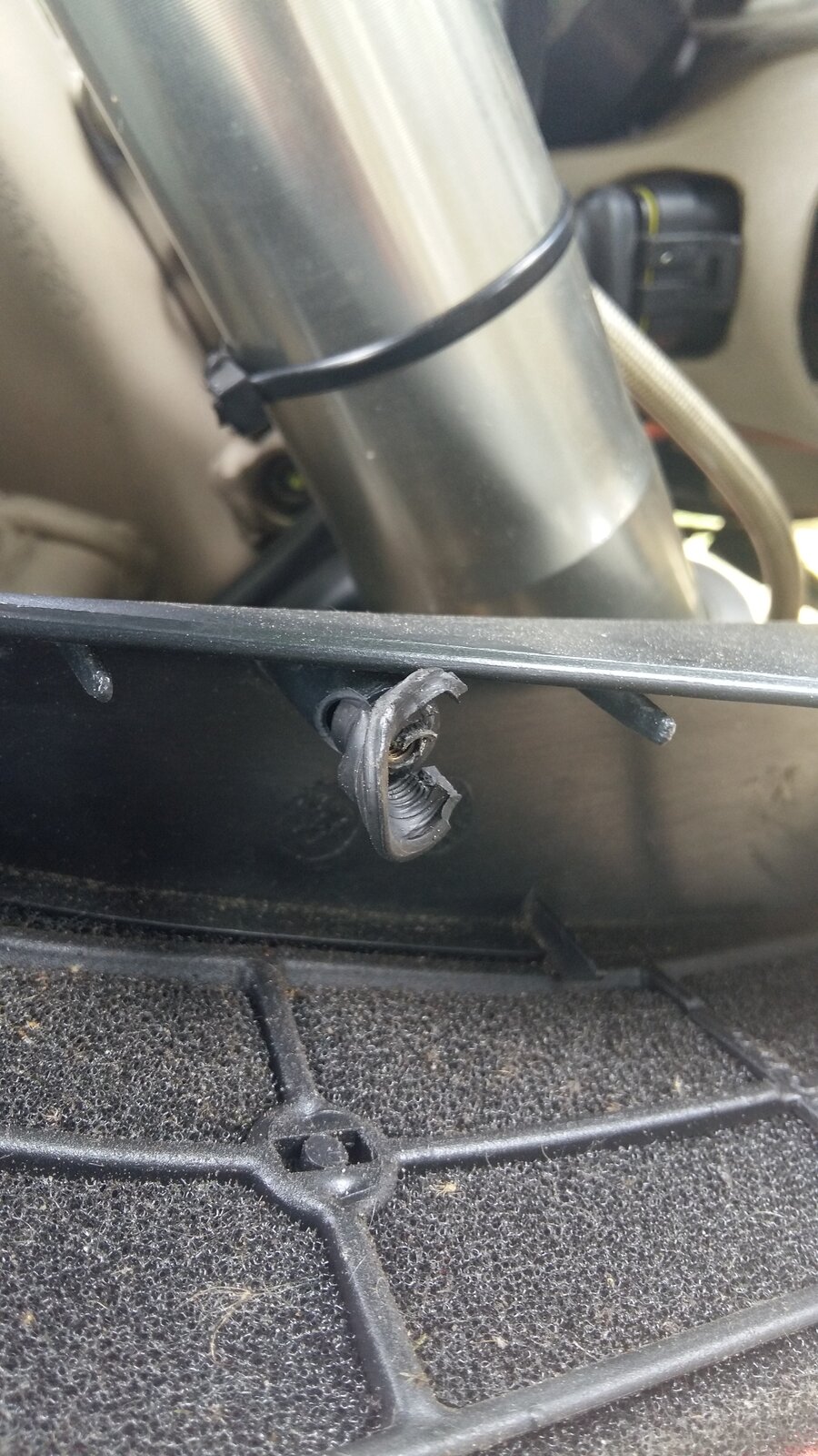

    One day recently, the intake roar on my bike disappeared. Looking at the air tubes once I got home, I could see big cracks in the runners. The rammed air was going straight thru the cracks, and not pressurising the airbox as it should.
    The reason? The rubbish early air tubes!

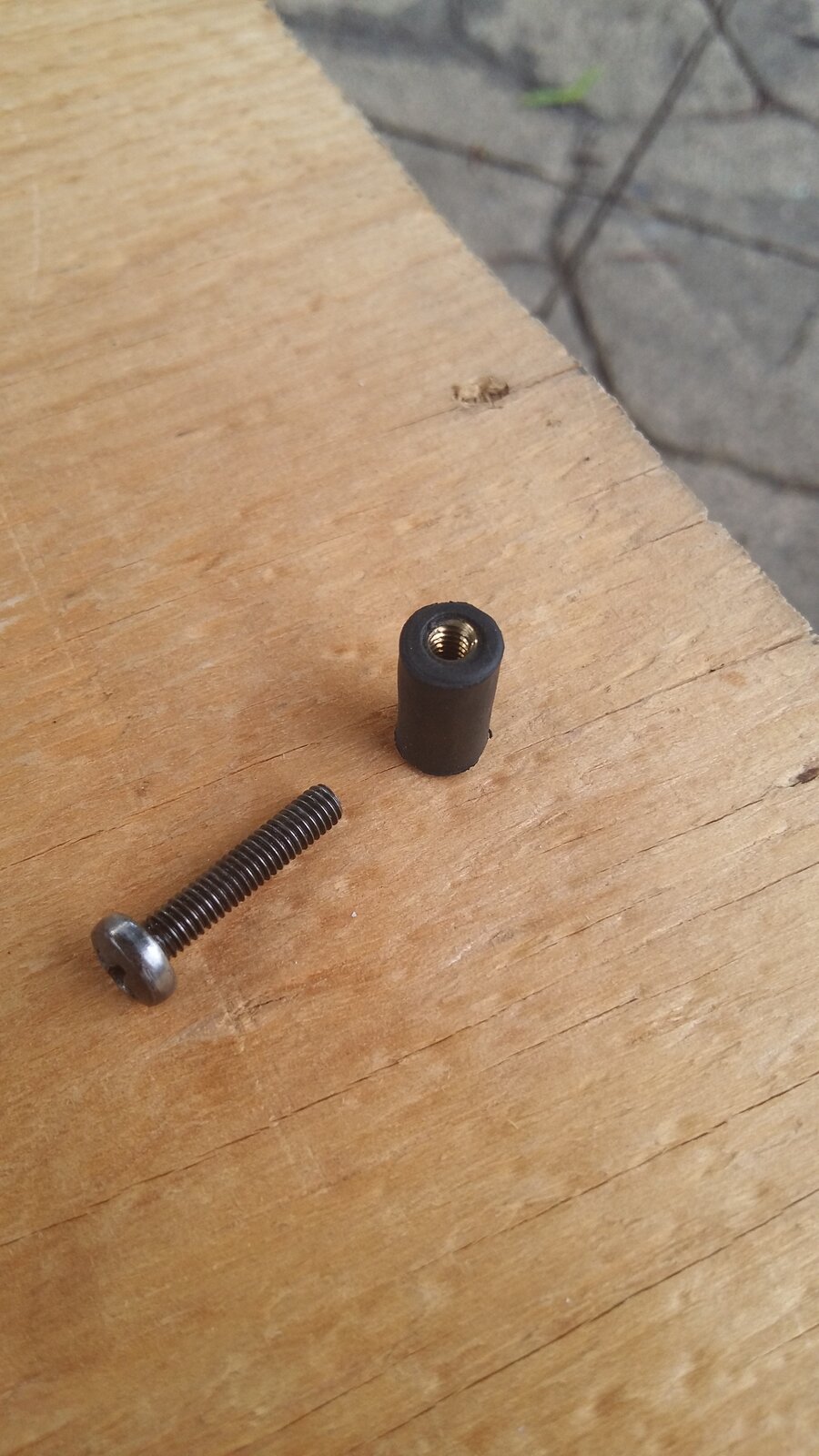

    Seeing as it appears to be early 916 geek week, I just changed all of mine out so you can see the difference if you have a later (post '96) bike.
    Here's the bolt and new nut:
    And what happens to the old nuts over time... you turn the screw but no way for it to tighten.
    Pull them all out and push in the new ones, screw back together.
    Will go for a ride tomorrow and see if the 'glorious intake racket' is back!
    #12 TNR, Jul 1, 2020
  12. Perfect TNR. I’ve never had a later bike with the rubbers in so never heard the difference. Your post also answers what the difference is on the early runners too. The rubber Wellnuts. Thanks
