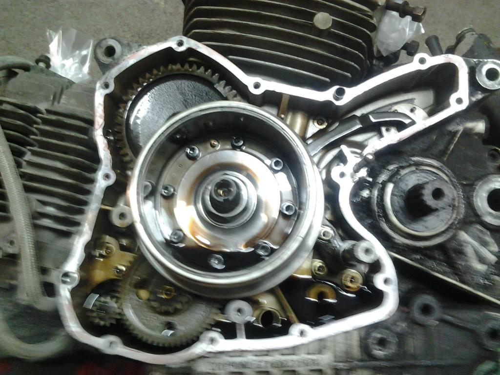

  8. So today i did some work ......... i took out the alternator cover on my 900ie ,,,,,,,,,,,took some pics of it as well ,,,,,,,,,,,looked up on ebay to see pics of a 600 stator ,,,,,guess what ?? should fit perfectly ! So the 600 stator/alternator fits the 900 crank , i should be running it with no headache I just need to time it right , besides that the 600 has got a hole were the alternator wires come out , guess what ? the 900ie has it too,its just tapped and has an allen bold as a cover ! so I THINK i should run the M600 wire harness on the 900ie ,now i just have to buy a pair of inmanifolds
    1st pic is of my engine , 2nd pic is from a duc M600
