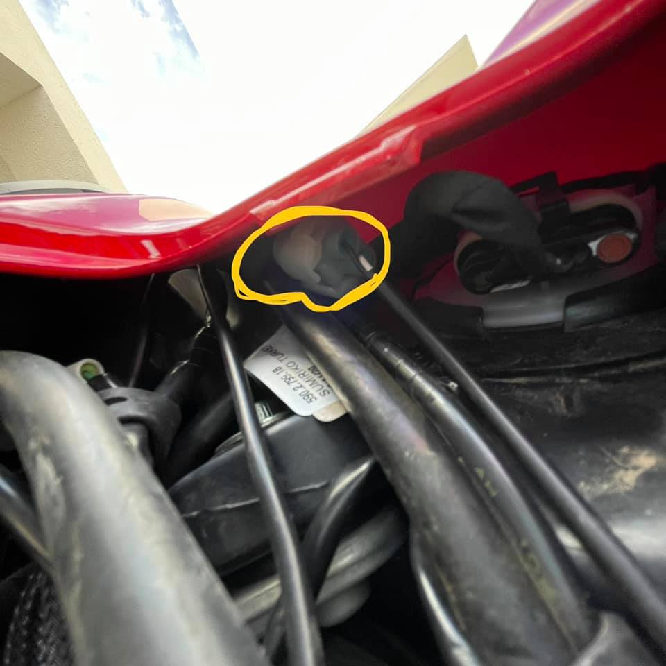

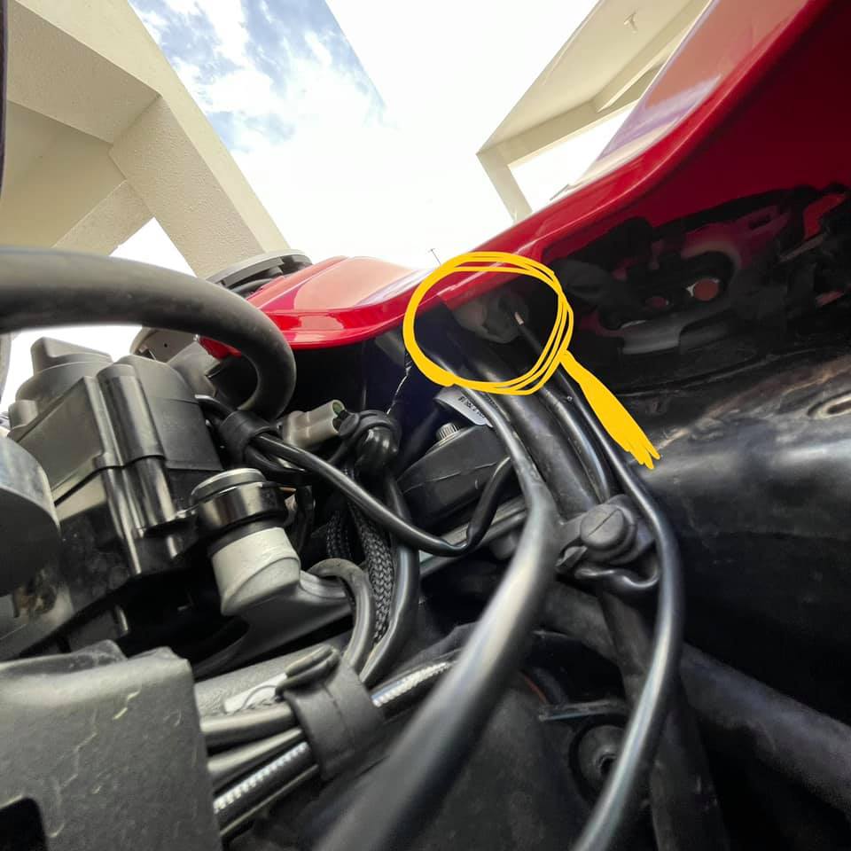

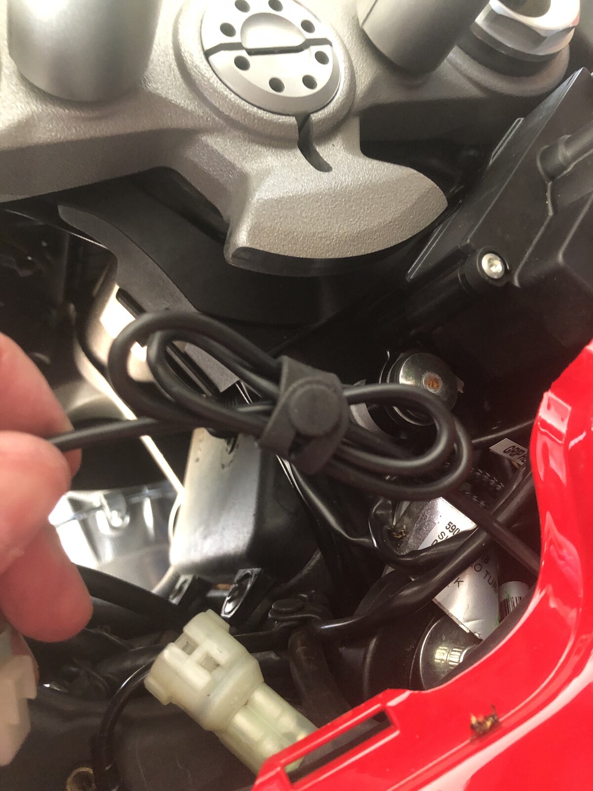

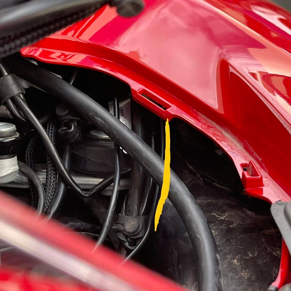

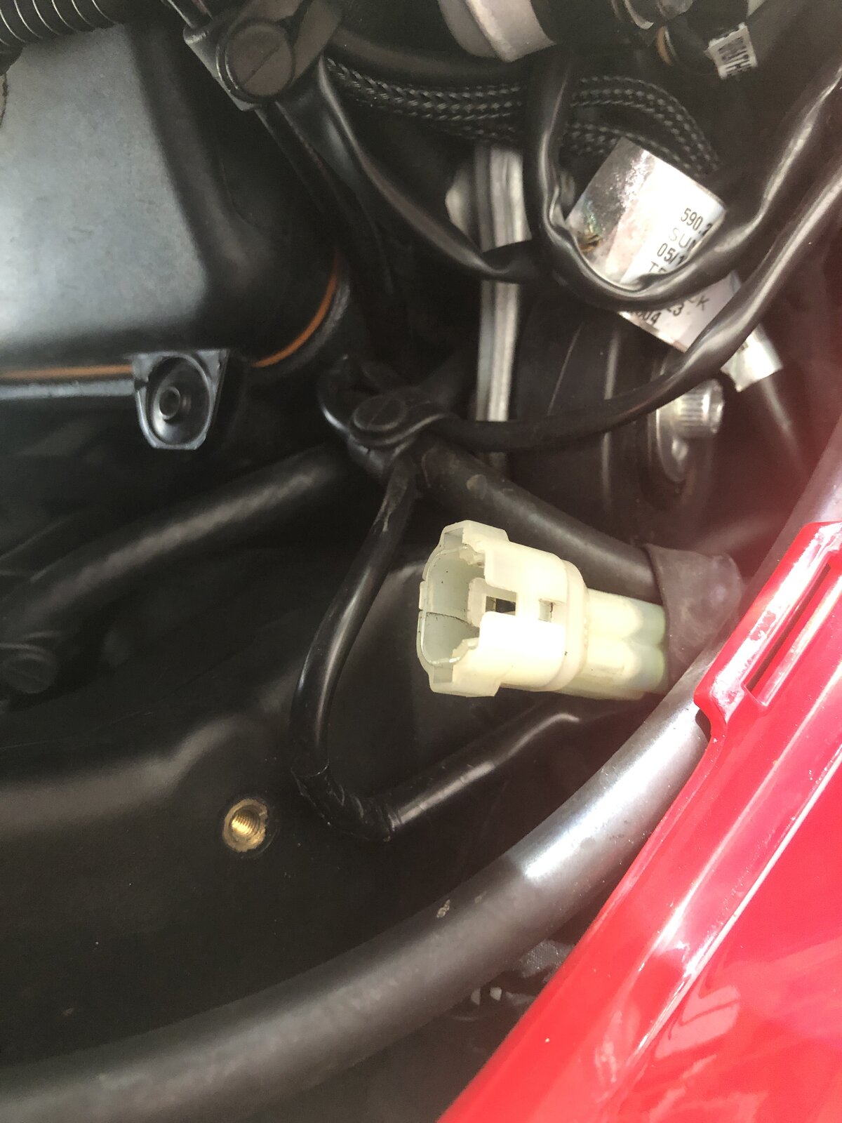

    But I saw a post on facebook that shows where the cable to connect the cap up to is.
    Hopefully this'll help someone
  10. That's brilliant - just what I was after. Many thanks!
    Just need to figure out how to strip the panels now. What could possible go wrong...?

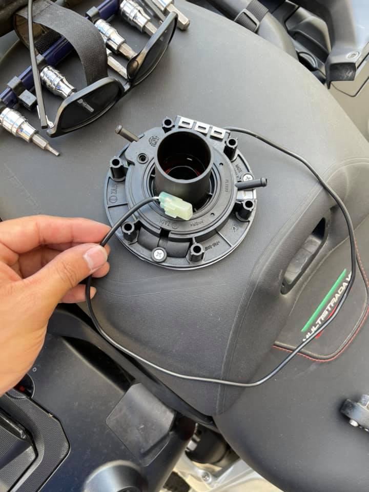

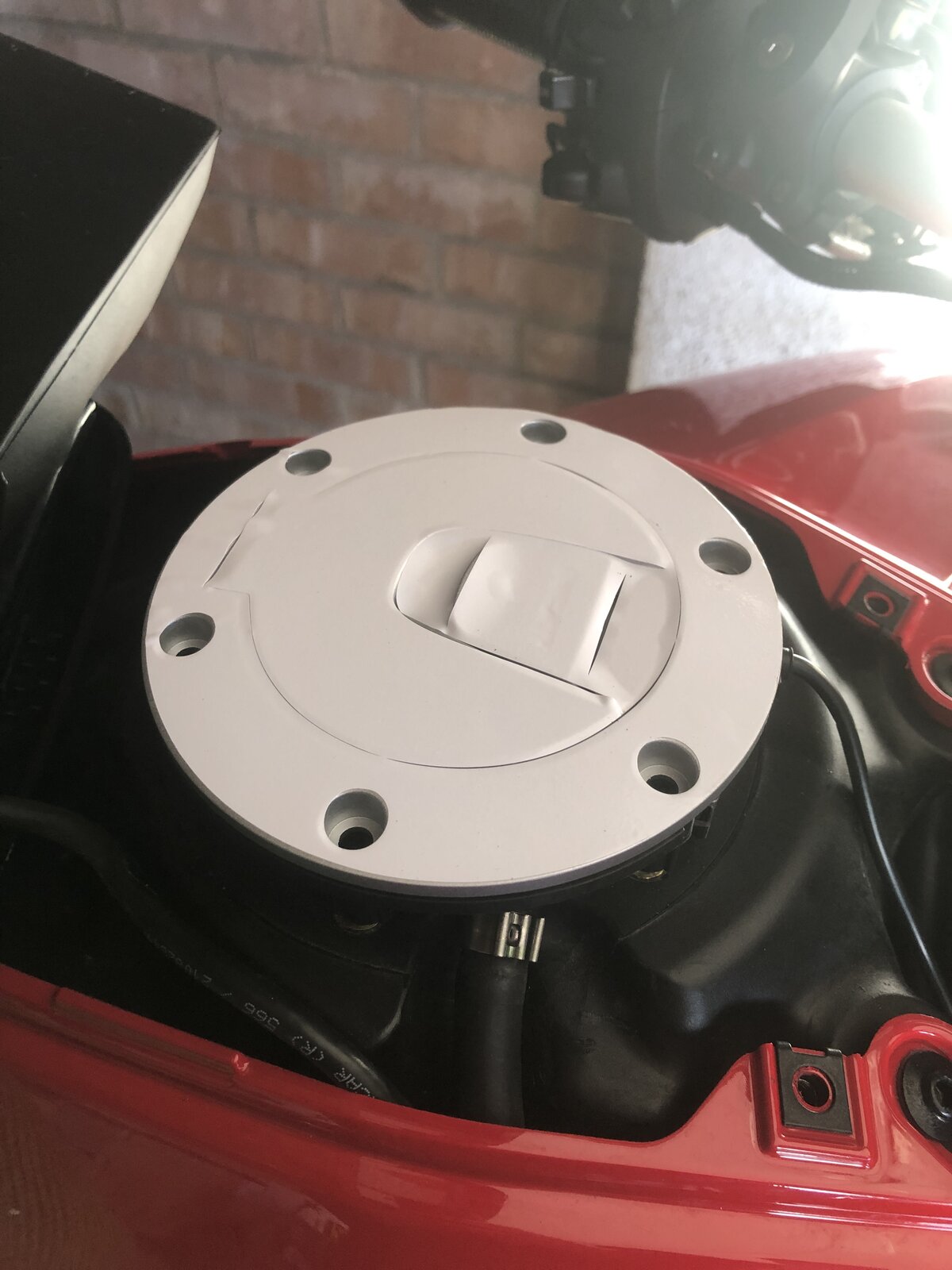

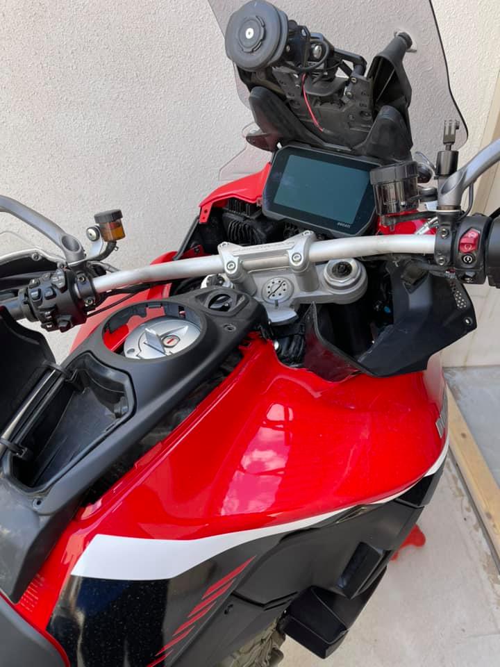

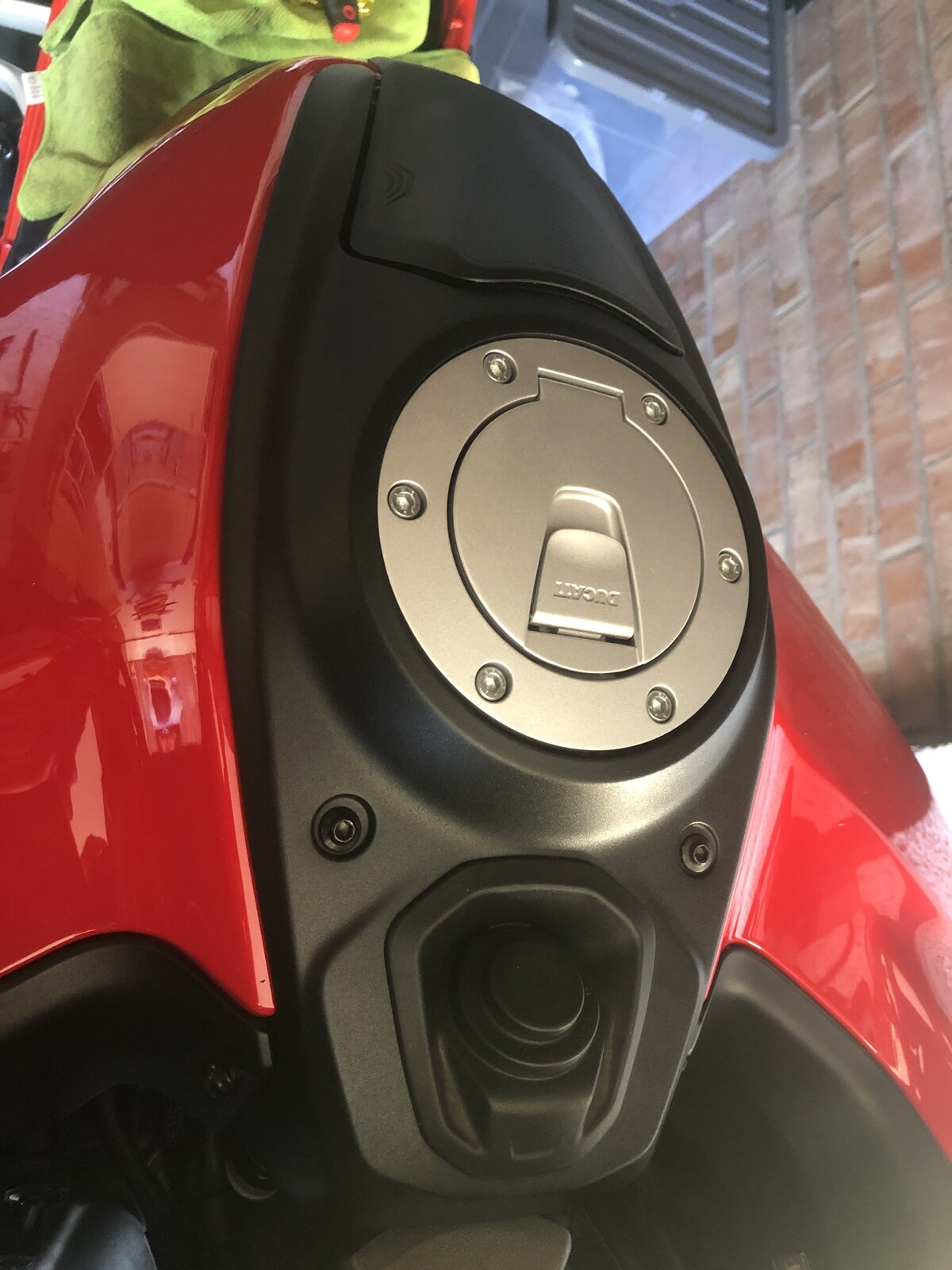

  16. Update: you can see the place to plug the cap into with just the lhs black in fill panel and the fuel cap cover taken off (on the fifth pic). I got completely thrown by the fact that it has a cap in it, so thought it was in use and ignored it until my wife had a "propper" look!
  17. That’s good to know. Going to give it a crack tomorrow!

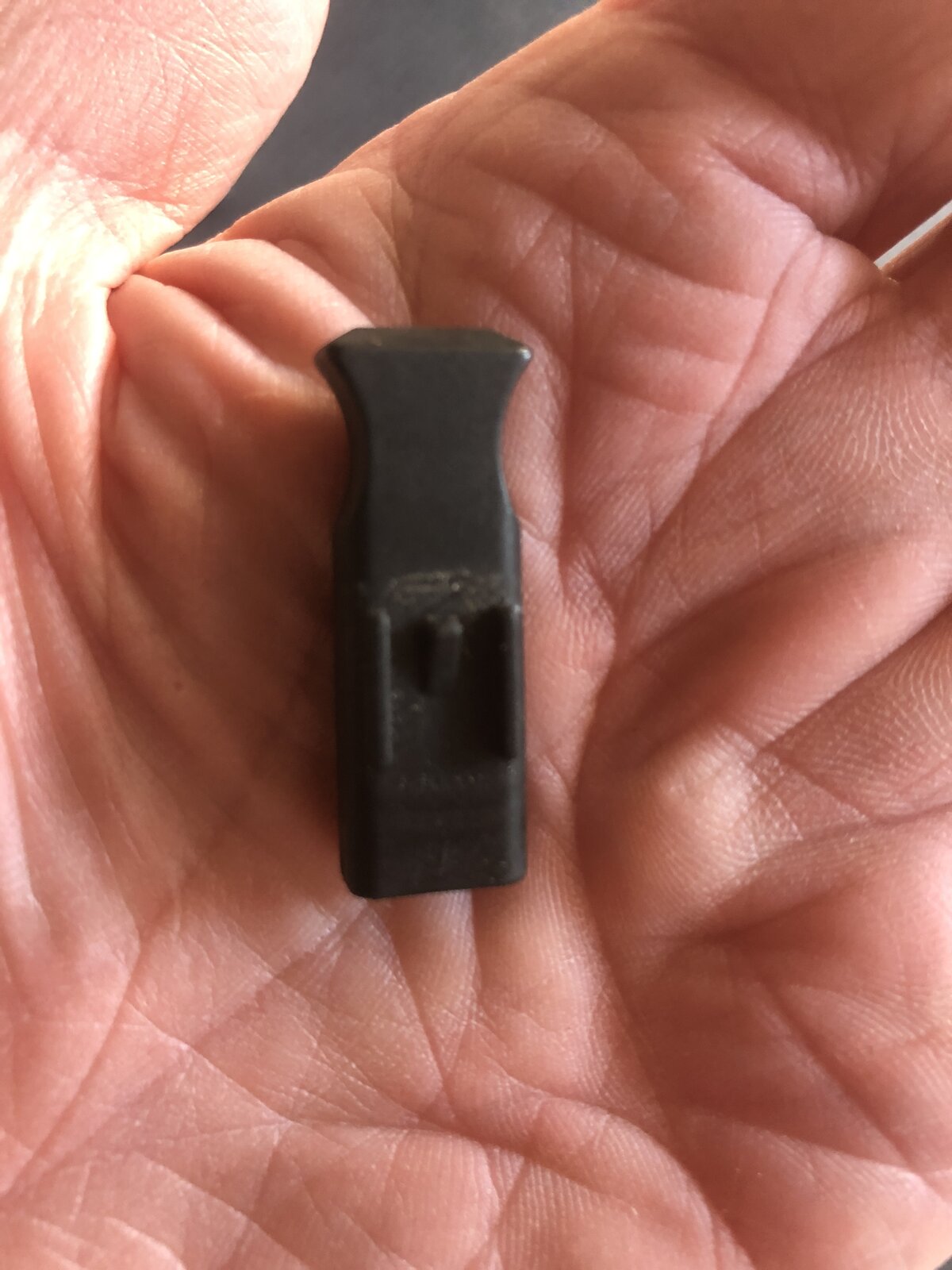

  18. Quick update. I finally got round to fitting the filler cap today. Very straightforward, and the pictures above were a real boon. As has already been said, just need to remove the centre tank cover (with the ‘phone pocket) and the l/h side plastic infill panel. The female connector was really easy to find (and has a small plastic plug installed to keep the crap out). Probably took about an hour, all in (with a decent amount of that being me cursing having managed to scrape the infill panel on reinstalling - idiot). Bike recognised the filler cap straight away. Happy days! The accessory installation guide for the MTS1200 (on this forum) gives the torque values, if needed.

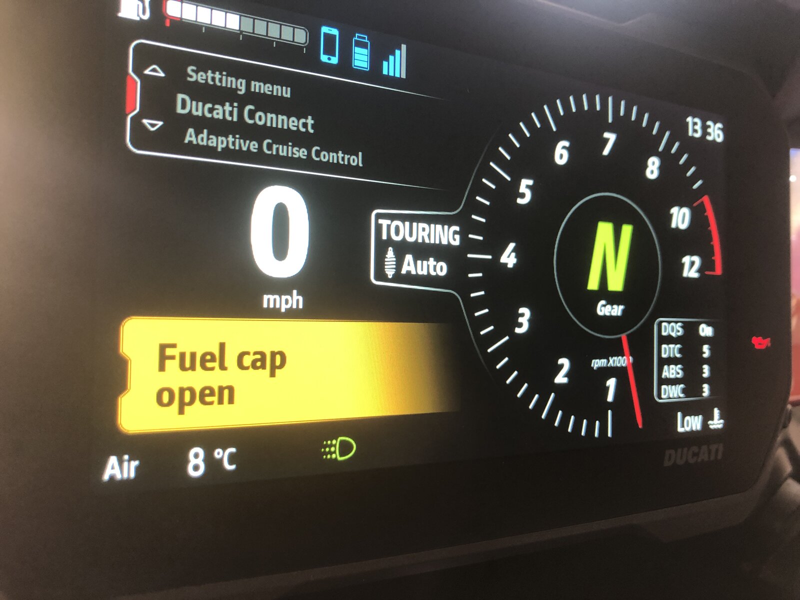

  19. Nice that it shows a message when it’s open. I presume the previous 1260 fuel
    Cap doesn’t work on the V4?
  20. I’m afraid I don’t know. I just bought one for the V4S. It does look very similar to the one sold for the 1200 and 1260, but I’m no expert.
