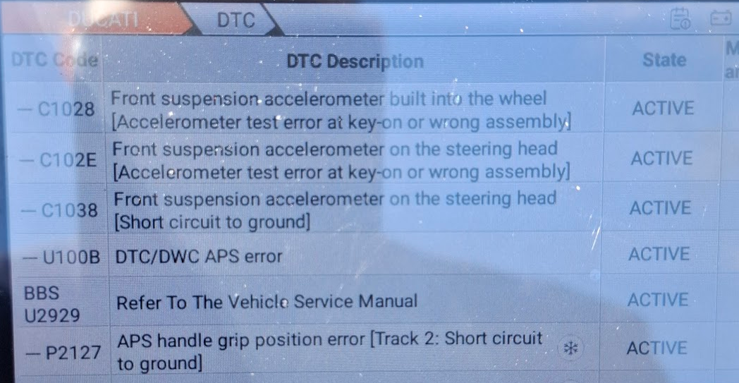

  1. My 2017 Strada T is having some seriously frustrating electronic issues. It went into limp home mode last August and honestly I have not had the will to try and tackle it... until now.
    I have DCT and DWC flashing on the dash as an error, as well as the DSS error (which has been intermittent for some time). so I picked up an obdstar and scanning I get the following
    So I clearly need a new front accelerometer! that is on order, but I dont know what to make of the U100B DTC/DWC error, BBS U2929 error and the P2127 error.

  2. If it was me would replace that part retest and see what codes disappear.
  3. When my rear wheel speed sensor failed there were a host of other, knock-on, errors that were all resolved by replacing the sensor.
  4. thanks, ordered a throttle too and will replace both and retest - will update with more info when that's done
  5. For anyone who comes across this in the future - it was the accelerator position sensor on the throttle; swapped with a used part and all of my errors went. Once I replace the front accelerometer sensor I will be back to a fully running multi :)

  8. It was the throttle grip - the black aluminum part with the wire coming out of it which the twist throttle tube is held in, which is the sensor. Mine ran, but would not rev cleanly. Hope that helps! Good luck
