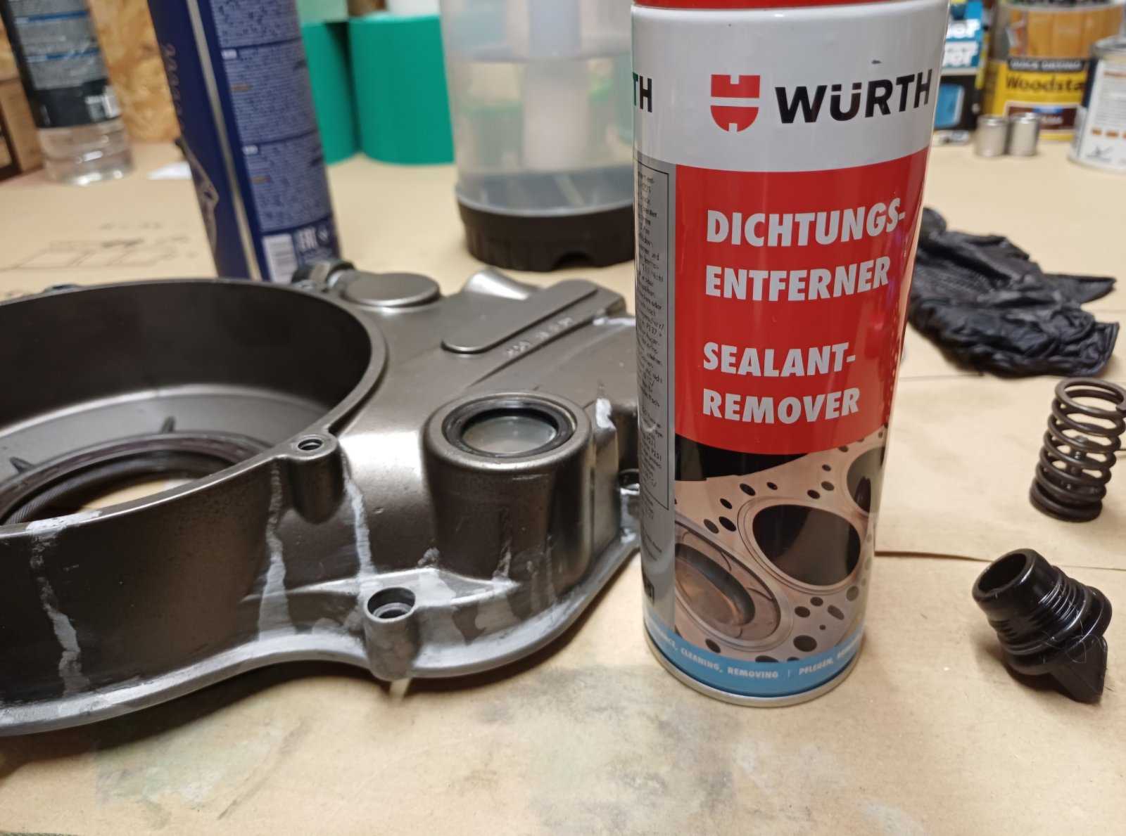

  1. I used Tank Strip paint remover, and then a wire wheel on a bench grinder and it removed it easily with no problems, i have done about 4 cases like this

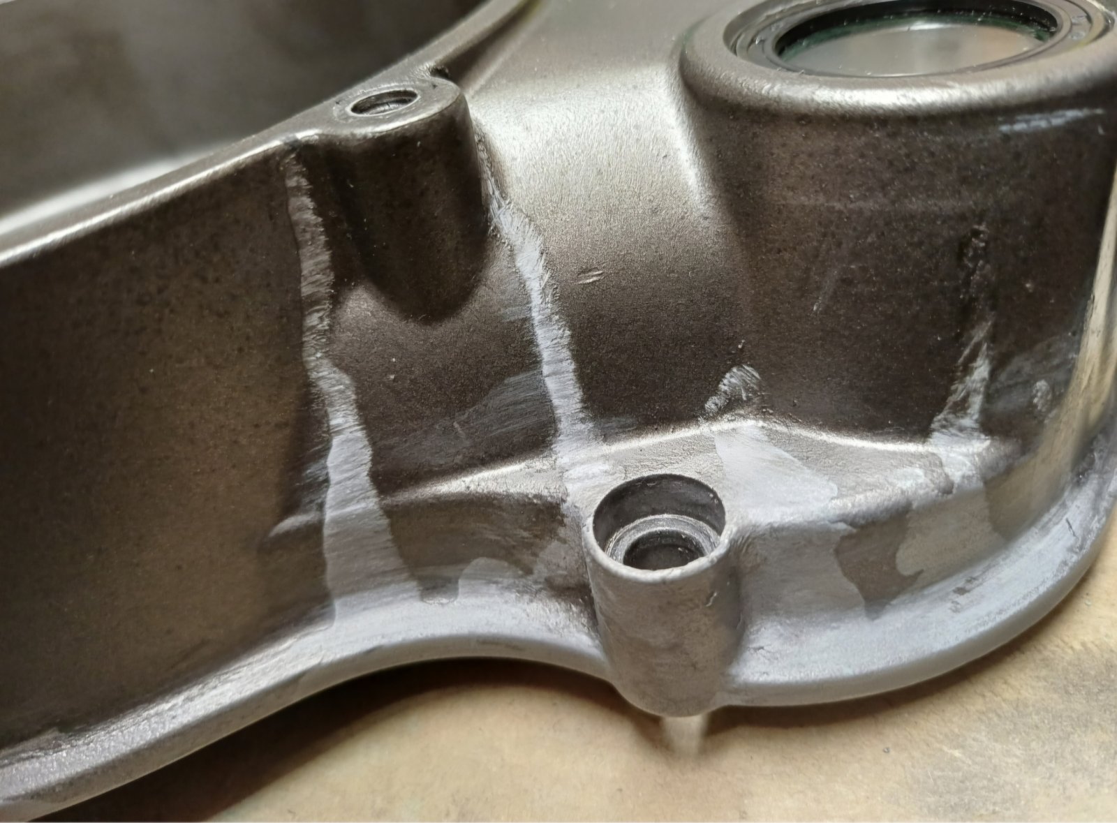

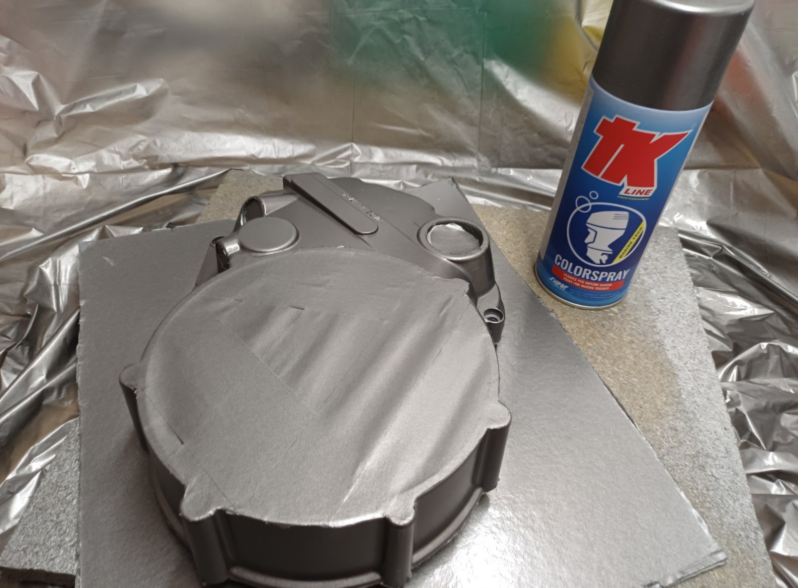

  2. Im using this little hidden gem, also the reason im having to repaint a perfectly good case
    Screenshot_20251125_130633_Gallery.jpg Screenshot_20251125_130633_Gallery.jpg Screenshot_20251125_130629_Gallery.jpg

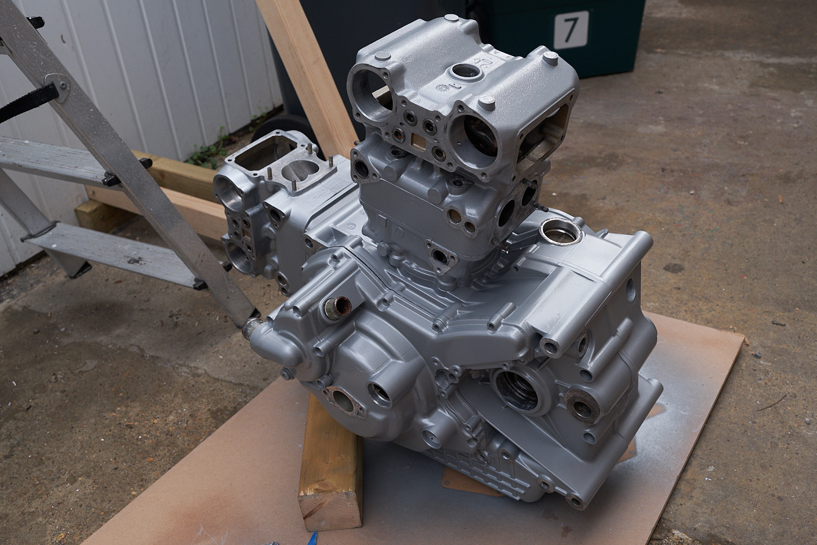

  3. This is mine, still trying to id the paint product :(

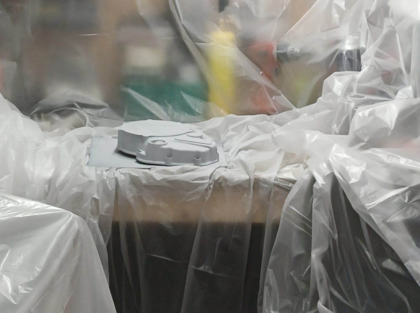

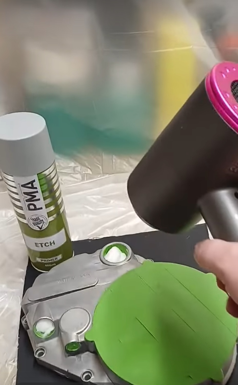

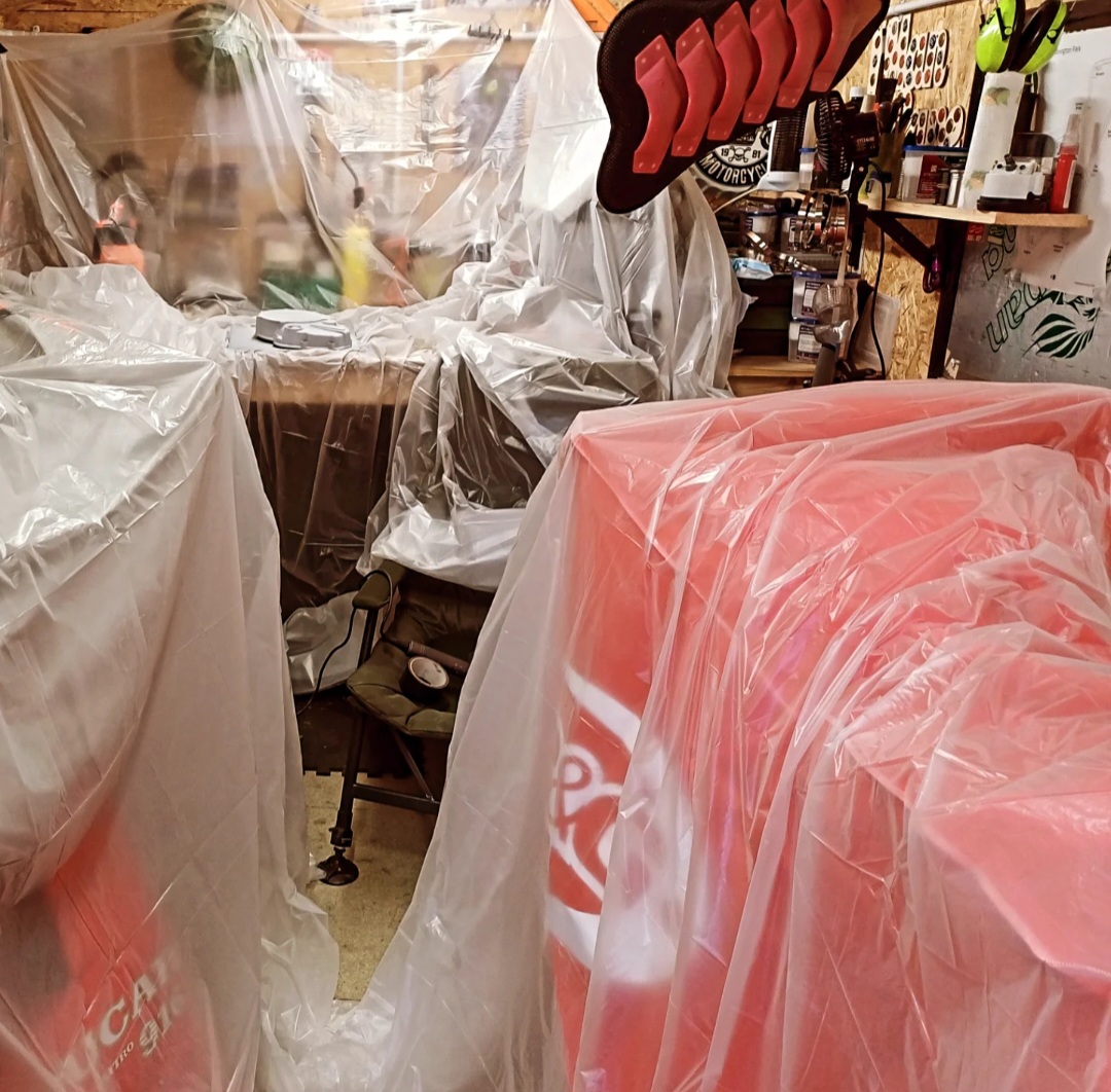

  7. So ordered the main paint from ebay, prepped and sprayed the case with primer today. The bike shed is currently a temporary spray booth
    Screenshot_20251213_184356_Gallery.jpg Screenshot_20251213_143730_YouTube.jpg Screenshot_20251213_184402_Gallery.jpg

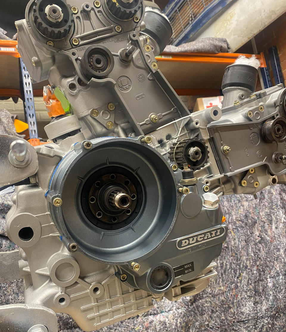

  8. I'm in the process of repainting the engine on my 1994 916 with the green/grey covers.
    I had the guys at my auto paint store scan the cases with the optical scanner and then they made some small adjustments to get a perfect match to what I have.
    They did a match on the grey matt finish on the cam covers etc and a grey/green for the clutch and generator cover.
    Ill get the details off the cans tomorrow and post them up encase anyone needs the colours in the future.
    As for the primer, we used HS Body 961 Etch primer cured for at least 24 hours then the HS360 2k primer to layer up and seal off the chemicals in the etch. Cured for another 24hours then colour and 2k lacquer for chemical protection.

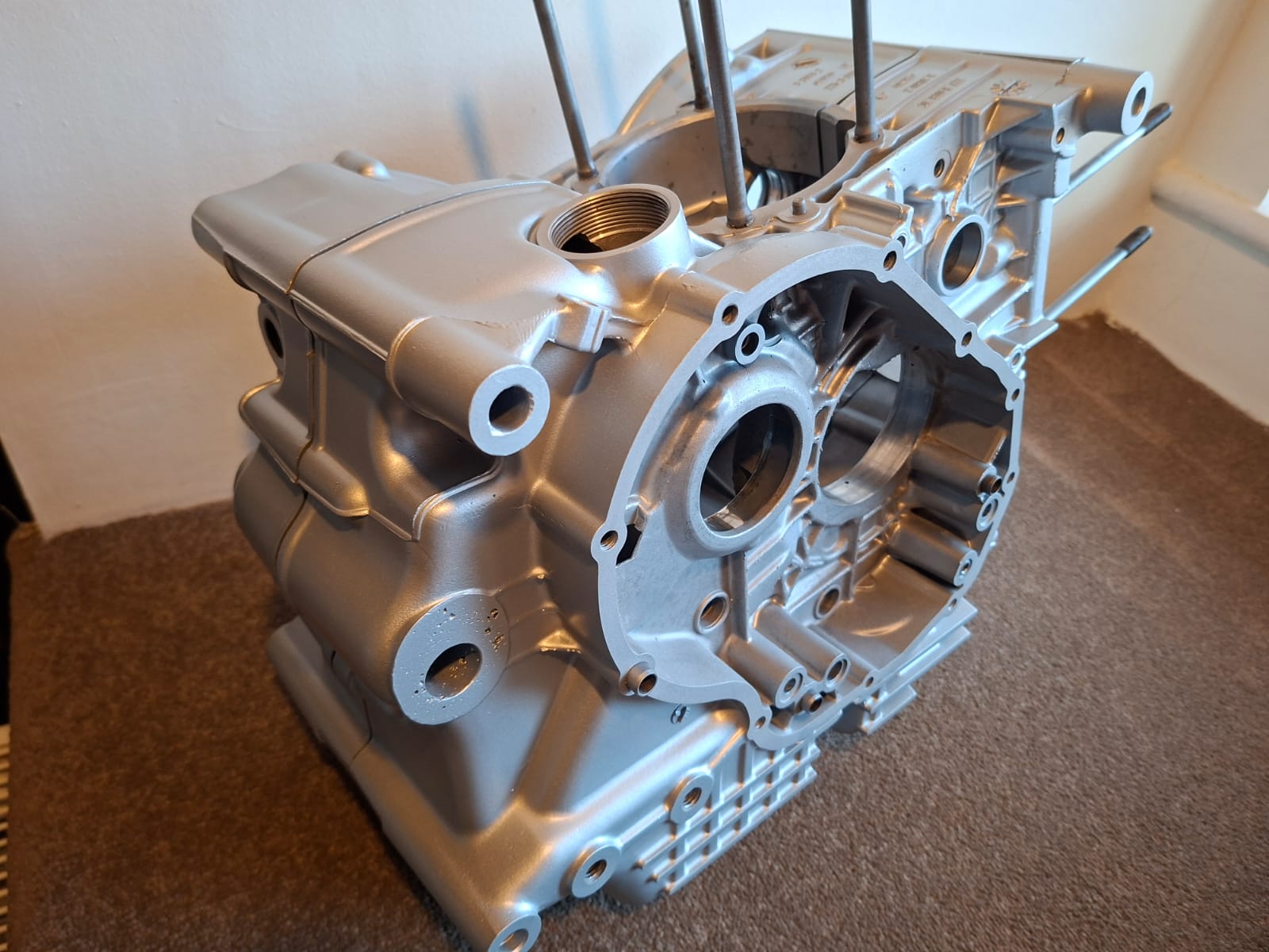

  10. For reference, they came out like this.
