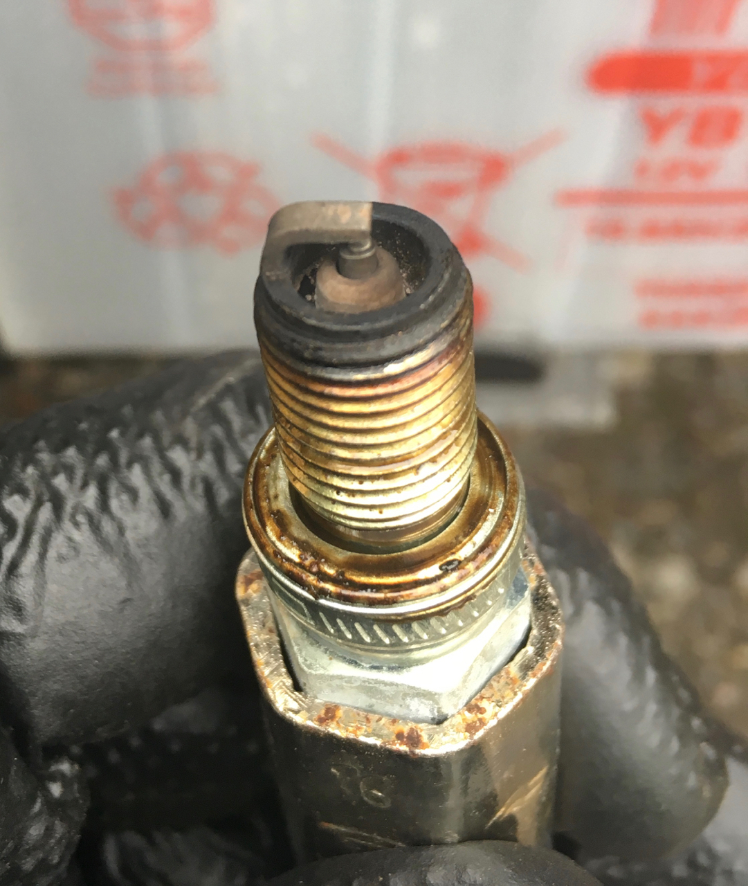

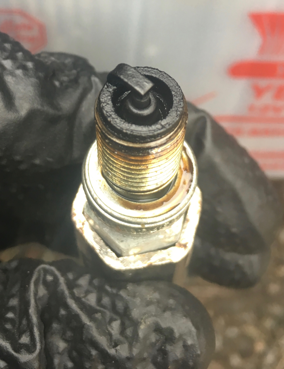

  19. If anyone's still following this thread an update is as below.
    I had an issue with the oil pressure light indicating low pressure, it wasn't low and that issue has now been fixed but took a while for the necessary oil pressure testing eqpt to arrive and then be put into use. Once fixed I went for another ride, now the misfire has moved down the rev range and is no longer limited to the upper rev limits. At times it's as though it's only running on one cylinder, there's some backfiring from the exhaust, which to me indicates unburnt fuel, and then she's fine again. I managed to limp home and thought it's deffo the spark plugs being as old as they are (19 years) even if they haven't done that many sparks (3500 miles).
    So I ordered two new ones - had to wait 2 weeks for them to arrive at the local motor factors :confused:, took out the old ones to see this.
    Horizontal cylinder.
    Vertical Cylinder.
    Which tells me the fuel reaching the vertical cylinder is not being fully burnt off. 'Great' I think, 'it's the spark plugs; this old one is breaking down and not sparking as it should'. New ones get put in, start her up. Same issue. o_O So now I'm thinking I need to trace it back. Could a coil be breaking down? Should I look elsewhere? :thinkingface: I think there are other things I should be checking before attacking the timing sensor on the crank.
    All suggestions gratefully received. :upyeah:
