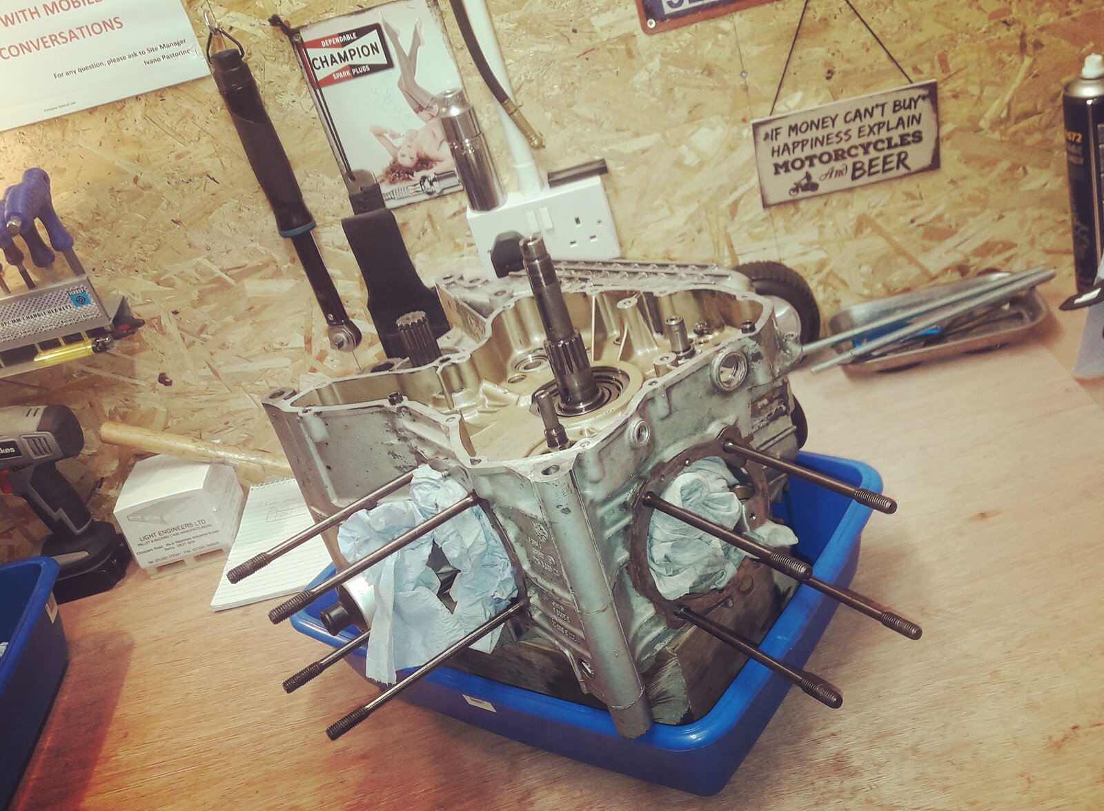

  17. All outer parts removed, the engine is now ready to be split..
    Plan is to clean both sides, remove all bearings and send them off to be coated.
    In the meantime I need to order a full set of bearings, do I have to stay with the ducati brand or can anyone recommend any others I can use? Also are the size of the bearings marked on them so that I know I'm ordering like for like?
    Cheers J
  18. You should be able to download a SKF catalogue online but be careful lots of bearings look similar, if in doubt buy from Ducati unless you can find someone to confirm what you are ordering :upyeah:

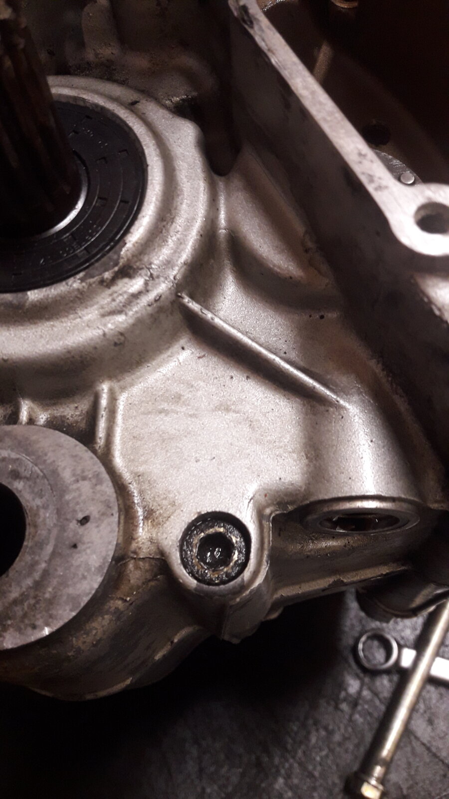

  19. The finish line was in sight today but was abruptly halted due to a rounded Allen bolt..
    I have trieda torx but no luck so back to the drawing board. Any ideas before I attempt to drill it out?
  20. Maybe a bit of polythene wrapped once only around the allen key for a much tighter fit.:thinkingface:
