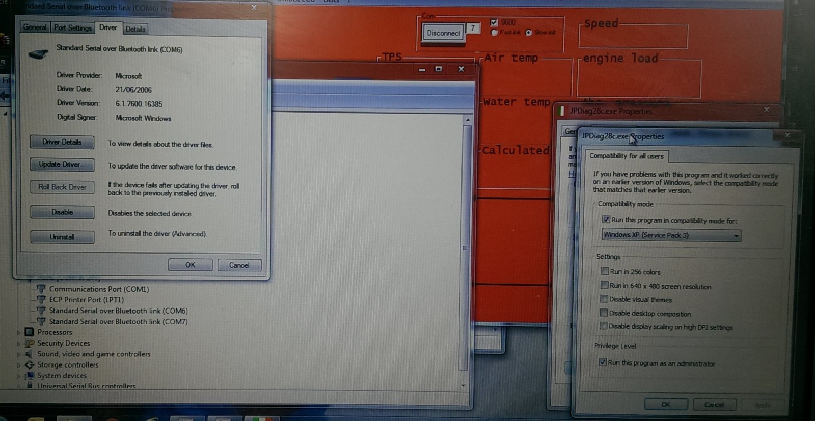

  1. That's what I've been trying. Don't get a green bar.
  2. If I change to com6 it goes green and then drops back to "connect" aging. Com7 hangs.
  3. Elm327, Com6, Tick in box, fast init
    Ignition on, click connect
  4. The above is assuming IAW5AM ECU.
    If a pre-2004 bike then select slow init as the ECU will be an IAW59M
  5. Yeah, it's a MY2003. Tried both settings with no luck.
  6. What OS are you using XP, Win7, Win10?
  7. .
    #28 Cream_Revenge, May 6, 2016
  8. Navigate to the folder for JPDiag. Locate the .exe file (the one with the Italian flag). Right click, properties, compatibility, XP SP3, also check run as admin. Click apply.
  9. With ignition on and com6 it will say disconnect for a few seconds and goes green for 1 second then back to connect again.
  10. Try unticking the box to change the com speed
  11. Should I be able to see a Bluetooth device in Windows or does it just show as a com port?
  12. Still nothing, connects then drop.
  13. Ok, now it connects and goes green for 15 Mississippi's then drops......[emoji35]
