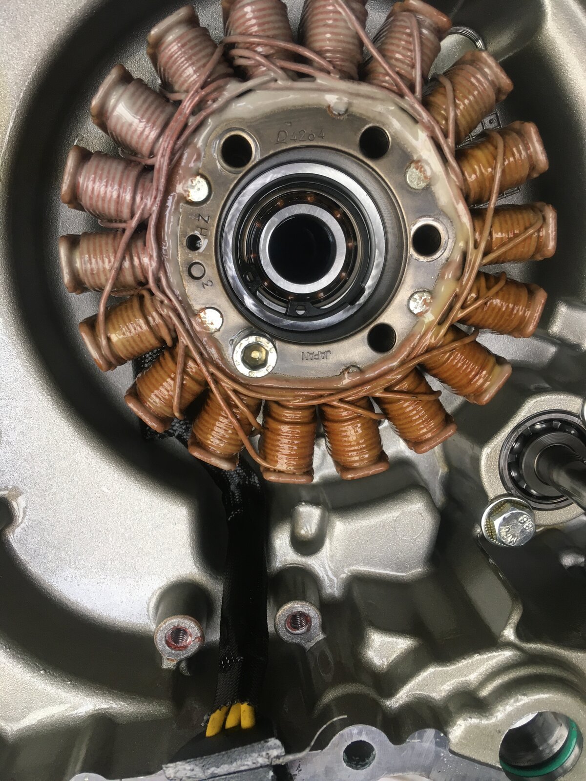

  8. While your talking about stators, i took a picture of mine whilst i was in there last month doing gear shift springs. It doesn’t seem burnt, but different colours. Is it on it’s way or just how they’re manufactured?
  9. In my opinion not a problem. Will always discolour at the bottom as sits in the oil more. My own stator has looked pretty black for several years.
  10. Makes perfect sense. Thankyou :upyeah:
