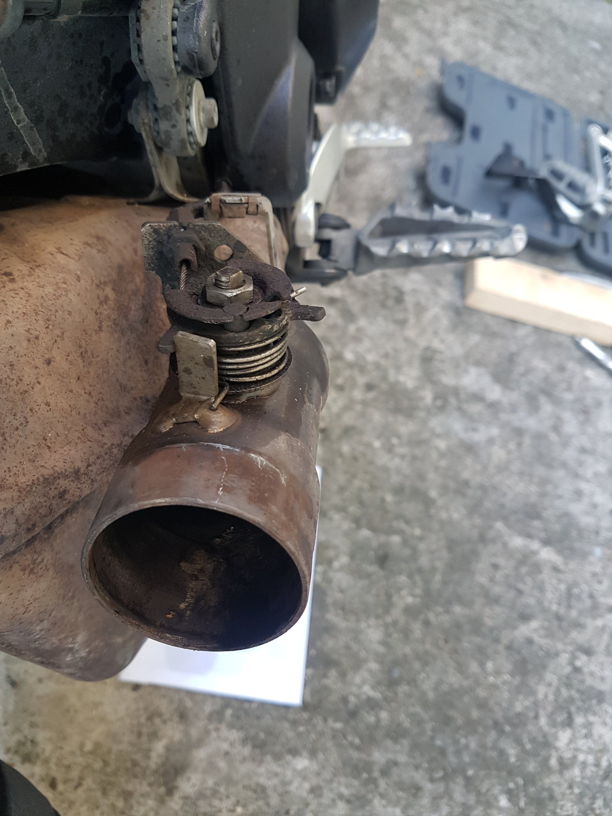

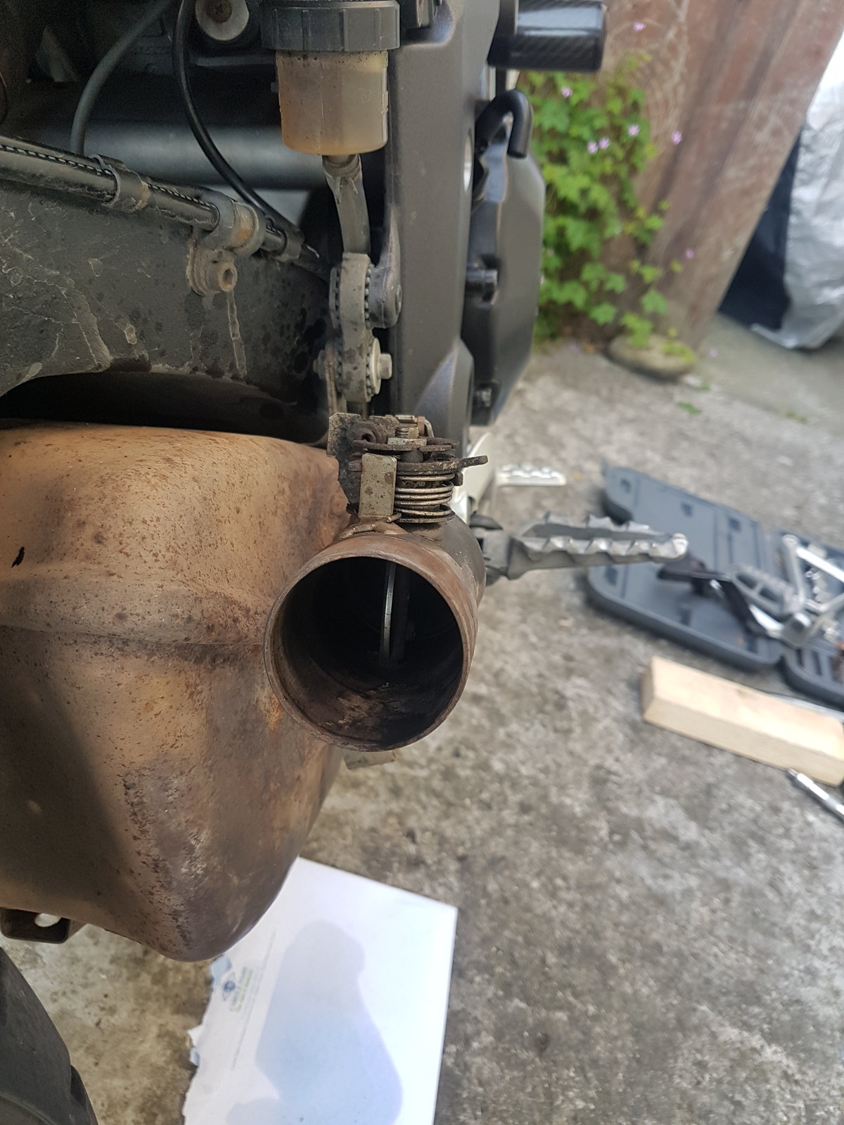

    There's 2 screws holding it on didn't try to remove them just opened the butterfly valve by hand and seems fine
    Have left the plate cover off for the moment so I can spray wd40 up the cable to see if that helps
  5. As been said trillion times lol easy to remove just drill welds off screws remove with pliers then slide butterfly out can always put it back in if needed

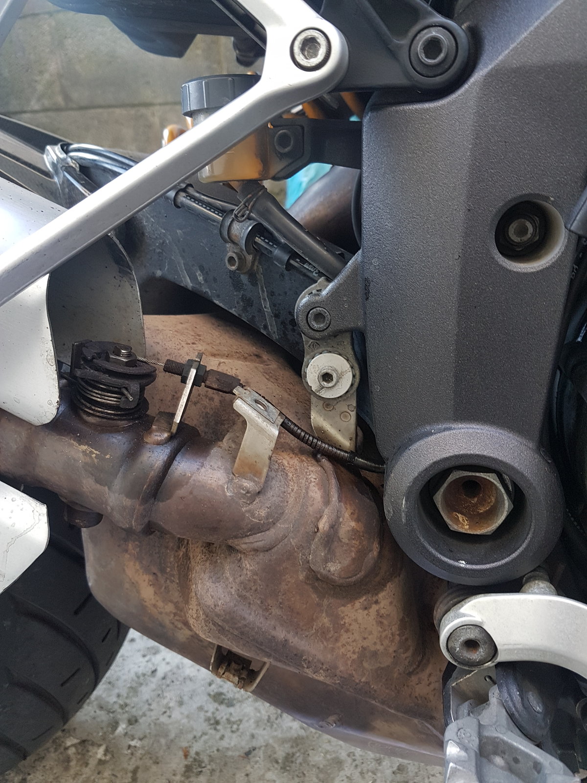

  7. Just take the cable off, add a spring and it’s sorted. I posted a pic a while ago.
