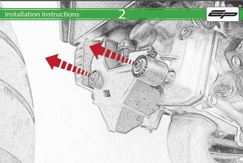

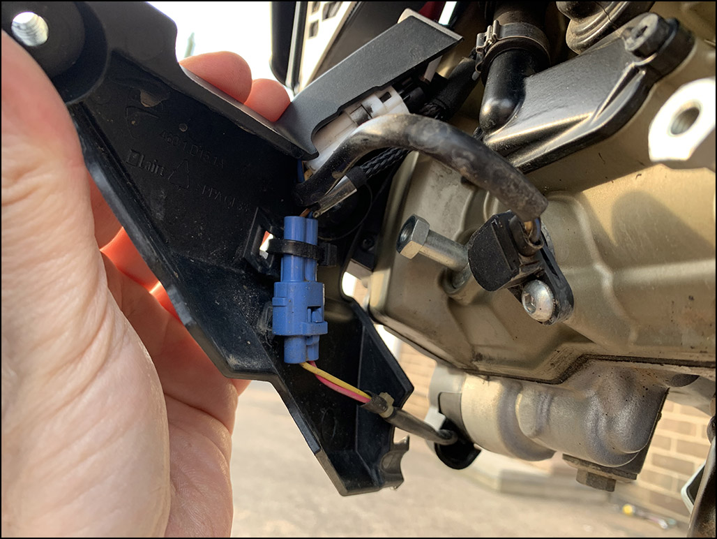

  5. Did anyone else have an issue with oil coming out of the cylinder head when removing the left bolt? 2019-05-18_15-26-59.jpg
  6. Just posted this on the oil top up thread ...
    When you remove that cover the screws should screw out the bolt that goes into the head. If the whole lot starts spinning you need to try and hold the main part. You can see it has a hexagonal on it for a spanner, not sure how easy that is to access with the cover fitted though.
  7. Thanks Rich, that explains it. Is that cover discarded after installing the guard? If it is, maybe I can just cut it to get access to the hexagonal.

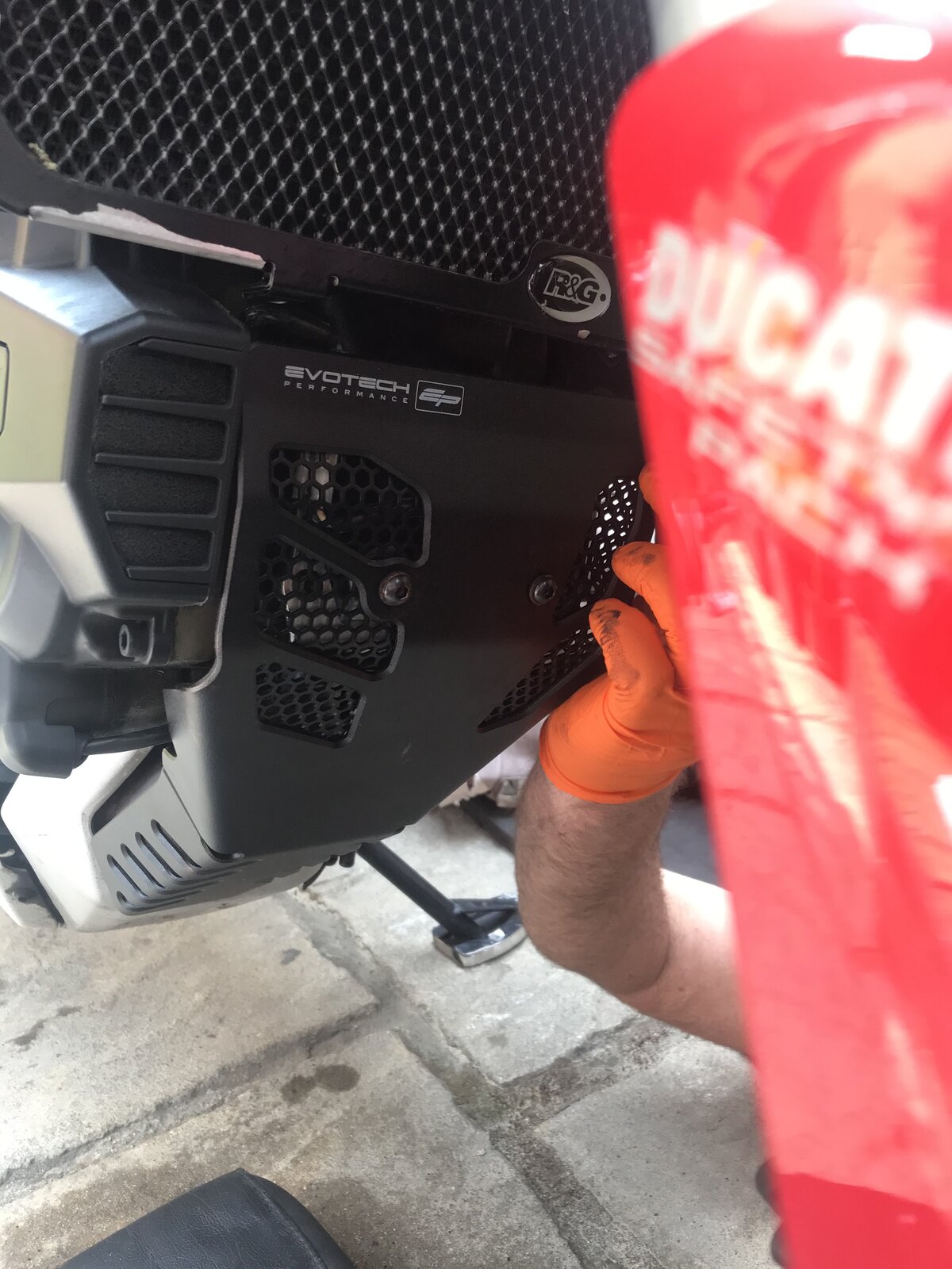

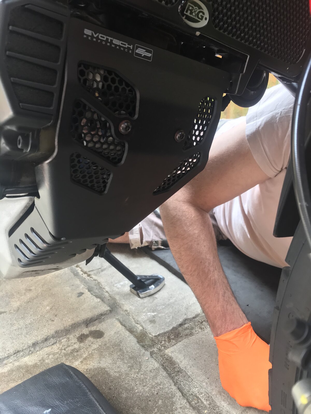

    It ain’t too much of a job ‘Bob’ it took me about 1-2 hours, most of that time was refitting the panels...again and again. They never seem to go back right!
  12. I took mine off my 1200S and fitted straight onto my 1260S (after I had bought the bracket that I'd accidently left on the 1200). Was easy to fit and very straight forward.

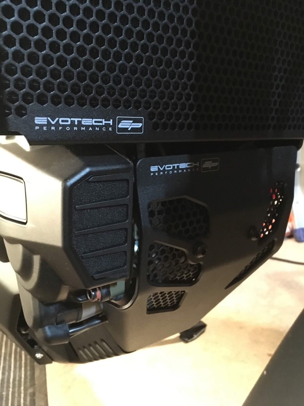

  19. I also got the evotech guard !! Best looking guard on the market for me :upyeah:
    5DE2C786-1B1E-4DF1-8C0E-B8F12065D332.jpeg B96A643C-C939-4BDC-9B02-32CAD34F7F97.jpeg
