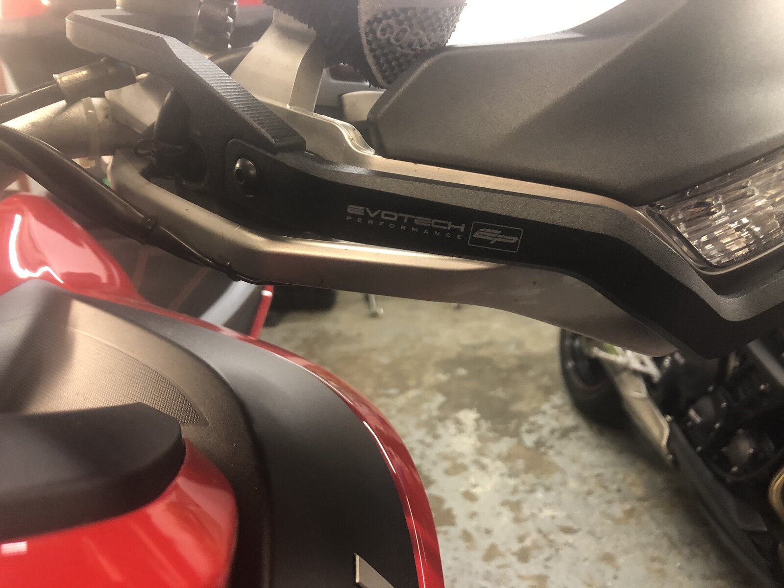

  1. Hi all, has anyone fitted any of these yet, all went well till I tried to re-install the bolt cover caps on the mirror arms, I can not get them back in flush, tried spray grease on them, penetrating oil, still no luck, am I missing an easy way to do this??
  2. I have fitted them also, phoned EP, they stated the caps do not fit back on.... you might be able to cut them down, something I’m considering trying...
  3. That's very atypical of EP... usually their stuff looks a treat. I just put these handguard protectors on the XR and have been impressed by them, was considering the Multi ones too, but that's a poor show! :(
  4. T
    Had been considering these also, presumably the bolts are longer than the originals but the bolt heads must also be taller and / or wider, preventing the rubber caps from fitting, maybe need to get them turned down to match the oem ones :thinkingface:.
  5. I have fitted these, and yes the bolts in the kit are longer and have a bigger larger head that stops the rubber caps from fitting correctly, I tried to find the same bolts as original but longer for the hand guard bracket but failed to locate any. I was lucky I had a work colleague who’s friend had a machine shop and took the heads down for me, and now the caps fit fine again
  6. :thinkingface: Pretty poor design all-round don't you think. Bearing in mind the high likelihood of the bike owner wanting their bike to be otherwise unimpaired as a result of this modification, Evotech ought to have ensured the right bolt fitment was provided to enable these caps to go straight back into place. Or provide alternatives to fit in order to match their bolt set-up.
    Perhaps as 7ony above has suggested, trimming the caps down a little might do the trick ;)
    They look decent enough, but don't look as if they actually will protect the fragile indicator plastics that much, in the event you have an 'incident'!
    Hopefully you won't ever need to check this out.
    Safe riding and good luck with fitting the OEM caps.:upyeah:
  7. BUT, I have to say they are nicer looking than Barkbusters
    • Agree Agree x 4
  8. Just been back to finish it off, I have ended up trimming the rubber back until I could get them in flush, slightly proud at the small opening where you prise them out, took them back out, a blob of silicone on the bolt heads, refitted, looks ok now, the reason I took the option to trim them, was the fact you can buy new rubber caps from Ducati, £3.48 for the pair.
    A cheaper option than having the bolt heads machined, a poor show though from Evotech for not supplying the correct bolts, and knowing that they are wrong.
