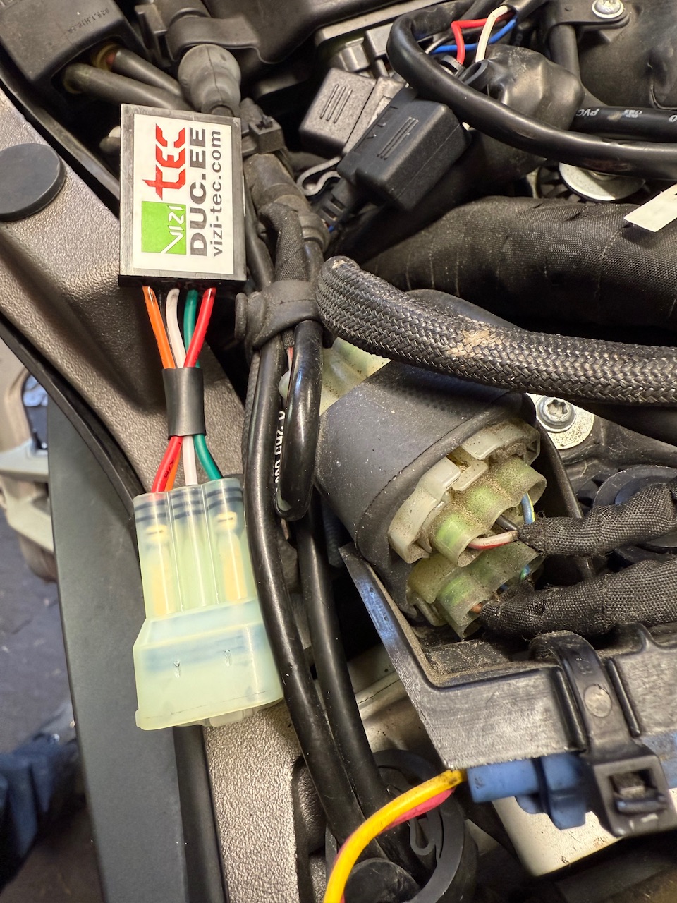

  2. Assuming you’ve been told the truth and there is an ESE (exhaust servo eliminator) fitted, its a small rectangular device, much smaller than a matchbox (for those that remember them) and it will be on the right hand side of the bike, under the seat, just behind where the rear subframe attaches to the main frame. There are 2 big white plugs there, tucked tightly down the side. One of them will be disconnected and the device plugged into it. When I’m in the workshop in the morning I’ll take some photos as I have a 1260 Enduro with me at present.

  9. The device looks like this, whether it’s the Duc-EE or Healtech versions, and plugs into the loom side of the lower of the 2 white plugs in the photo.

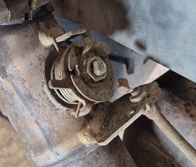

  14. What is the best way of keeping the valve open? Do you manually disconnect the cable from the flap?
  15. The spring (see the pic in the OPs first post) holds the flap open and the servo works against that spring. So, in theory, once the servo is disconnected, or the Bowden cable is disconnected from the spool, the valve should be in the open position. However, they do have a tendency to seize and if this is the case it maybe closed or partially closed. You can move it back to open and disconnect or, as I did, wire the valve in the open position.
    Just disconnecting the servo from the valve, either by unplugging it or unhooking the Bowden cable, will work but throw an error on the dash and log that in memory. The ESE module just fools the bike's electronics into thinking all is well with the flap system and it's working as designed.
    You can just unhook the Bowden cable from the spool and twist a suitably sized spring onto the bare end of the cable and that will provide enough resistance to fool the system into thinking that the flap, and it's return spring, is still connected.

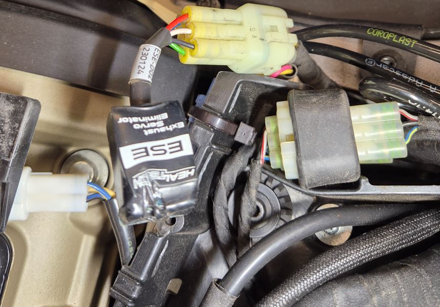

  16. I've had a look.
    The motor appears to be still in place and there is a Healtech unit fitted.
    It's marked ESE D02 230124 on the cable.
    But it looks like it's been crushed by something as well as melted.
    I'm assuming it's a solid block of potting around the components:
    It's not been plugged in at the two white connectors, but you can see where the plug for it has been disconnected further down:
    When I get more time I'll investigate a bit further and see if I can connect the drive motor back up along with the other end of the cable.
    The Healtech looks Knackered.

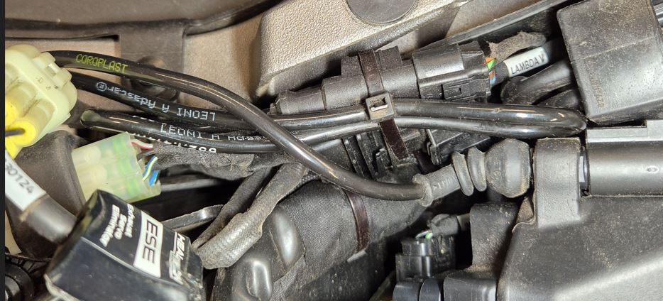

    Does anyone know what this wiring is with COROPLAST and LEONI on it?
    That's probably the cable manufacturer I realise, but it's the best way to identify it:
    It looks like it's been added, and is coiled up.
    The bike has no additional lights or anything.

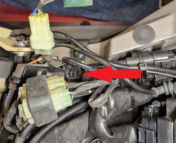

  17. Maybe you're somewhat particular like me :D If it's still working, servo /flap not operating and no error on the dash yours is probably fine. If fitted further down the cable then possibly has come into contact with the exhaust, hence the melting.
    Will send you details, let me known if you want to proceed.
    That doesn't look like any wiring under my seat, the cable tie around those other connectors looks like and afterthought too. Maybe try and trace to see where they go. Possibly an alarm or tracker?
  18. I’d say that ESE has seen better days, if it’s like that outside it’s probably like that inside and could be sending diff signals to your ECU hence the issues you experience at 4000rpm just as the ECU is instructing the valve to close.
    The cable with Coroplast on it looks suspiciously like the rear wheel sensor cable.
    I’ll check the Leoni ones tomorrow.
  19. Does one of the cables run the lambda v connector?
    A lot of the cables now have I’d tags that may help?

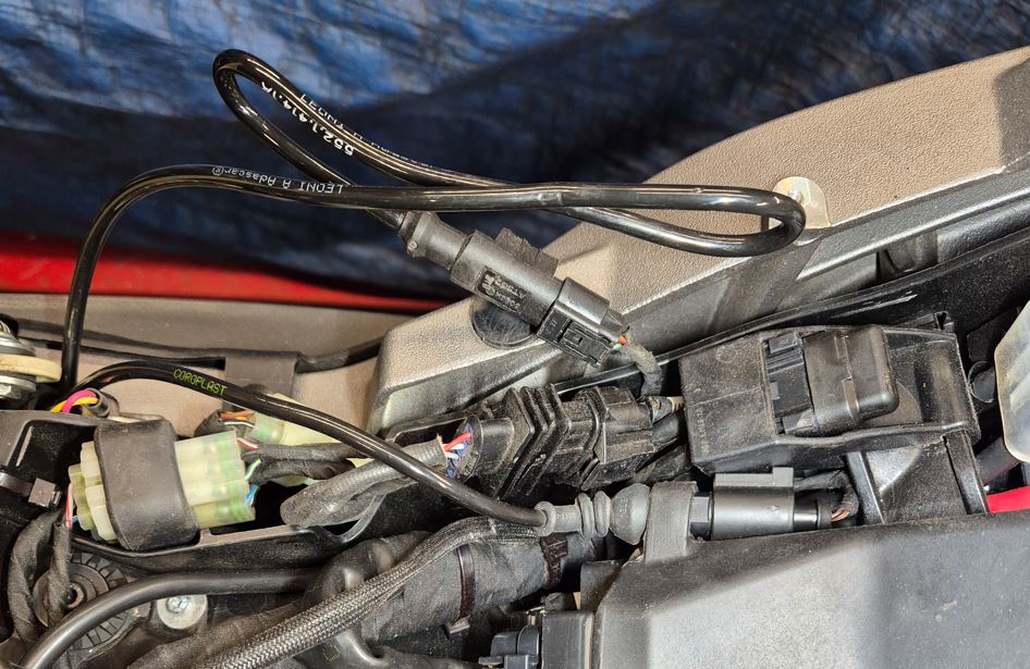

  20. I've had another look.
    The COROPLAST I believe goes to the rear shock.
    The Leoni is the rear wheel speed sensor, but there is loads of it, and the way it's been cable tied up doesn't look standard.
    I'm wondering if it's an aftermarket one.
