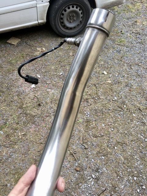

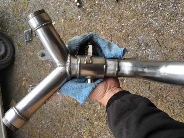

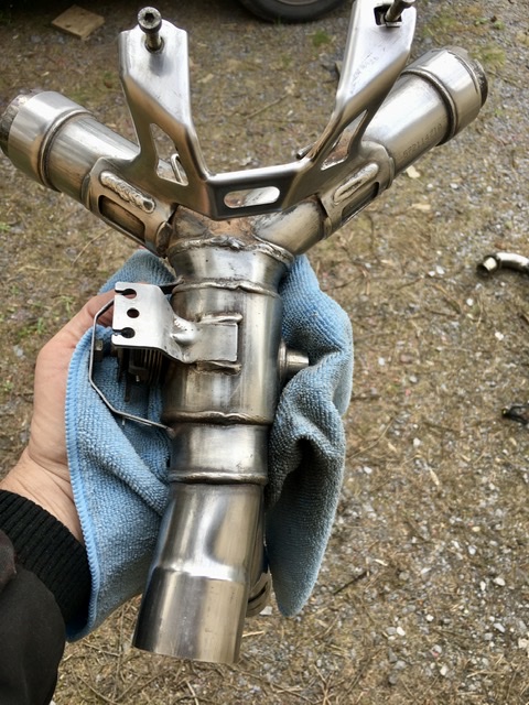

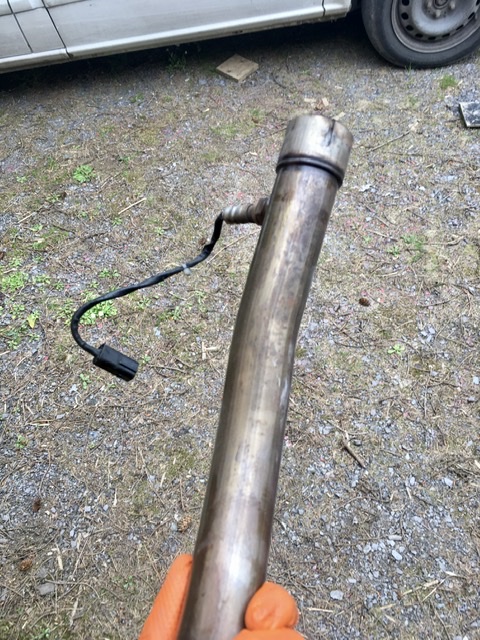

  1. Before I started (left bit of Y pipe& after, right pipe) using dremmel & autosol after a few hours.

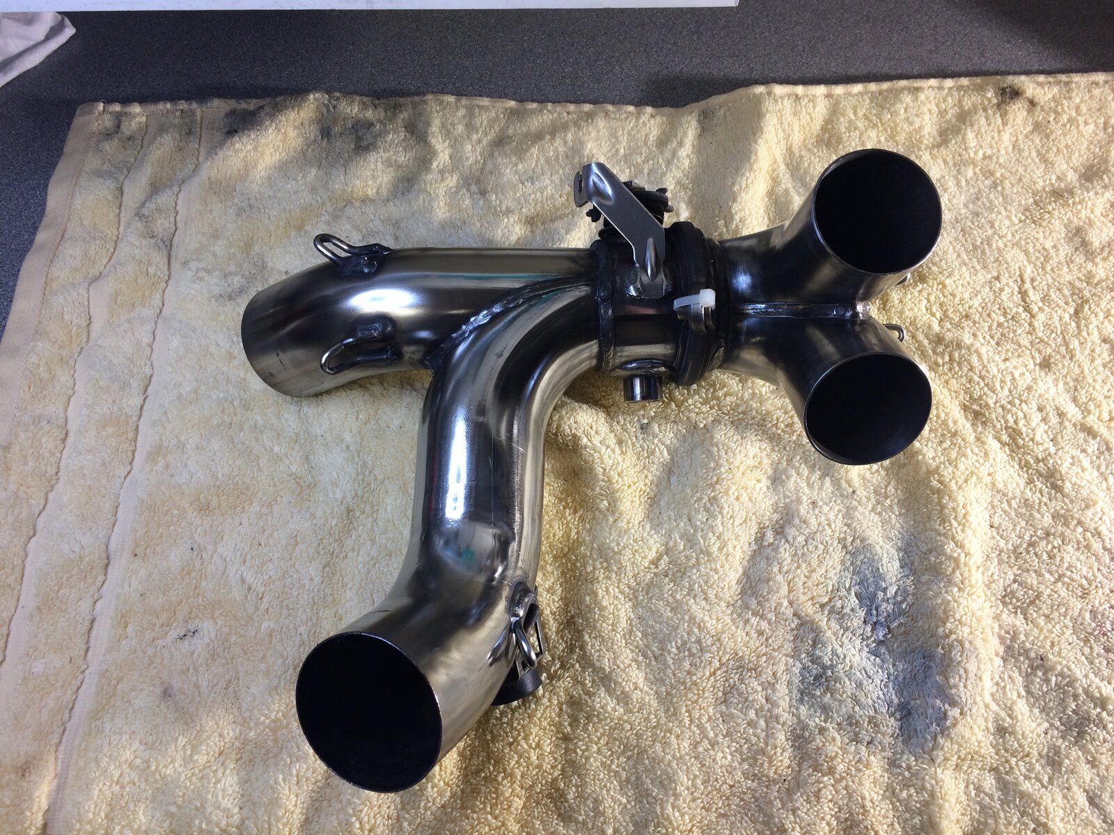

  2. Finished result
  3. That looks decent! :upyeah:
  4. If I had kept my SS, I would have had the headers soda blasted or similar then had them nickel plated and polished.
    The specialist I spoke to about them reckoned £100 would do the lot.

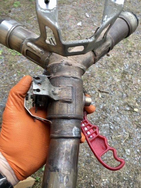

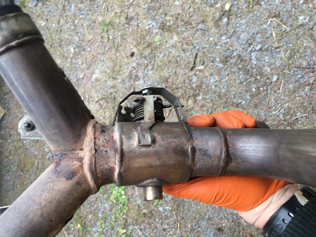

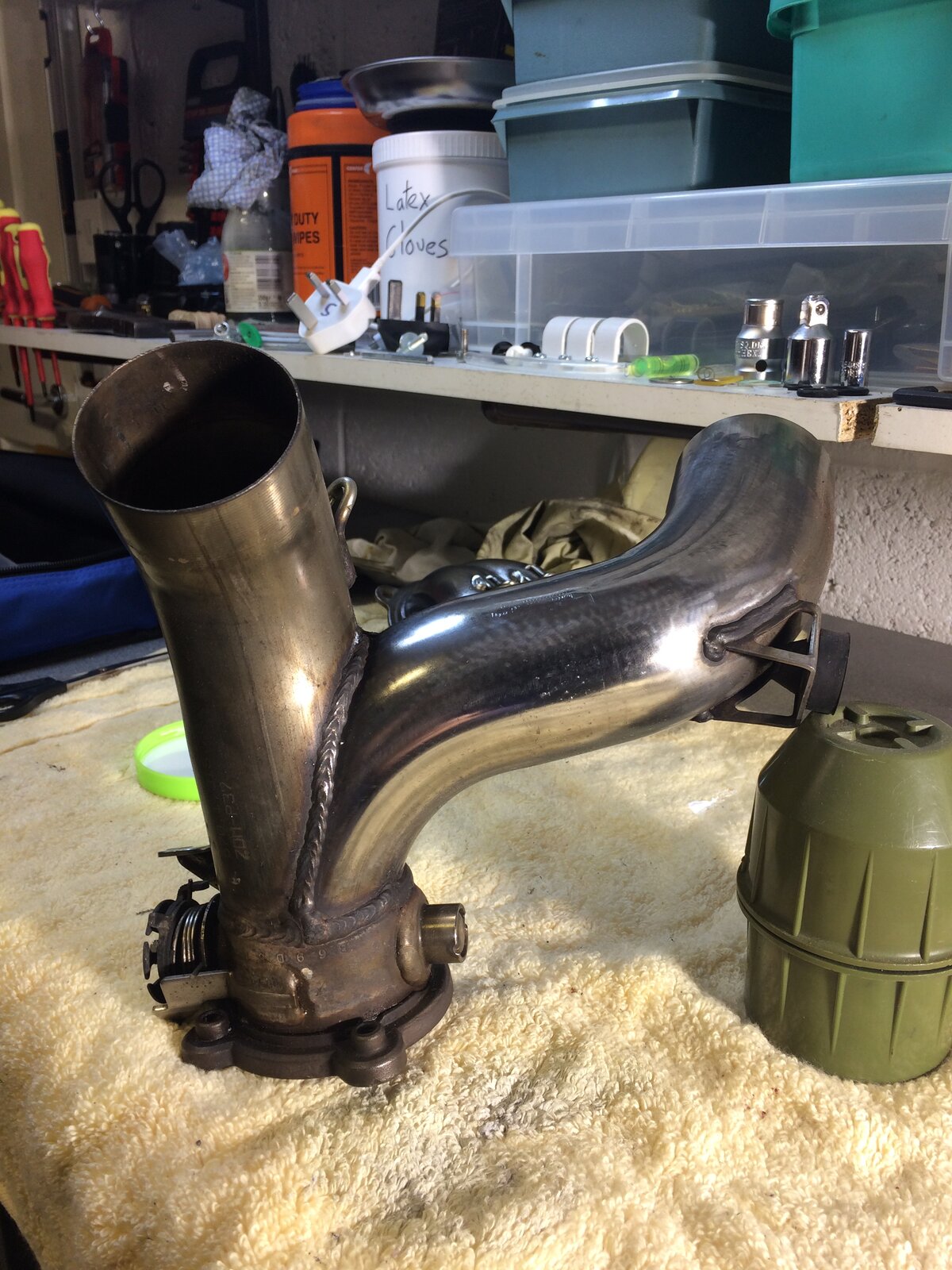

  5. Harpic10x + nylon scourer, rinse, repeat, 400grit wet & dry, rinse, dry, Autosol.
