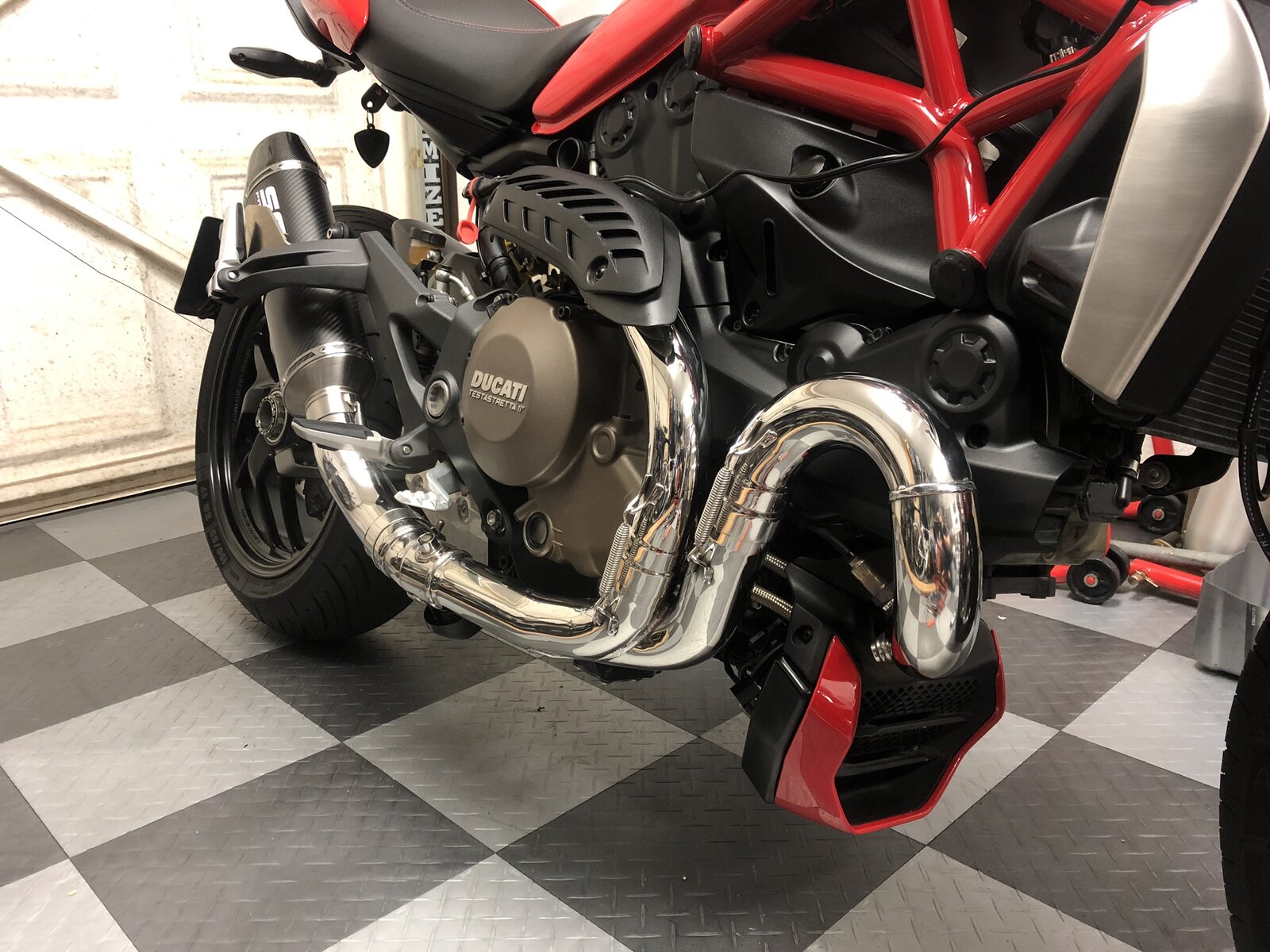

  5. I did B and it cost me £30 for my Diavel Termis. Once they are polished you will need to keep it up though as they discolour quickly. If I was to do it again I'd probably consider ceramic coating.
    Stuart

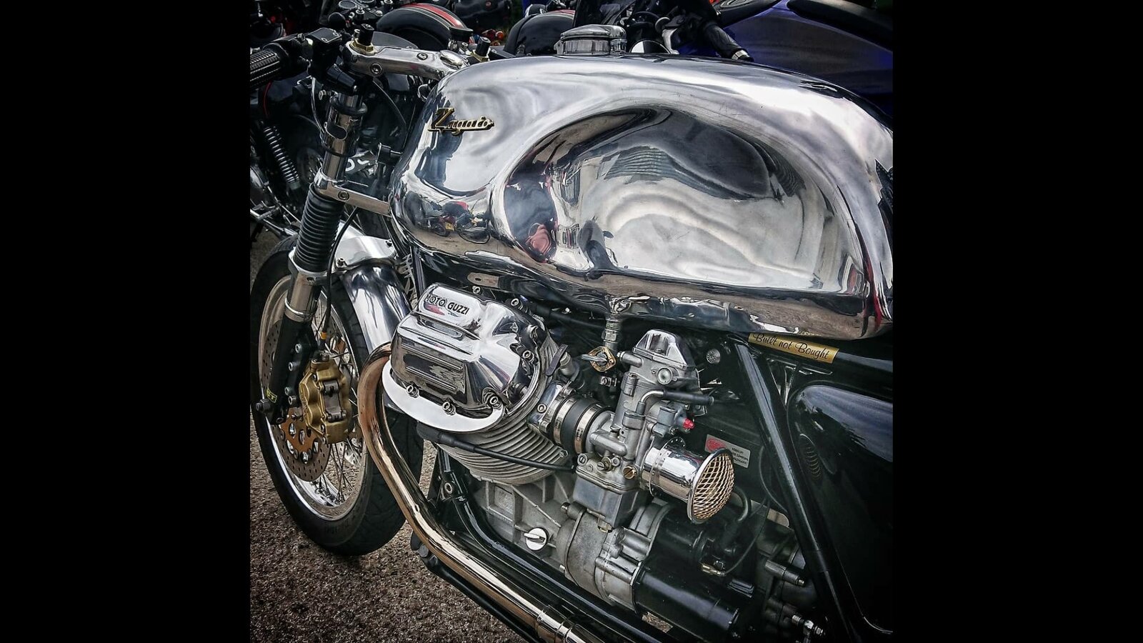

  7. Blinkin eck, i could build a 3 bedroom house on those chicken strips :D

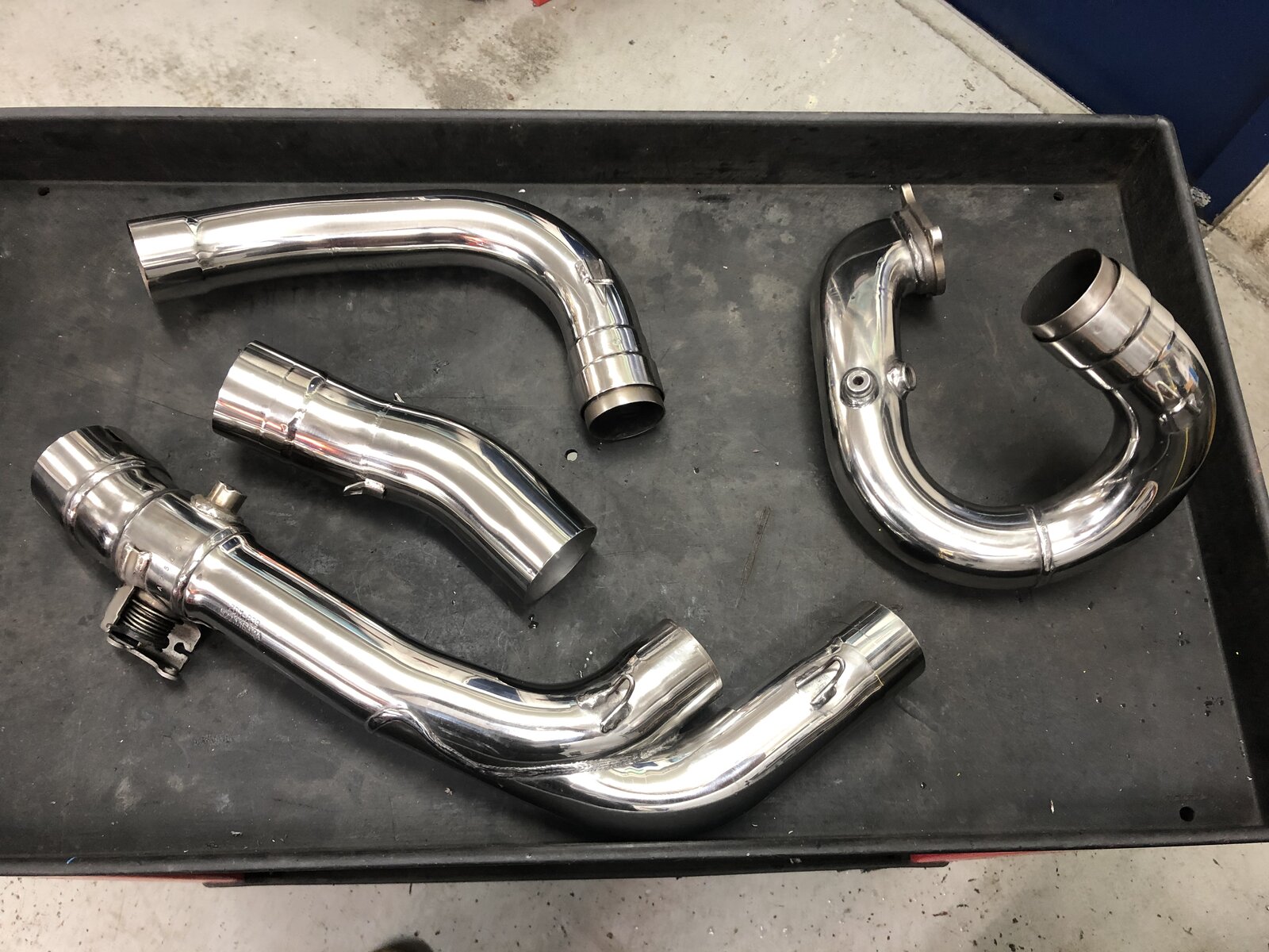

  8. Buffing wheel using diferent grade polishing soap, not expensive but good results. This took a while to do.

  12. Just started doing mine, 600-3000 grit pads then I need to finish the on the wheel. They have come up well but have taken 4 hours or so! Should be a lot easier to keep this way now.

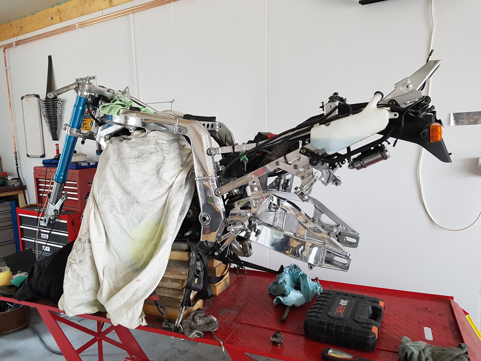

  14. Here it is all back together. Think it was worth the work
    • Like Like x 13

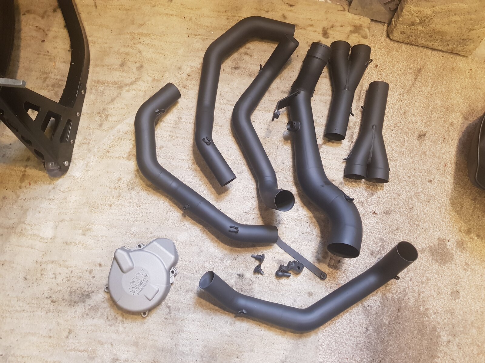

  17. Started polishing my pipes on my Z1000 but in the end went for cerakote... Even after caked on salt and what not from the road... 2 minute wipe makes them come up as new...did the hyper as well.
  18. Did you spray them yourself (air dry)?
    • Dislike Dislike x 1
  19. Nope - had a pro do it. one of those things you need to get right first time...
  20. I am more interested in those forks, they look really good. Did you have them anodised or are they new?
