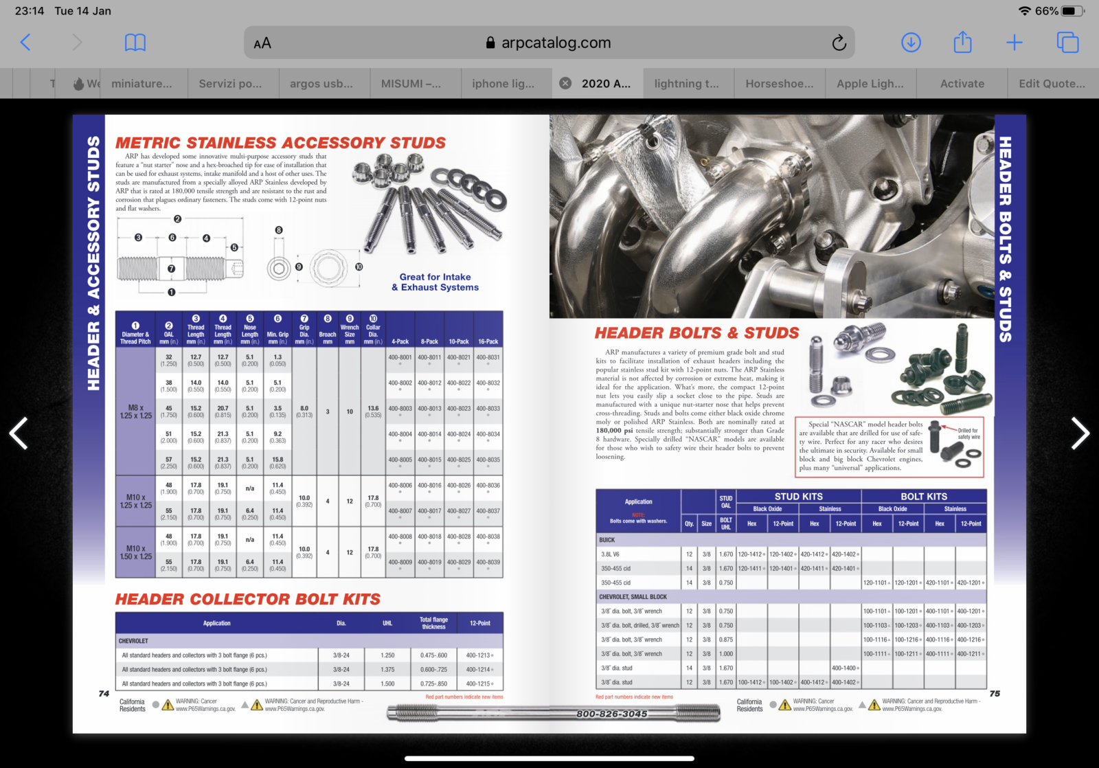

  18. Used ARP fasteners for other things. Presently making a set of stainless nuts for the heads on my monster from stainless bolts with a 14mm flanged bi hex head as per original but without the crap plating. Basically cut head off and tap. Not cheap for the bolts though.
    Anyway they do stainless exhaust studs with nuts. They have a very extensive catalogue.
    https://arpcatalog.com/76/
    • Useful Useful x 2
  19. @Geoffduk, thank you, the web site made interesting reading and has given me food for thought. Andy
