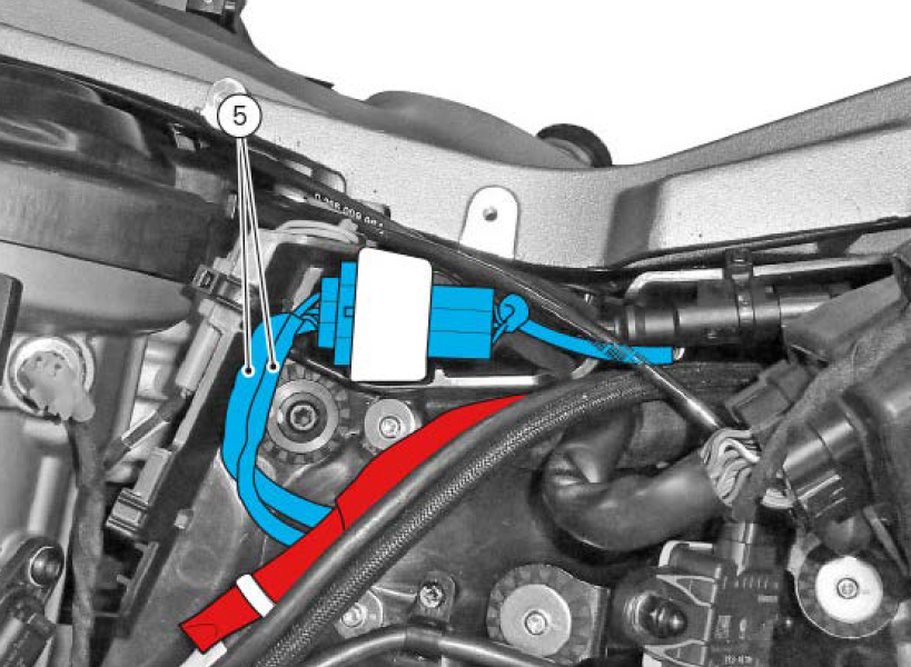

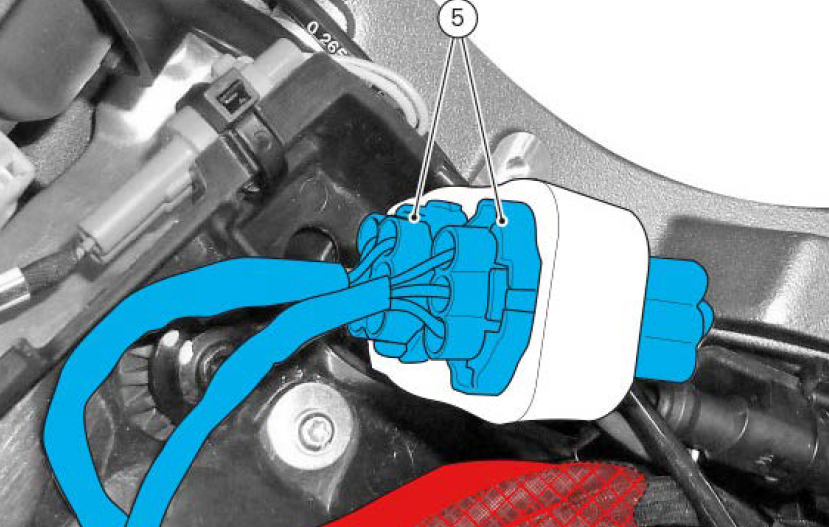

  14. Not sure I did because the two plugs are different that are located one above the other on the right hand side. See the page from the manual.
  15. I only say that because I definitely DID plug it into the wrong one on my first attempt and it produced the exact error you described. Access to the correct plug is super fiddly, so if you didn't need to resort to some kind of assistance then you're in the wrong one.
