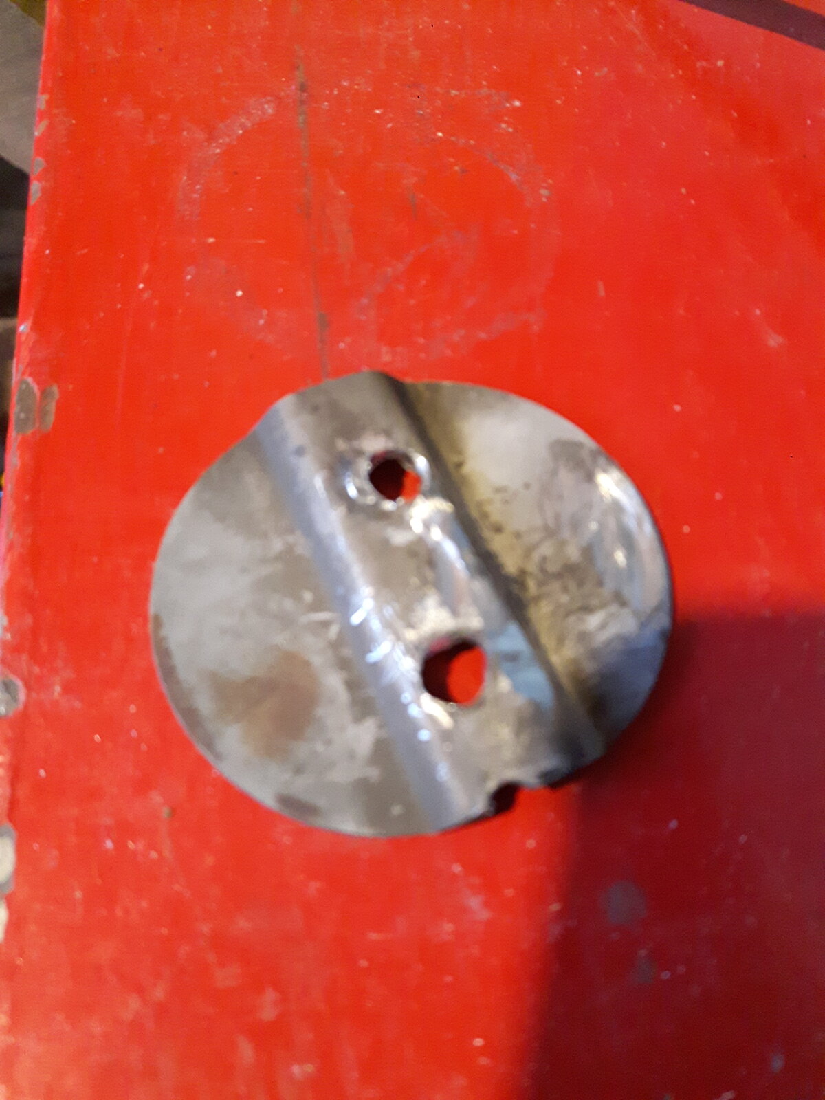

    The Monster's ECU has been flashed by Rexxer to disable both the servo and the CE. In fact, I actually removed the flap with a dremel and a drill.

  18. I had the servo exhaust valve disabled with a Rexxer flash. Notwithstanding, and this may be or may not be relevant.
    I physically removed the flap (just before Christmas). Prior to its removal, I felt the pulsation of each cylinder at idle from a sightly different angle (hand behind the exhaust).
    In other words, the gases of each cylinder flow out of the silencer at different angles perhaps as a result of the flap acting as a wing causing turbulence.
    I have not noticed this pulsation once the flap removed. Quite noticeably smoother actually.
    I have not had an opportunity to ride the bike since I removed the valve flap and will only ride once the snow is gone. Therefore YMMV.
