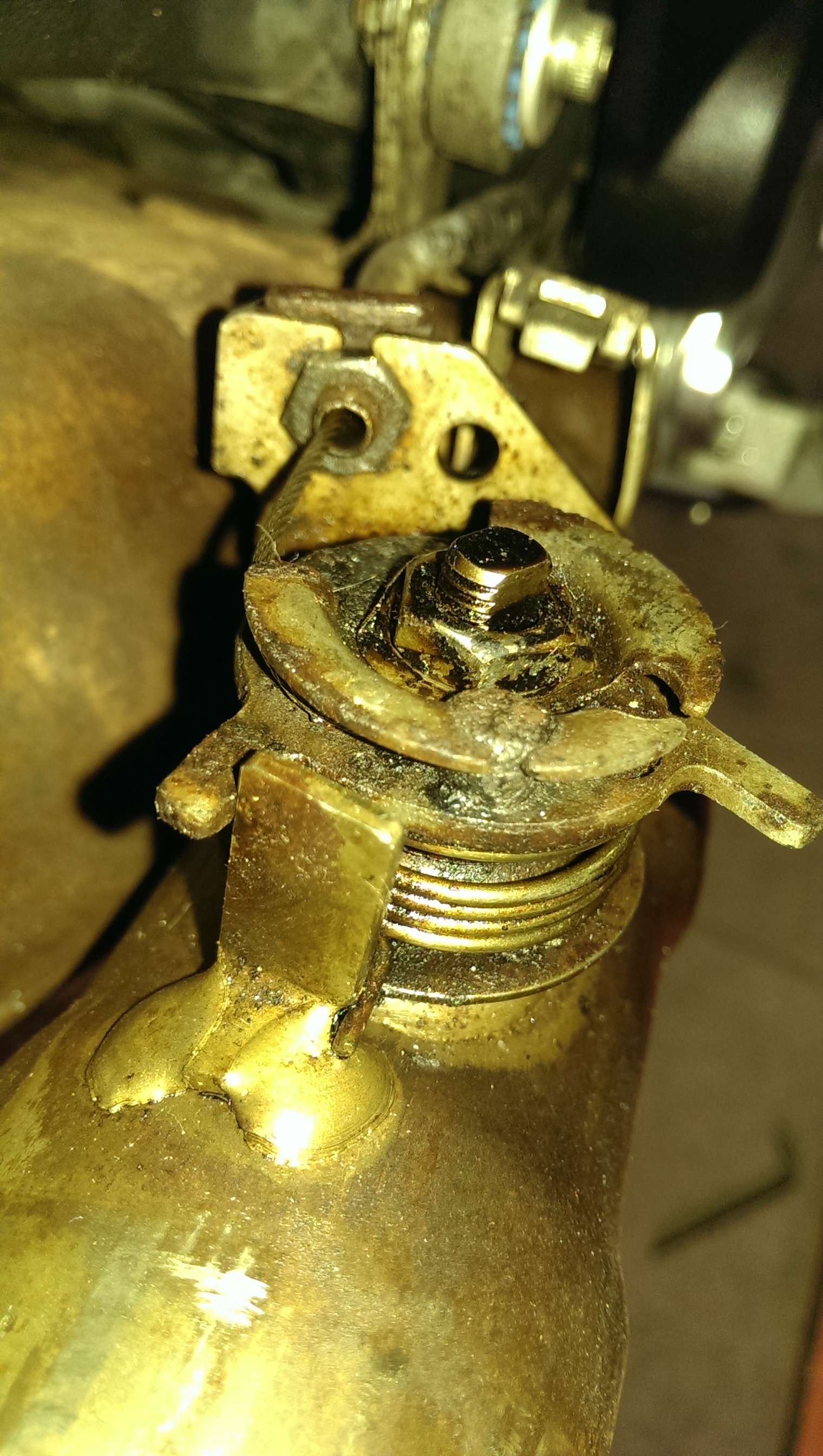

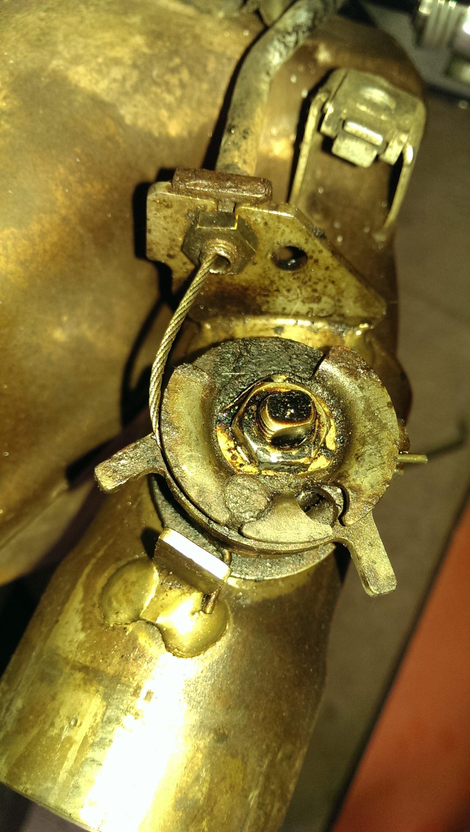

  14. Guys.....
    Had trouble with mine after just a couple of months took it in dealer they said would try to free it up ...by the time I got back home it was playing up again ...on the phone again and pics were sent... IMAG2194.jpg IMAG2194.jpg IMAG2200.jpg
    Bad hey? the nipple had rusted solid what a state after a couple of months.

  19. Just checked mine today after bike hesitated quite an it the other day and was suggested on here to check the valve, well I have and mine is quite rusty very similar to above pics. Wd40 and stiff brush and got it a bit better and freer and put some grease on it so will see how it goes. Did you get yours replaced under warranty?
