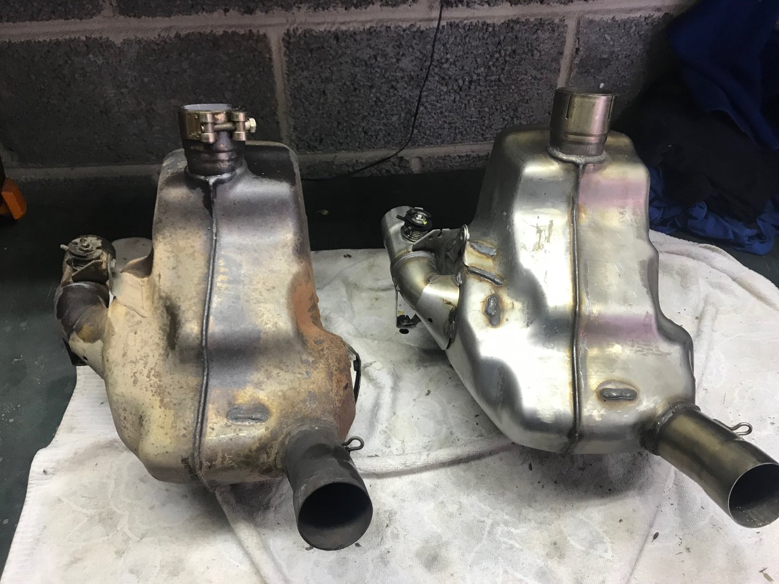

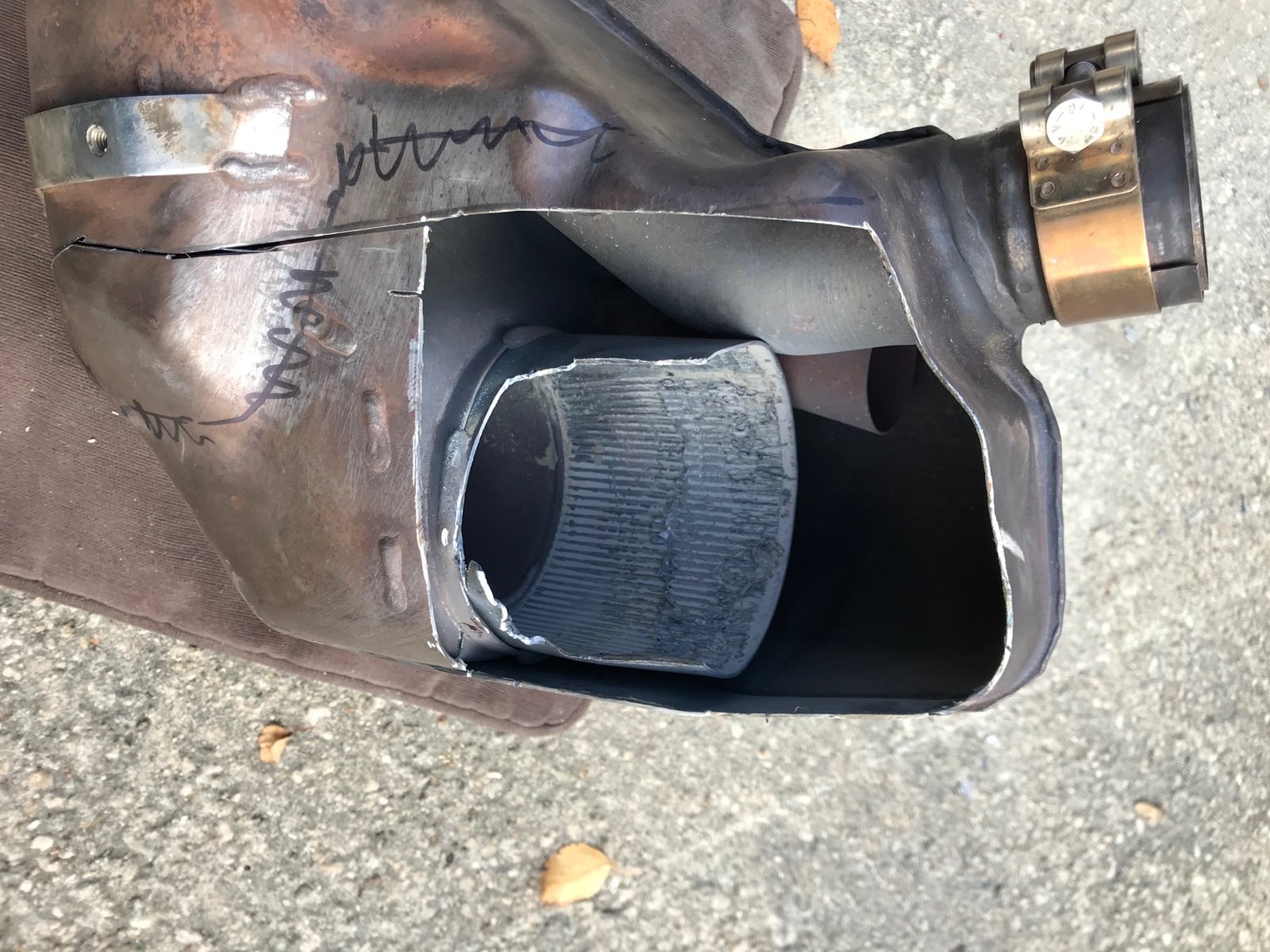

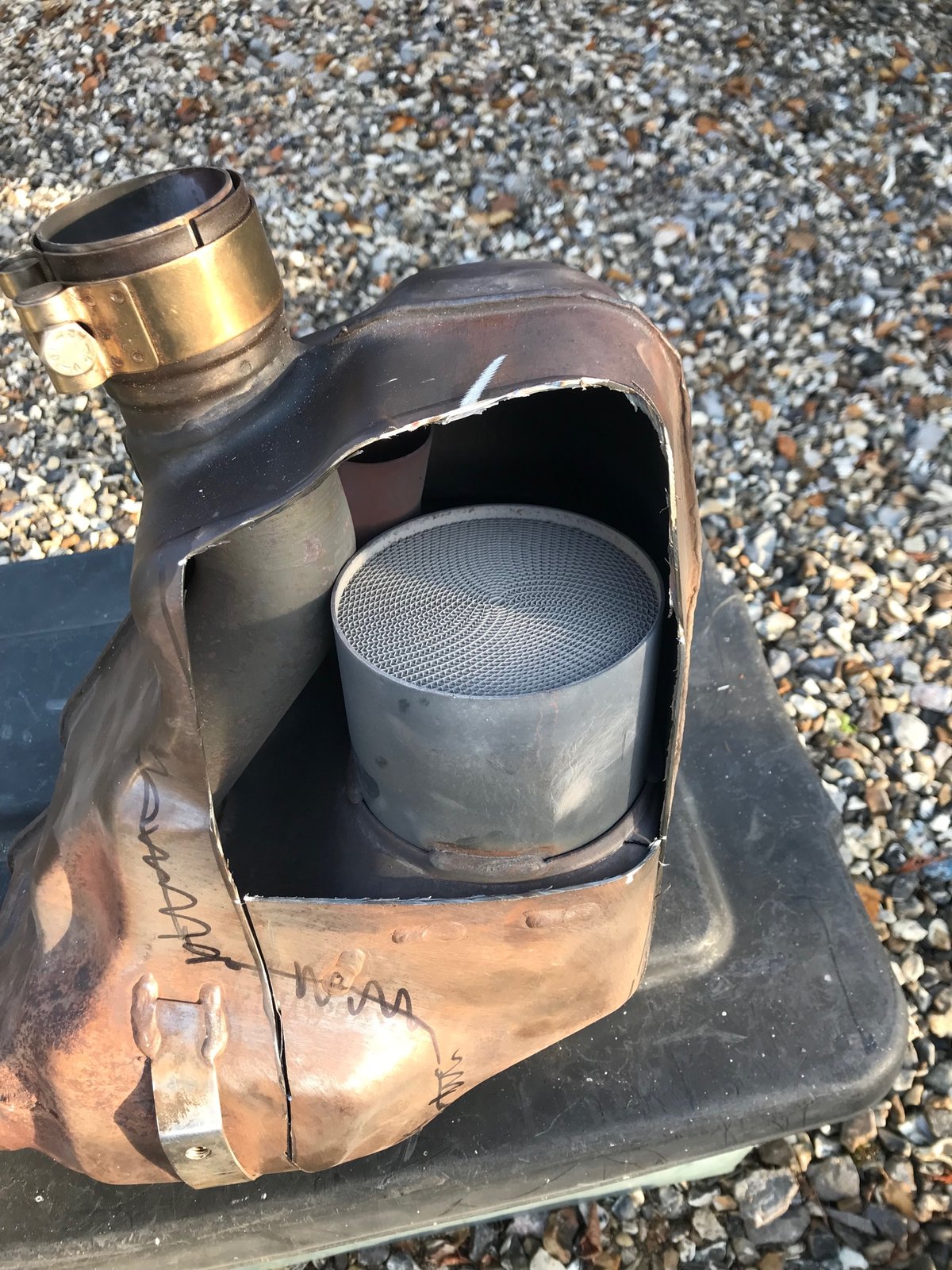

  10. 493C4FEC-DBF7-481E-AA4F-A2989C606CA6.jpeg 493C4FEC-DBF7-481E-AA4F-A2989C606CA6.jpeg F5F7919B-FB5F-45CA-AA8B-D1E7FE220D95.jpeg 6ACC2FDE-9818-4FF0-A4B2-04E2778768EC.jpeg Ok so far so good. I removed the cat which is easy enough took about 20 minutes. Double checked my spare cat was the same.
    You will see from the pictures I have cut the cat with a 2mm blade in an angle grinder and you will also see I didn’t need to cut as much out as I have, so my welder will simply put it back together again. Obviously keeping the two inlet and exhaust exits alone I preceded to cut, easy.
    You will now see from the pictures what’s inside and the cat bit is the round bit, removing that took a bit of time so I cut a bit off the inside which will be welded back on again and using a big hammer, numerous chisels and levers I smashed the cat out, let me say that’s very dense and when you hit it then is compresses up and makes it into a hard lump of metal, so drilling holes in it helped, but there is no substitute for hitting it hard, eventually when you have enough removed it will fold into itself and come out but again you need to spend about half an hour getting the initial bits out and it’s frustrating.

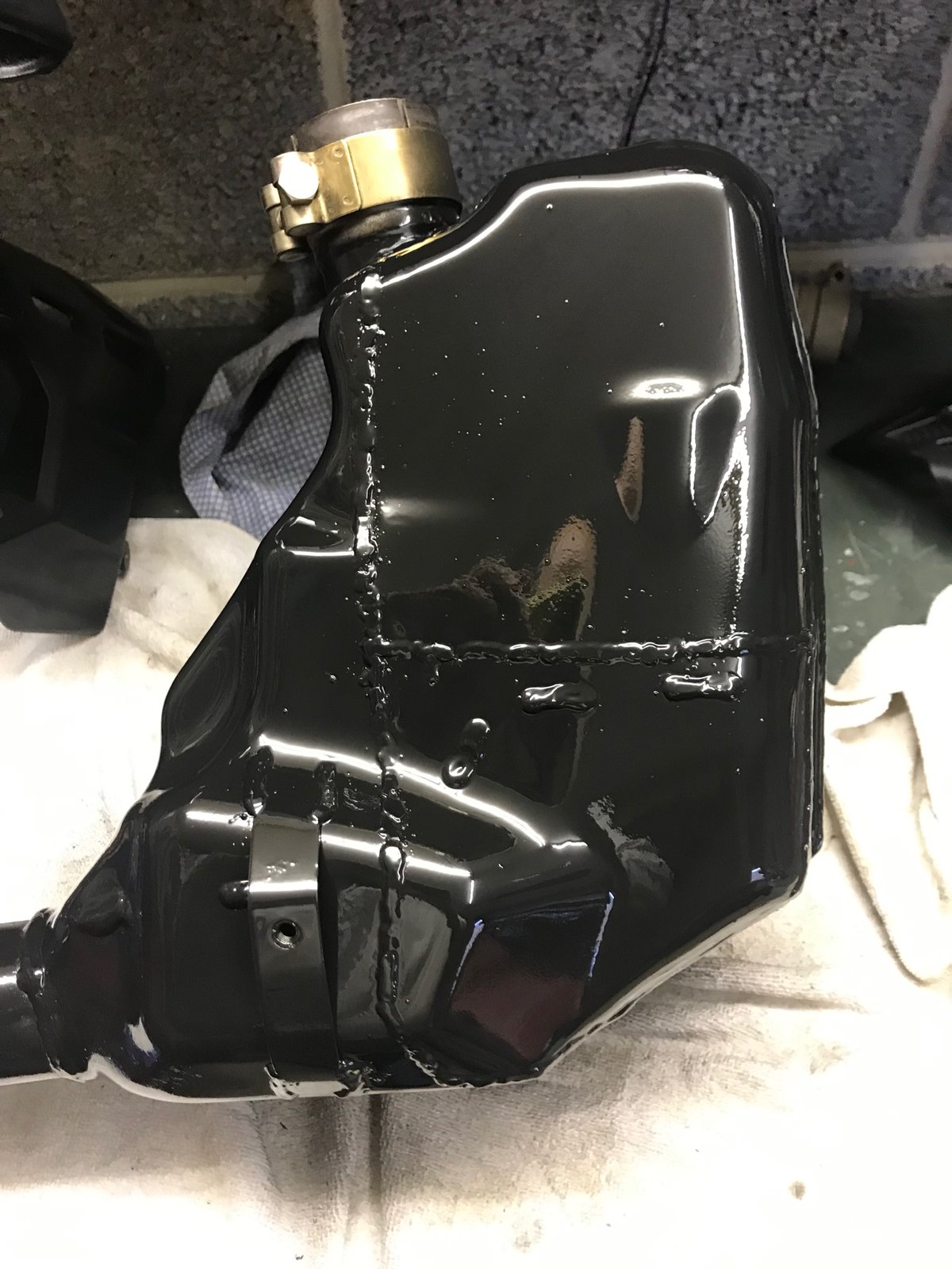

  15. 5F1BB1B6-5AD3-47C4-AFBE-5A04C604F1CA.jpeg So it’s now welded back up (see pic) and fitted back onto the bike, should you need to fit one then you will need a small trolley jack to hold the cat, resting on it you can ease the front pipe in then up onto the rear one stopping when the bolts on the side line up. Quite easy and I managed to get the belly pan and front Evotech exhaust guard on in less than an hour. I have put the basic bit back onto the exhaust as I am in the process of painting the two silver pieces.
    Started it up and yes it’s louder than the original but certainly not excessive in any way, I was surprised as I had expected it to be obscene noise wise and was planning to purchase a different canwith a baffle, I don’t need to now.
