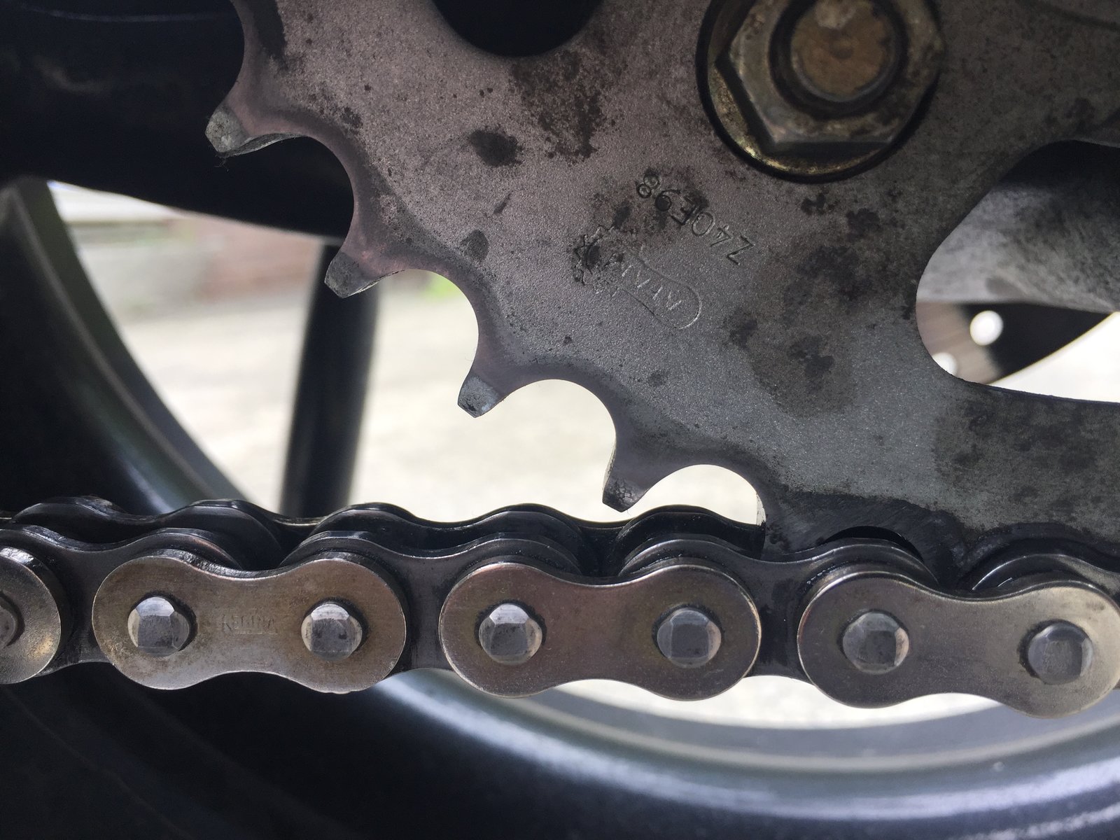

    My first Ducati (2006 Monster 1000) and I have no idea on how long you'd expect a chain/sprockets to last. Bike is coming up to 18500 miles and I'm guessing it's the original chain (I didn't get the bike new).
    Visually it all looks fine but I'm no expert, what is the average life span and should you be just changing the chain or front/rear sprocket also?
    I'd had the bike for 3000 miles, don't use as a commuter so it's only ridden in dry weather. Clean chain every 500 miles (yeah I know from photos def needs another clean)

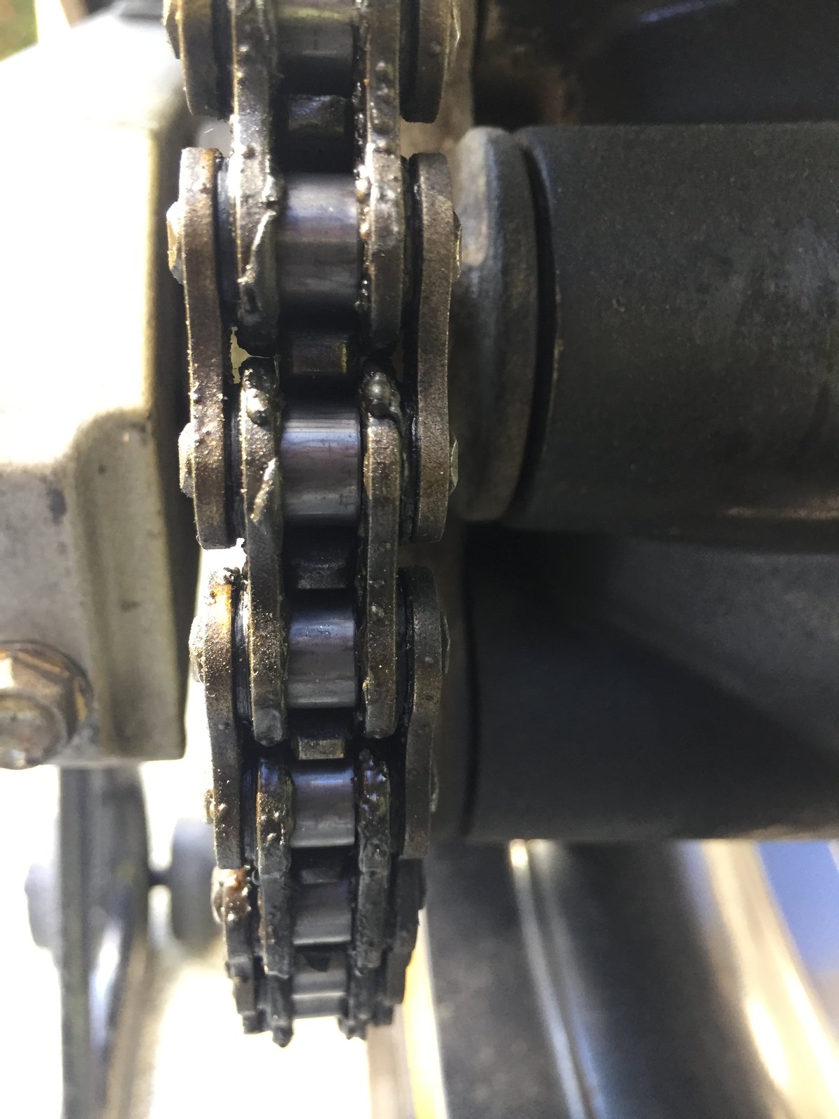

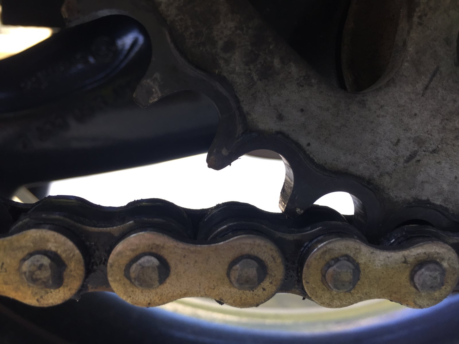

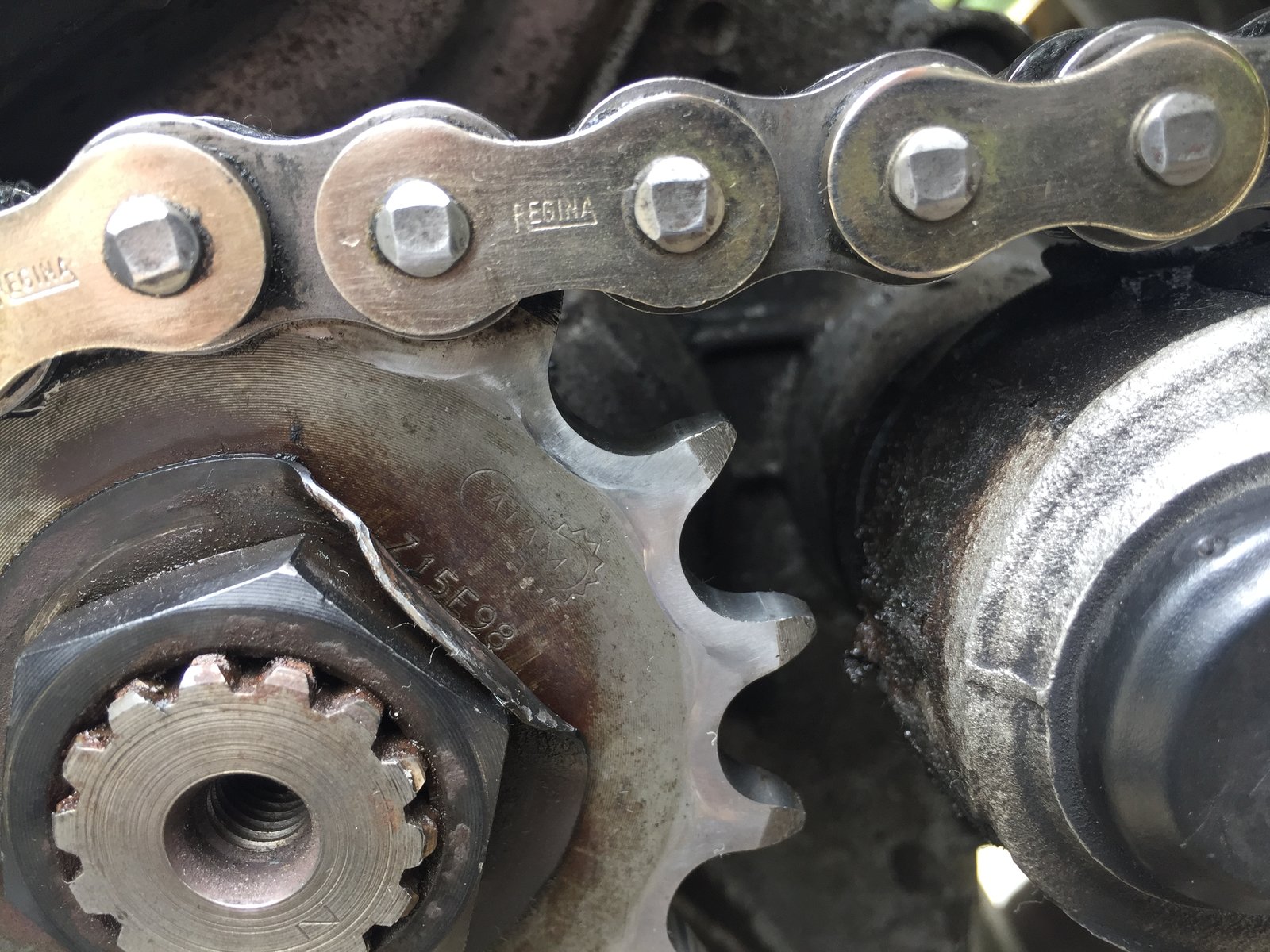

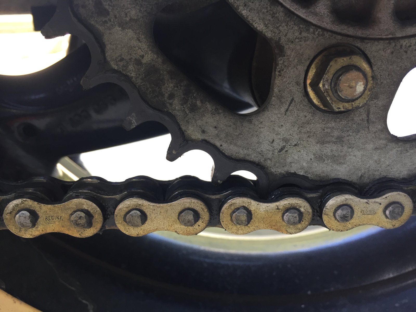

  3. Thanks Andyb I've uploaded some photos to my original post. I don't use bike for commuting so it's only out in dry weather, not sure about original owner.

  4. Doesn't look too bad. Needs a fekkin clean, obvs. Use your thumb and forefinger and try to pull the chain away from the rear sprocket. If it comes away a few mil and has play back and forth, change it. Even if you think it's seen better days, change it. Gives a good base line. And clean the fucker regularly too. :):upyeah:
  5. Looking at the pics the sprockets do not look worn... so would guess a previous owner already changed them.
    Rotate the chain and look for sticky links or play in links and then as Mary said check play on rear sprocket..
    See if there is gaps where orings are missing...

  6. I think that the chain and sprockets have been changed before. My test is to look for tight spots in the chain as you turn the wheel. There will be some but if it gets excessive then it becomes difficult to adjust the chain correctly. Also, try pulling the chain away from the rear sprocket. It should not be excessive as this is an indication that the chain could jump off the sprocket!
    Looking at the lock tab on the front sprockey from your pic then that looks kike it has been changed.

  8. Sorry to disagree with a previous post but the front sprocket is quite worn, look carefully on the drive side of the teeth around 2 o'clock in the photo and the wear has taken up to a mm out of that side of the tooth (it will be obvious when compared to a new one). You get some idea by comparing the drive side wear with the non drive side wear profile - they are identical when new.
    Often you get more wear every second tooth as the chain wears as the contact ends up unevenly spread to every second tooth which accelerates the rate of wear of the chain as the load on each tooth contact is greatly increased - it is this you find when pulling the link away from the sprocket and checking how snuggly the chain fits within each pair of teeth. A link should not be able to rock back and forward around the perimeter of the sprocket, yours most certainly will. You have AFAM fitted which are good but not OEM. Get a new set then compare them and you will see the wear.
    It will run ok for quite a few miles but if it was mine I would change it all. You need to clean the sprockets as well as the chain and I would recommend using dry chain lube which gets rid of most of the grinding paste wear you see on the front sprocket due to dirty lube

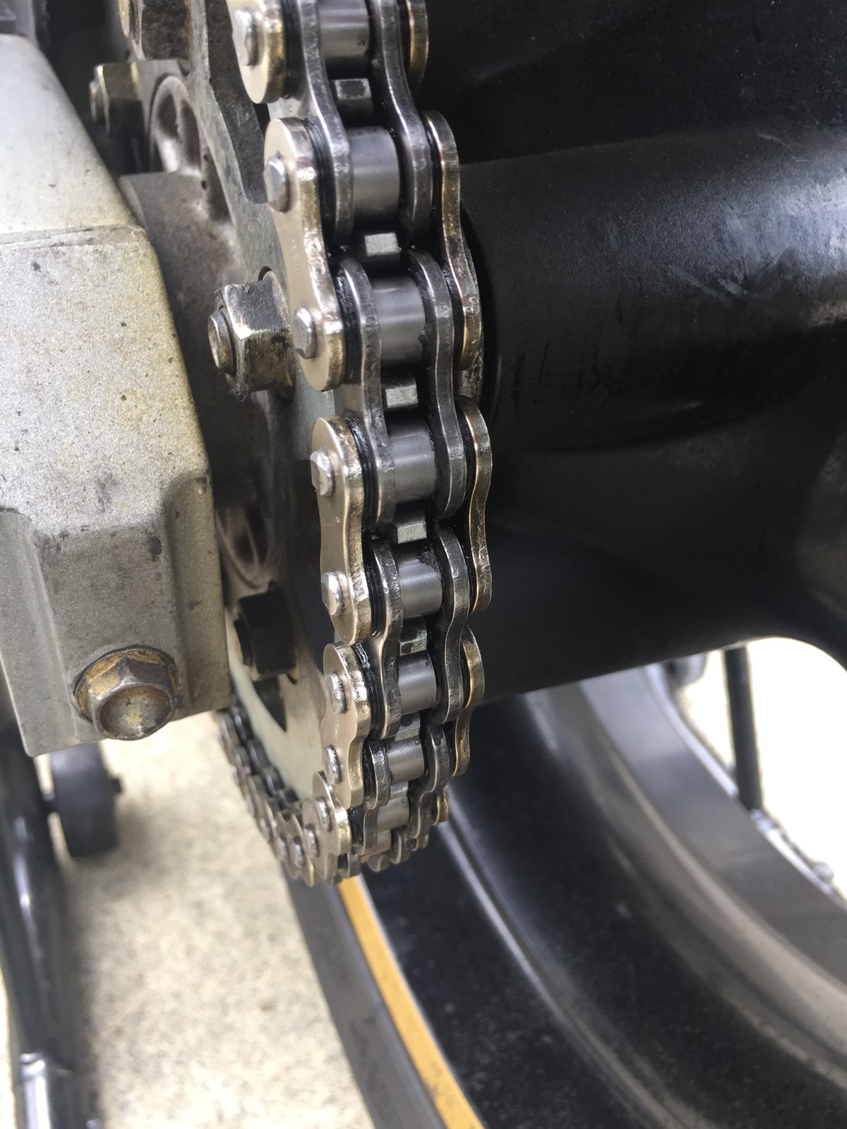

  10. Thanks for the advice guys really helpful. I should have posted original pics post clean but managed to give it a spruce up today so here's some pics before she gets lubed up again.
    Cause most of my riding is dry I use a chain wax, I've included a photo of it. You may have a brand you think is better so if you do let me know but I'm in New Zealand and we don't have the same choice at hand down here.
    Chain sits pretty snuggly on sprockets with not much play, front sprocket does look a little worn, rear not so much but I think I'll get another 1000 miles out of it and look at changing the whole setup then.

  16. I disagree that the front sprocket is badly worn. Of course, it is difficult to tell from just (very good) photos without being able to touch and feel. And it does look much worse in the first photograph than the new ones. I think that it has been changed but we don't know when and for what reason. But to get thorough two front sprockets in 16k miles would, I consider, be very excessive.
  17. D3D39614-2C30-442E-85F3-A1588C9162E9.jpeg Chain life threads are nearly always controversial and can often end up in a bun fight, glad I didn’t comment earlier/no point. What I will say is that Regina made some damn fine chains in their time and nothing wrong with the quality, they were standard fitment on some Lancias for many many years, I still have around half a dozen new ones and would have no qualms about fitting them. Can’t comment for quality of current production but certainly not to be written off as quickly as people tend to on here.
  18. Perry, there is a difference between my statement "quite worn" and "badly worn" which is your interpretation of my post. The engine sprocket is plainly worn in both sets of photos, rear not so much
  19. It is hard to comment accounting for parallax error and distortion from a mobile phone camera lens. I thought the front sprocket looked ‘non symetrical’ on the teeth but put it down to the above so didn’t comment on it either way :thinkingface:

  20. OK, I accept that we may be getting down to semantics, now. I was really thinking about 'would I replace it' rather than is it worn. I would maintain that it is not worn enough to warrant replacement yet - but, it is not easy to rely on photos. If it was the original, then at that mileage, I would say replace anyway. My experience is more from just going by the rear sprocket and chain. When I think that replacement is necessary from the test as described in various posts above, then the whole set get replaced anyway. In my experience, it is never the front sprocket that begins to start the process.
