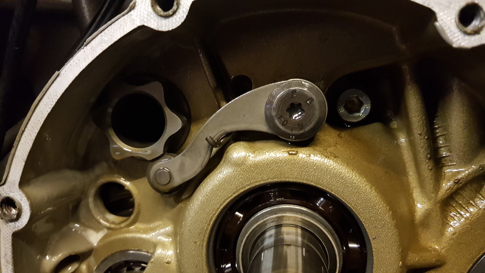

  1. And then reveals this bit...
    Torx end to get this out. I used red threadlock to replace...not too hard to swap out...I did it up a little and then moved the spring until it seated in...

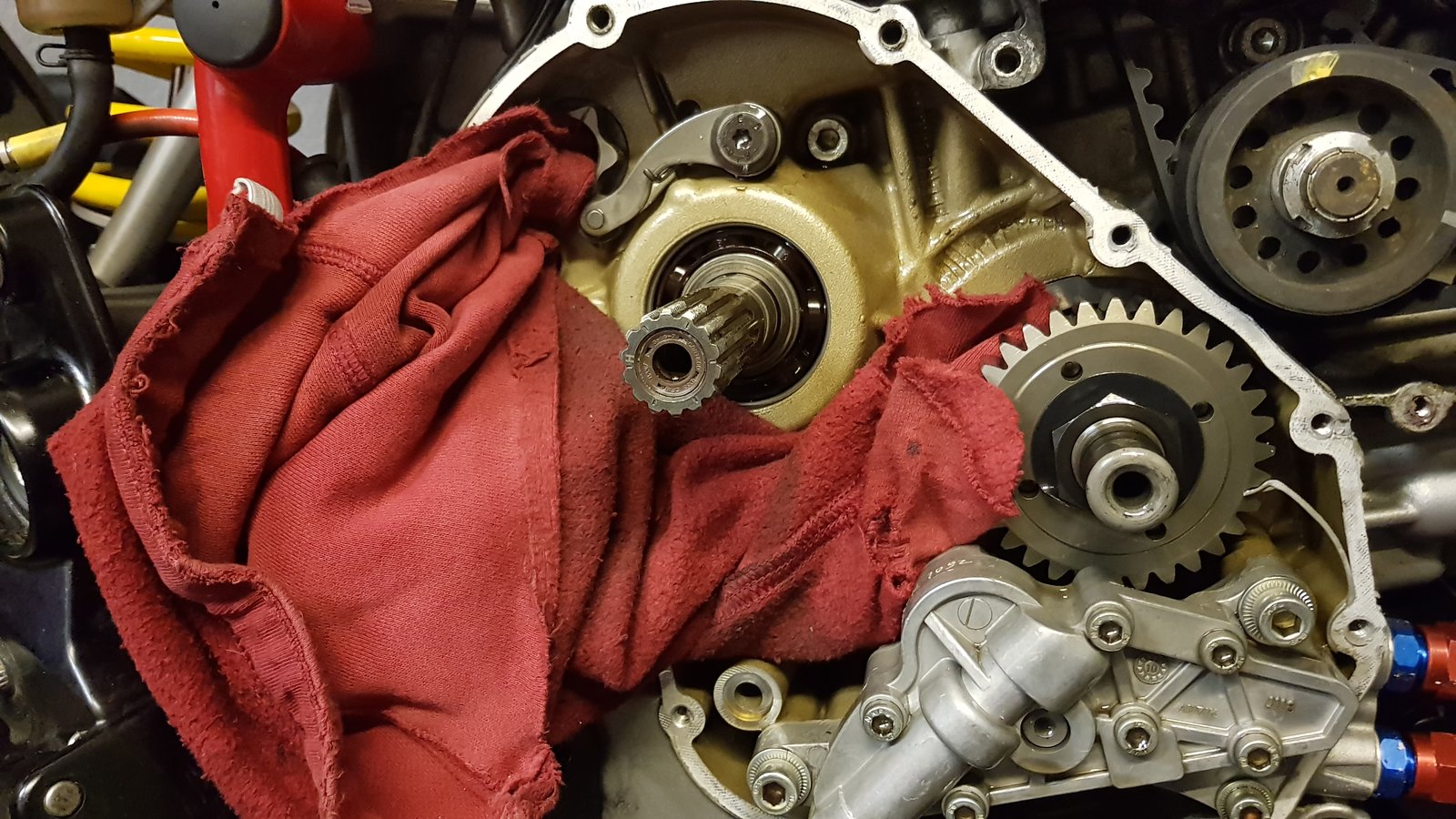

    I covered all holes that little things could fall into with a rag also...

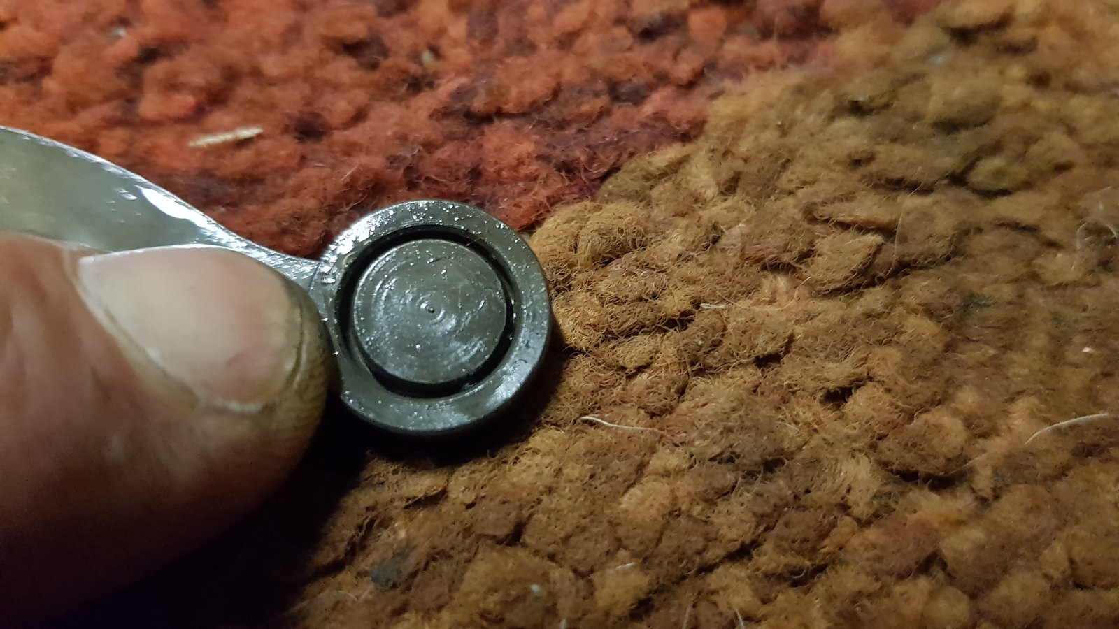

    Right...first and foremost there was a massive difference between the stock and the aftermarket parts...the factory pro bearing was tight and smooth with no play and the stock part had just over a mm of play in there...
    That me kinda pulling the outer to one side...
    So, there we have it...reassemble in reverse order...discuss...
