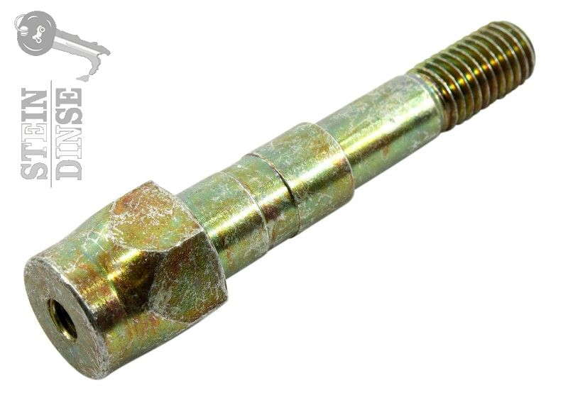

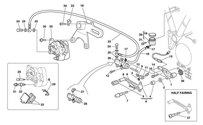

  7. right just checked stein dinse site think the bolt in question is this one in pic number 7 on the diagram
    just over 48 euro ouch....
  8. Thankfully it’s not that bolt, but one that fastens into the end of it. That would have been an expensive outing for sure!
    I’ve been checking the fiche’s and it doesn’t appear to actually be shown, but judging by the fact there’s a fixing point on the fairing and a fixing on the other side, it clearly fastens in somehow.
    Anyone got a later SS and wouldn’t mind popping out the fastener in question to put the mystery to bed?
  9. You want the bolt that goes onto ‘number 7’ on the diagram.
    Mine is in bits at the moment, and typically I can’t find the bolt for there.
    I did just wind in another, longer, bolt and measured how far it went in, which was 20mm if that’s any help.
  10. Great, thanks Alan.
    Sounds like the old fastener has sheared off in there - time for more adventures with a dremel and stud extractor
