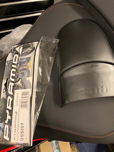

  4. Thanks Tony do you have a link? it was a pyramid plastics one that I ordered and was wrong :weary_face:
  5. That would be great … and a link so I can purchase? :heart_eyes:
  6. Its not an Enduro is it? Apparently they're different :confused:
  7. Its not an Enduro is it? Apparently they're different :confused: IMG_0637.jpg

    No mine is an MTS and yes the Enduro version is different as I understand it. I'm pretty certain it is/was a Pyramid item I bought, but I'll go an check it out and get back to you, with a photo too.

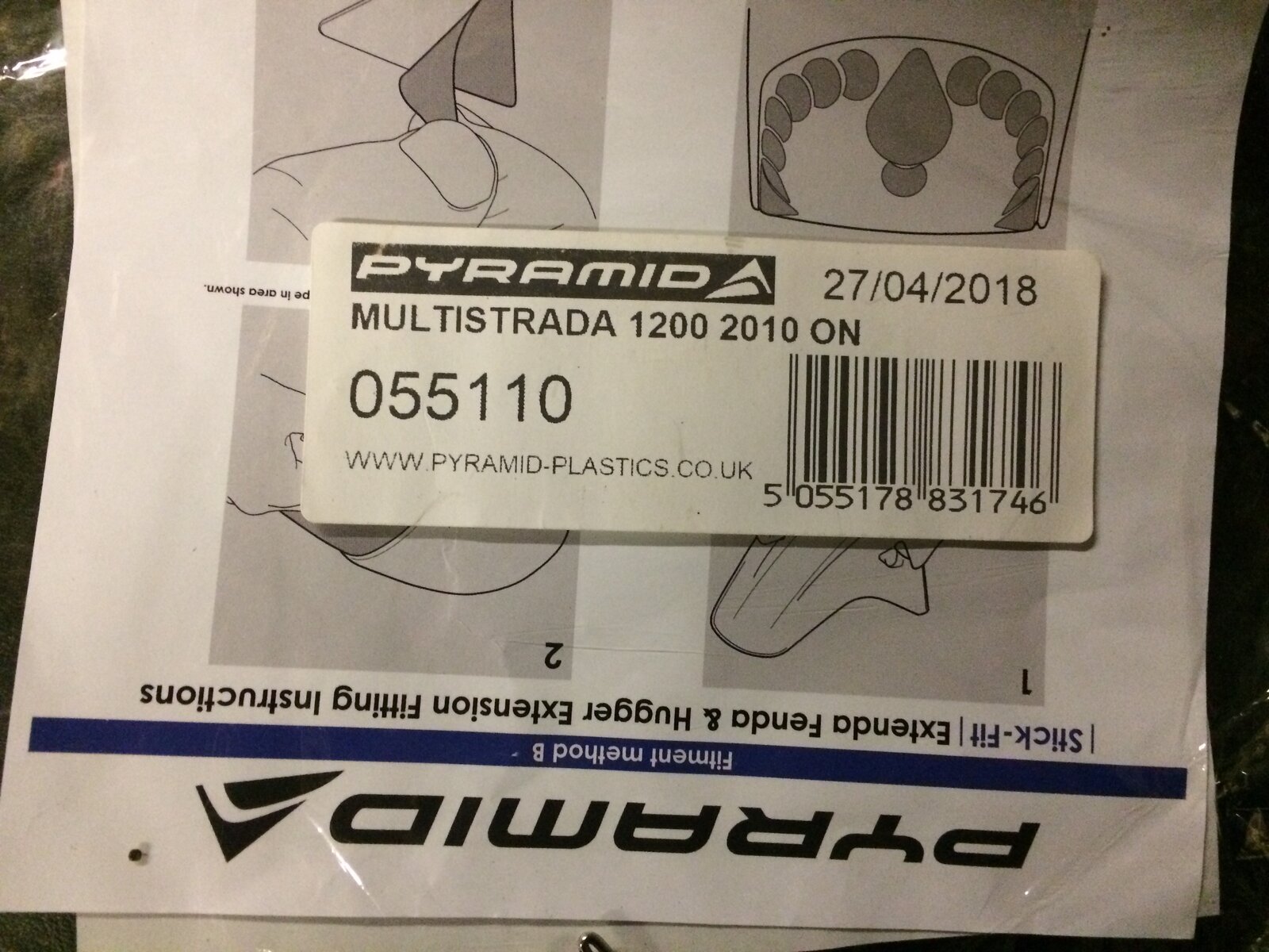

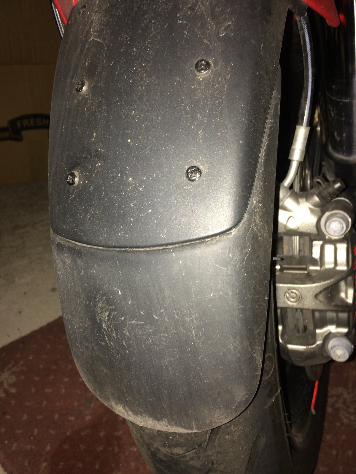

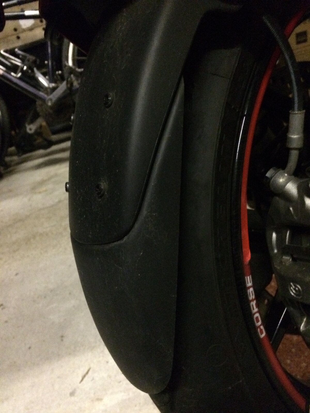

  10. Steve,
    :) Here's a copy of the link to the PP website and I've checked out the item fitted to my bike, which is the very same. Item No: 055110 and it does work fine.
    I would strongly suggest though, NOT using the P-P sticky stuff or the plastic rivets they supply, as they allow the extenda to flex far too much. Instead, as in the couple of photos I've attached, try to drill out your own pre-marked locations on the original fitting (you'll need to take this off, which can be a sod to achieve) and then attach using lock nuts and S/S bolts, which as you can see, I've then painted using matt black to tone the look down a little bit.
    Mine hardly moves at all and contrary to some of the guys who've commented before about this addition, I've not had any deterioration or contact with the engine guard or the front tyre.

  11. Brilliant that’s the one. I tend to Gorrilla glue them on (I’m a thug I know). I’ve ordered one :upyeah:

  14. Are those swirled scratches on the fender extender? I've had two and they've both developed scratches in the same place, but can't figure out how they got there.
