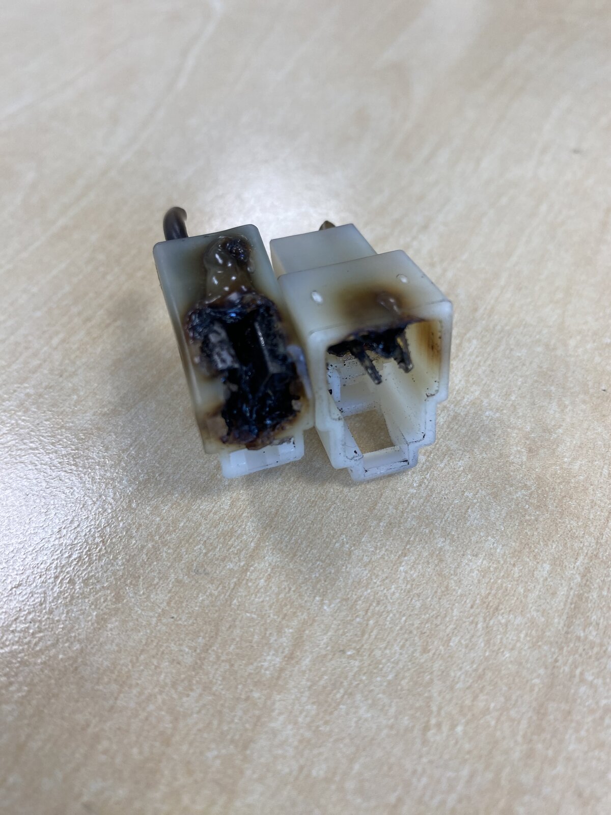

  1. Get her fixed tomorrow and see if she’s charging after that
  2. All sorted. Charing at 14.4v but the fix is a very good temporary affair. Is there any upgrades available that people have fitted?
  3. Yep. You can fit larger gauge wiring and better plugs, or even go to the later three phase system.
  4. You can fit a later shindengen reg/rec. Triumph even do a adapter loom that is plug and play. I personally went with a Shindengen copy and replaced the wires from the stator with new, thicker ones directly to the reg/rec. Then modified the loom on the charging side so suit the new reg/rec.
    Short video what that looks like on my bike.
  5. Thank you, sounds like a winter job, I’ve made a good repair and think I’ll do the upgrade to make sure of hopefully no future problem's
