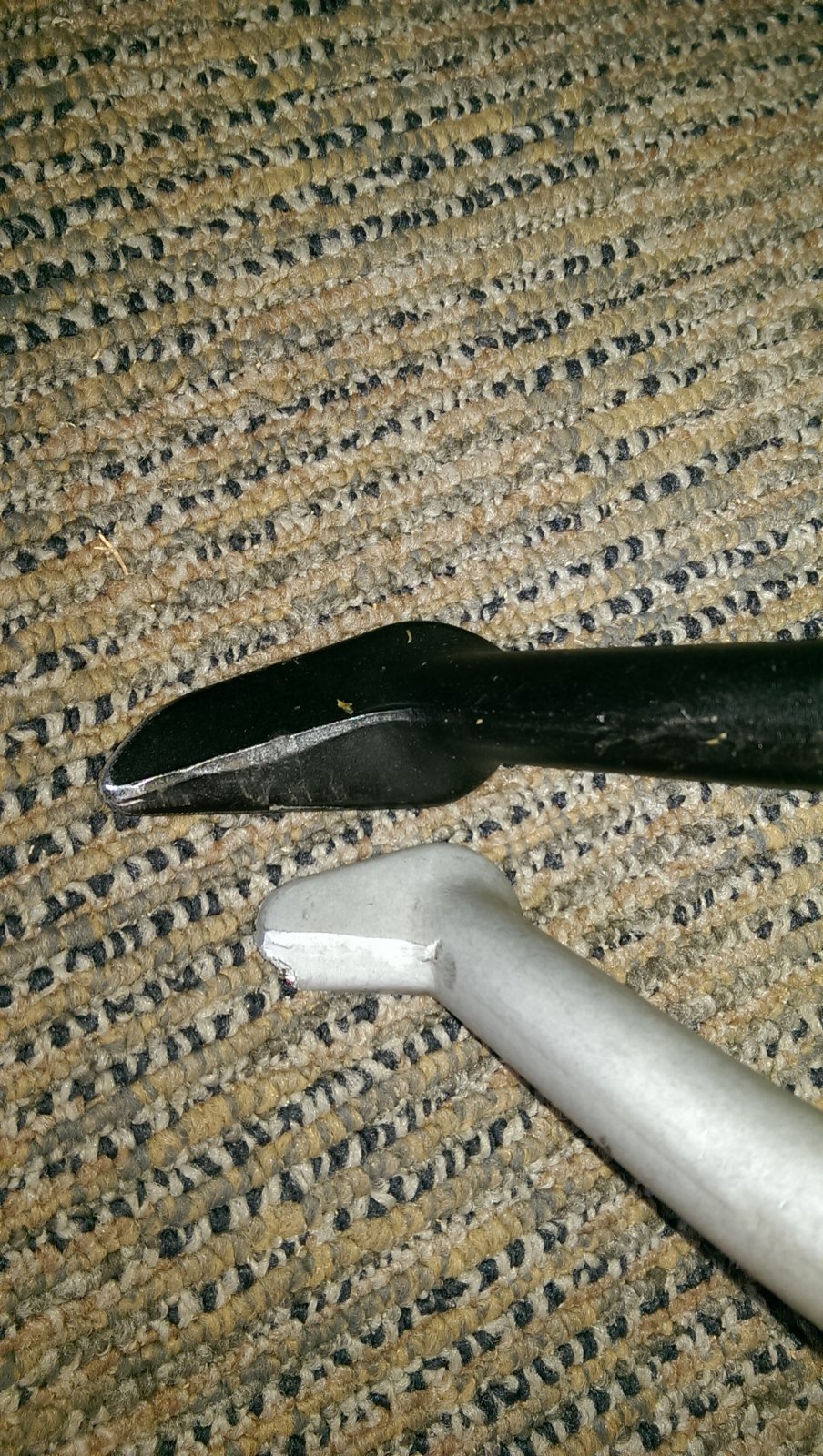

  3. uploadfromtaptalk1442747391983.jpg it's about 1/2" longer.
  4. Cheers mate. Looks like it'd be easier to kick down to the floor as well with the extra foot print.
  5. Yep, much easier to find.

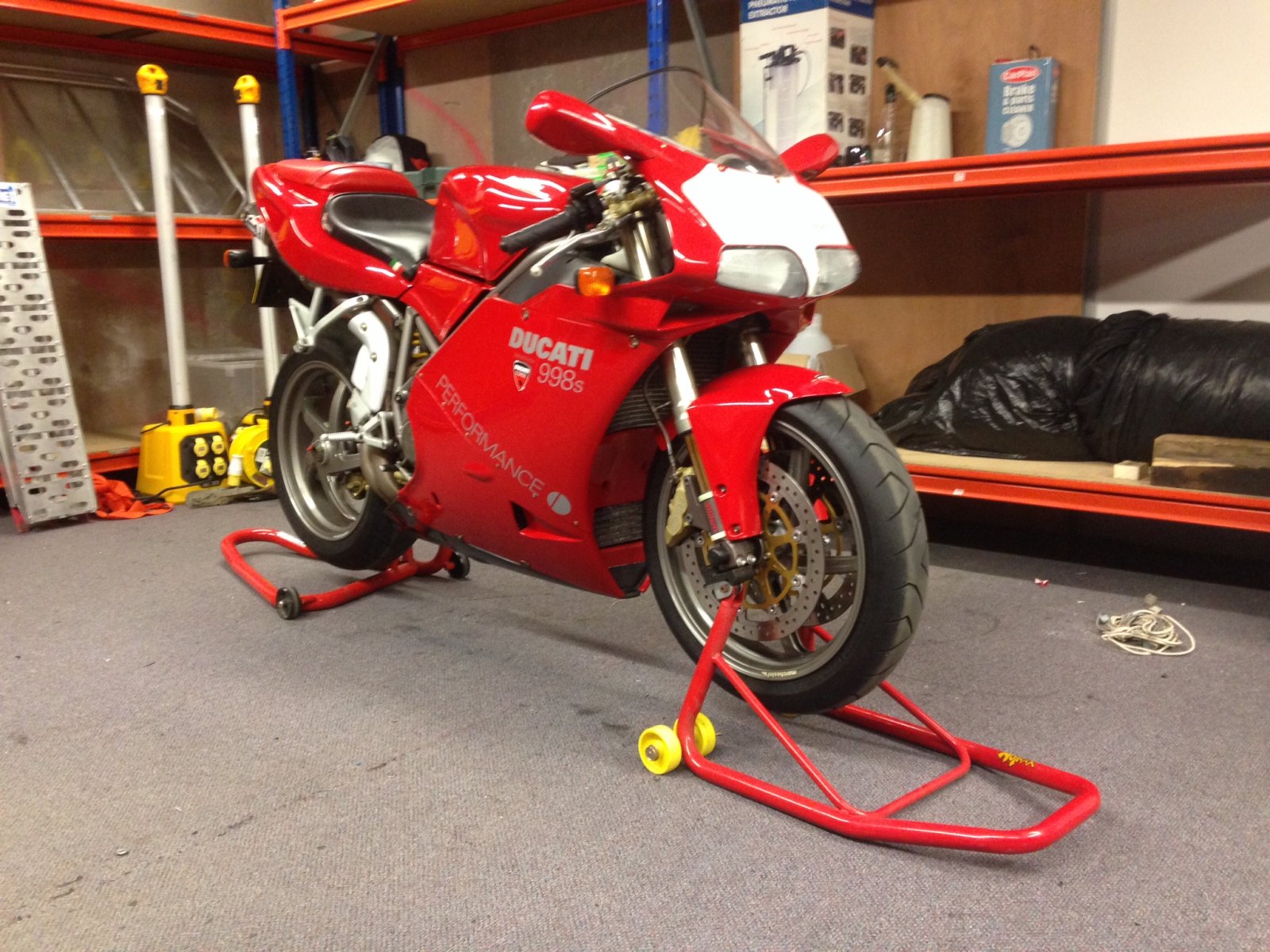

  8. Quite a bit done today... Pilots fitted with new 90 degree bend valves for £160 which seams ok.
    AFAM chain & sprockets on, 15/38 with a a 2 link longer chain IIRC.
    New bremo brake and clutch reservoirs fitted. Just need to bleed the old fluid through. Then spent a couple of hours cleaning old oil and grease off and around the swing arm and engine.

  14. Managed to crack on a bit with the TLC today and also realised how right you all are about how easy it is to work on this bike compared to the later models.
    Lifted the rear seat unit to change a blown tail light bulb. 2 minute job. Was also happy to see the original tool kit there, still in place. Just glad the shop where I bought it probably hadn't worked out how to lift the seat or they'd have had it!

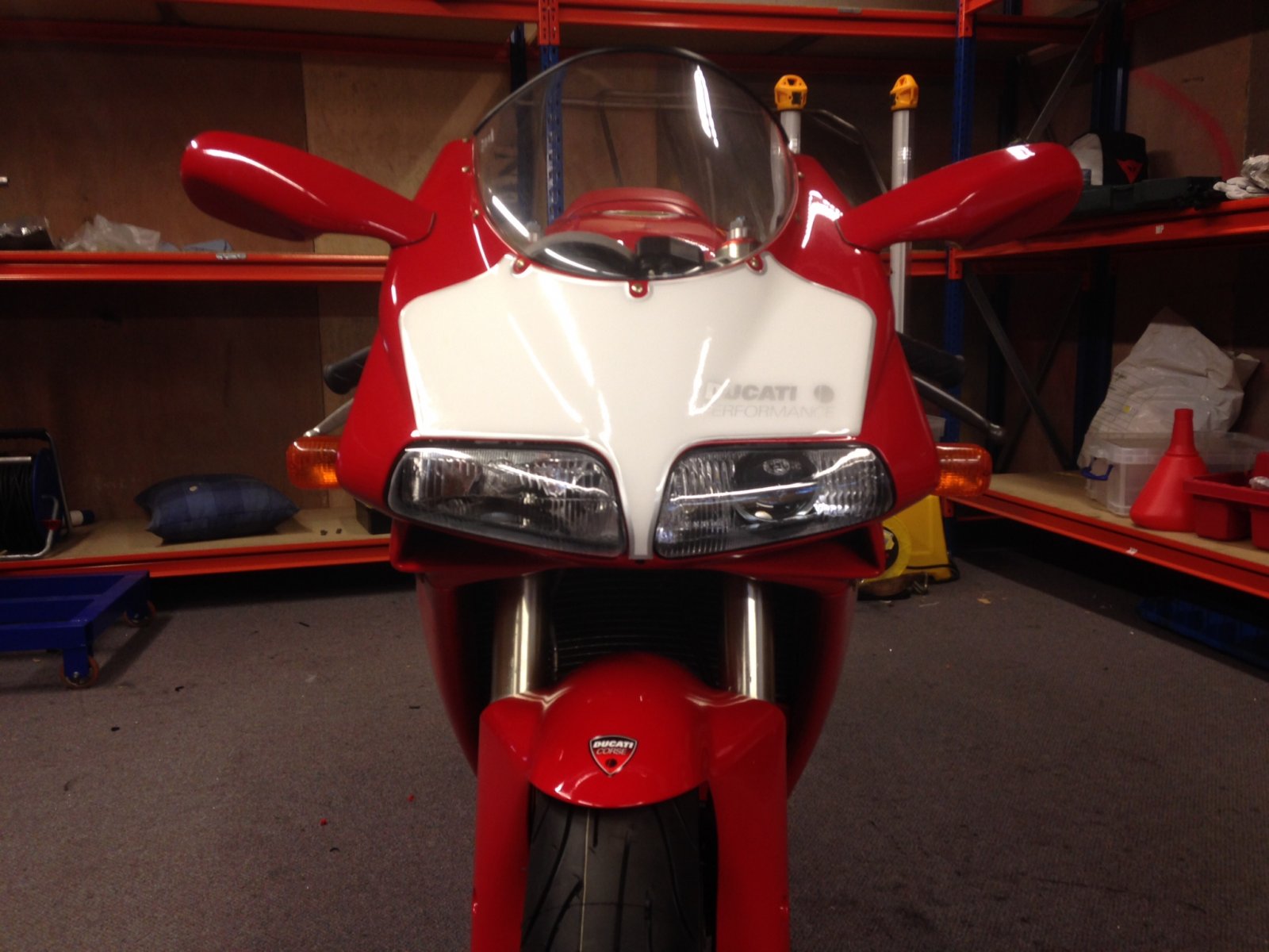

    After that I cracked on with the milky headlight jobby. Out & back in in less than a couple of hours. Well happy with the results...
    Thanks for all the tips & tricks so far.

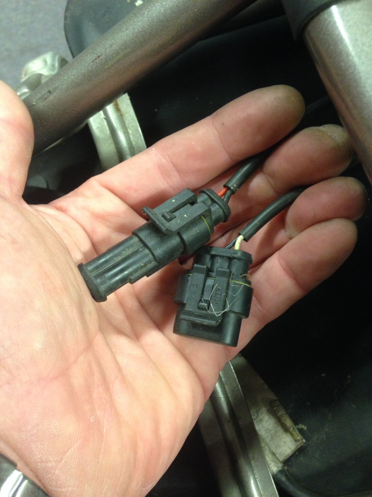

  15. Oh and while I had the seat up, I noticed these 2 loose connectors. I imagine one's for the ECU but what would the other one be for?
    Cheers, Ian
  16. 3 way is the diagnostic. Does the 2 way have a link wire in the end? If so then it's for the immo circuit of the factory alarm system (when fitted).
