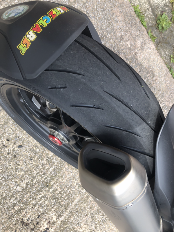

    Ona lighter note I had some S22’s fitted , not really the right tyre but they almost make the bike turn as good as my old 2011 bike
    It still seems slower to turn in though ?
    First day out on them today
