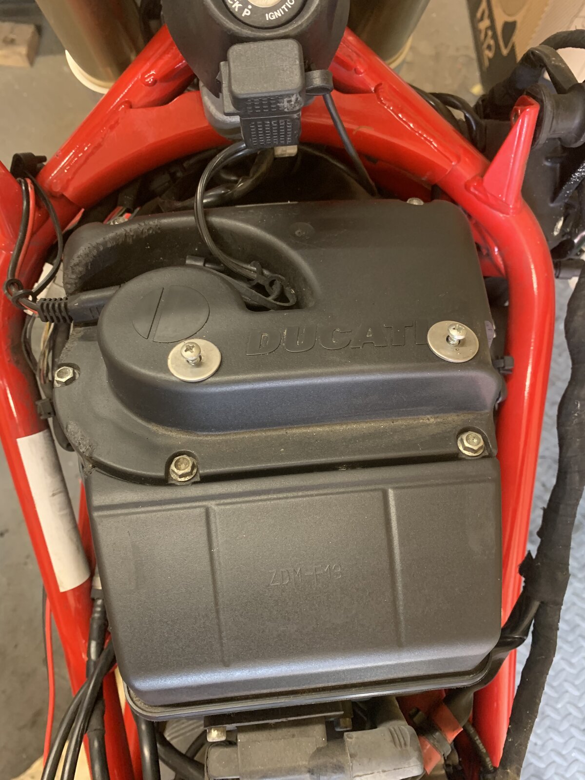

    also need to do cam belts and re pack silencer so thought I’d strip her down a bit. Tank off etc. Not all but some of the bolts on top of the air box are impossible to undo. They just click round. Obviously the threaded fitting the bolt screws into is spinning. Now I know mines not the only one that has this problem so how do u guys deal with this?

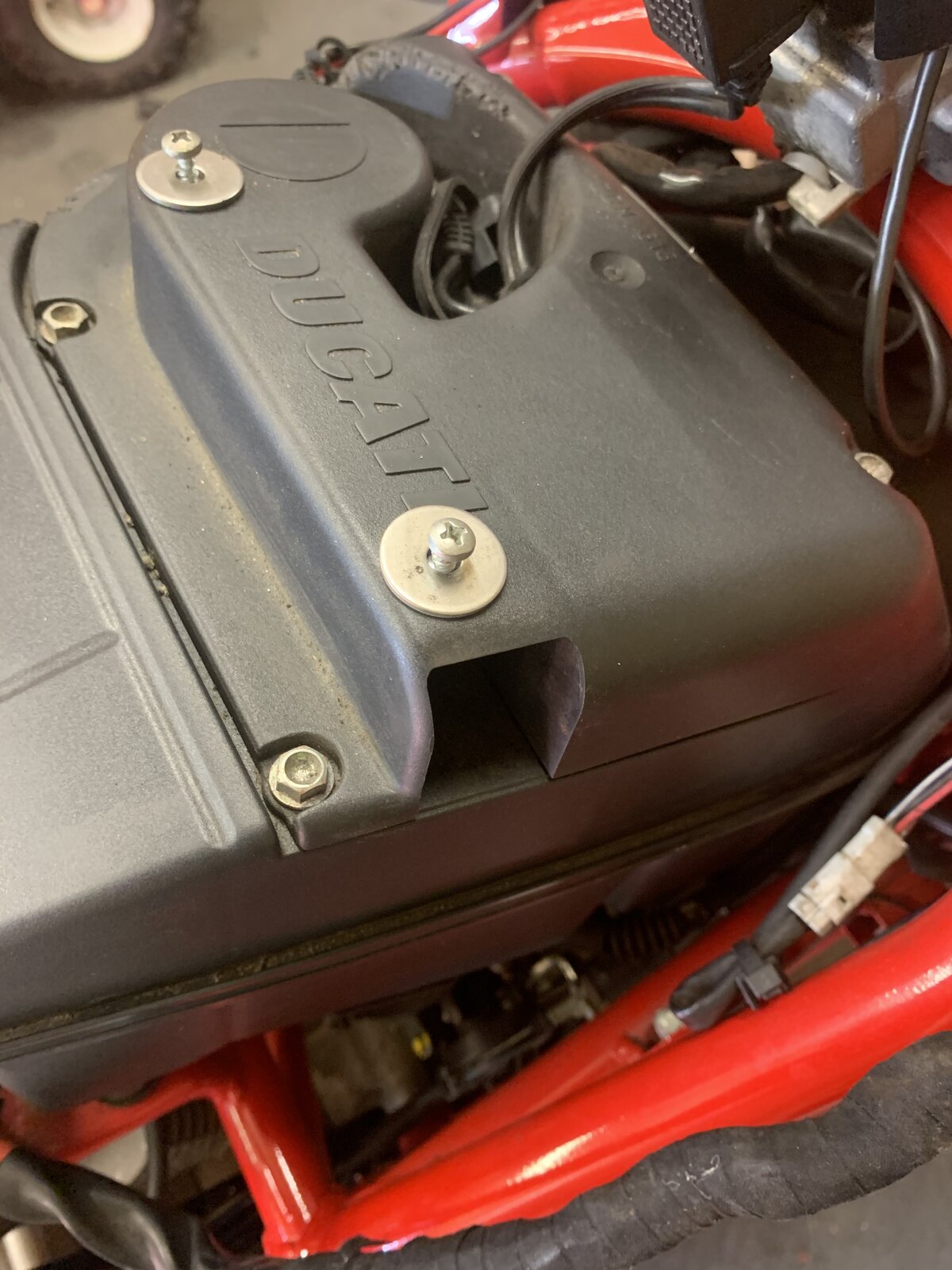

    I’m not totally familiar with the Hyper airbox but if the only bolts not fully releasing are the 2 Philips head ones, those don’t look like original Ducati ones. It looks to me like the bolts holding the airbox lid in place are the 8mm hex head ones around the circumference. @comfysofa would have first hand detailed knowledge.

    No it’s a few of the 8mm bolts that won’t come out. Going to have to chop the heads off and melt the threaded insirt out with a soldering iron and somehow repair. Still! I can do the air box mod while I’ve got it off
  12. Before you chop anything wait & see what @comfysofa says, it seems strange the threaded insert is knackered, that’s not an area prone to getting wet and thus corroding.
  13. All done mate. Put a socket on a drill and spun the offending bolts until they got hot enough to pull out the plastic put them in a vice to separate the threaded collet. Bonded the collets back in the main air box and bolted back up with some oil on the threads for next time.

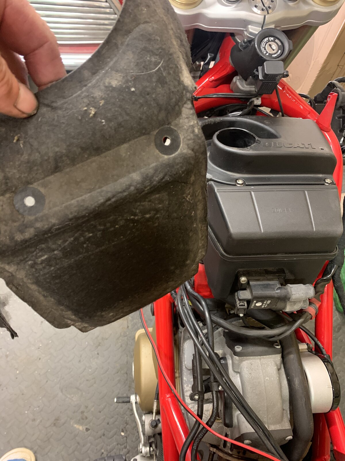

  14. Do u guys bother putting the cover thing back over the top of the air box. Obviously coz I’ve done the air box mod the cover will need a hole in if re installing
  15. Can you throw up a pic? I think you'll need put the lid back unless you've got individual filters for each throttle body.
  16. I don’t mean the actual air box lid. I mean this material felt cover. I presume looking at what it’s made of it’s a sound deadening thing. It’s just if I re instal it I’d have to cut a hole in it where ive cut the air box
  17. I'm guessing that can be left out. If it were mine I'd leave it out and see how it goes.
