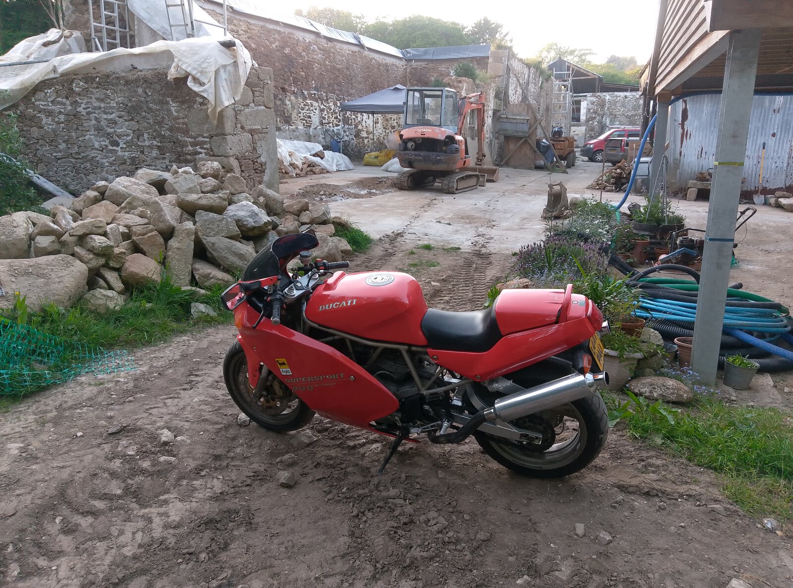

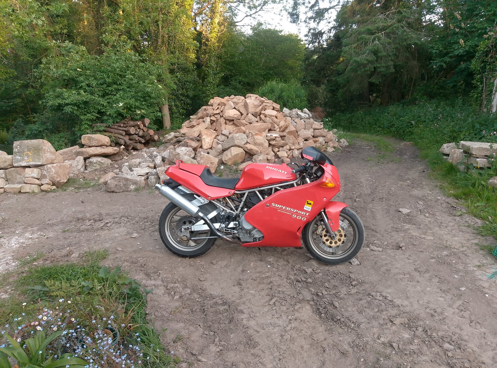

  10. Well managed to get some pics, It's not a minter but is respectfully tidy unless you go looking close up!
    lot's of bits to tidy and play with (during the winter! barn conversion is also underway!)
    My friends say that a 900ss is how a bike should look, they don't even ride!
