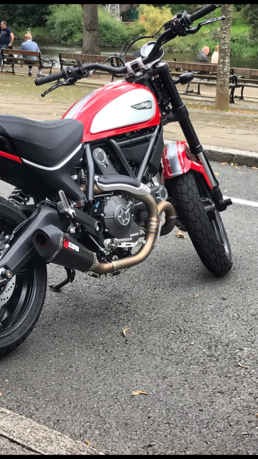

  4. Flat bars fitted today. Easy as pie. It makes a real difference to the sitting position, I think it actually feels a lot better than stock.
    So thats the stock exhaust and bars thrown on the garage shelf, exactly where they belong:upyeah::upyeah:
