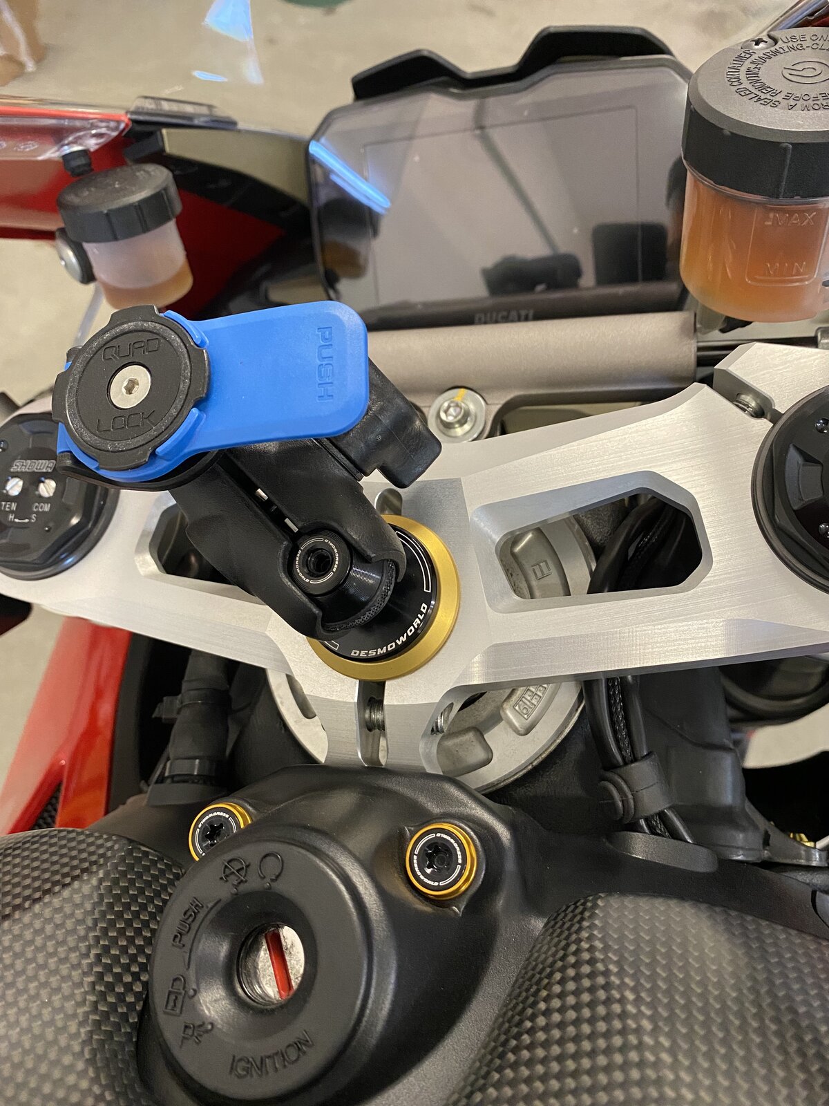

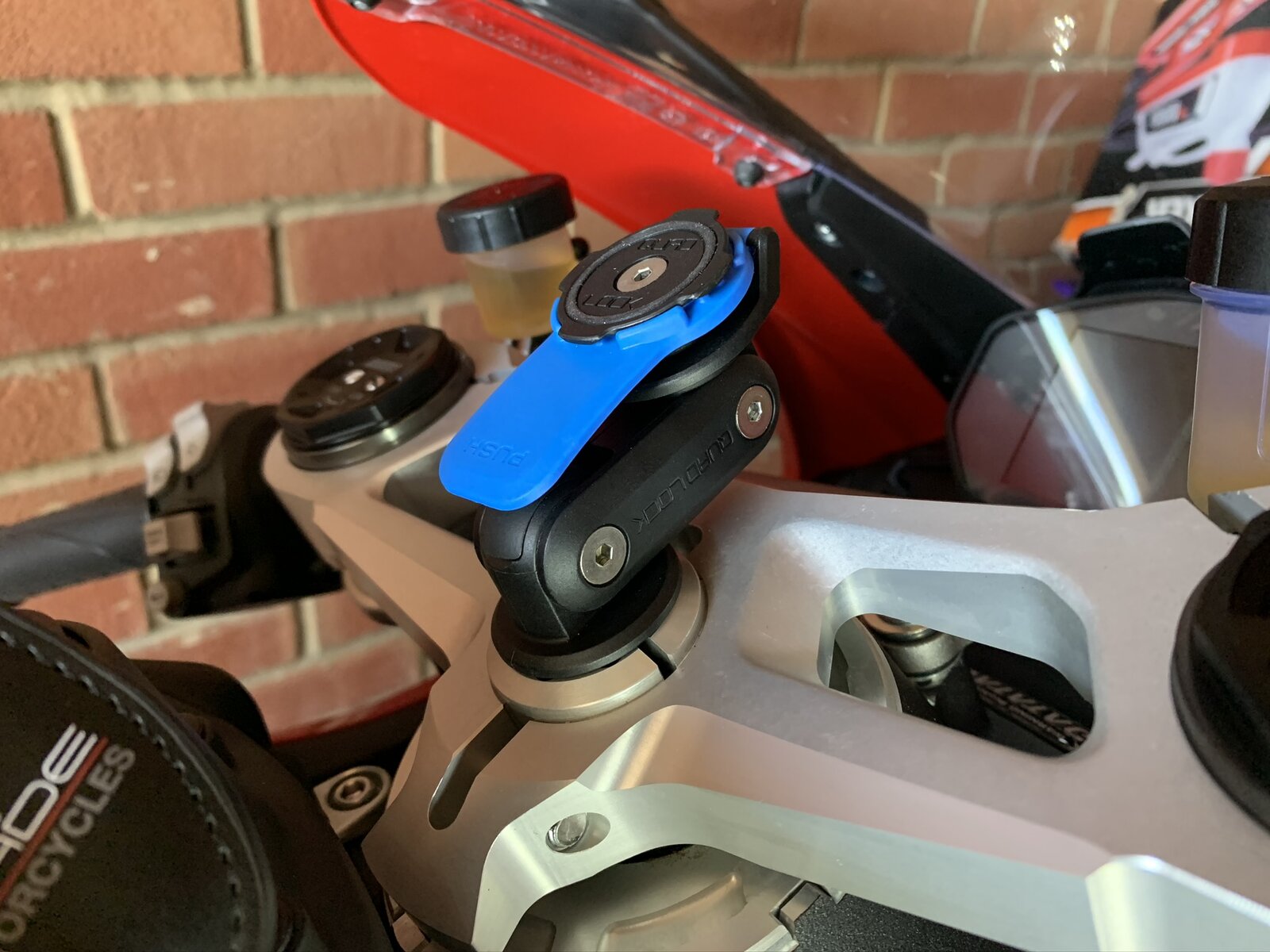

  2. You can mount in the headstock, I used a quad lock, but also ultimate addons do a case. You just have to modify the mount as the tube is much wider inside than the aperture.

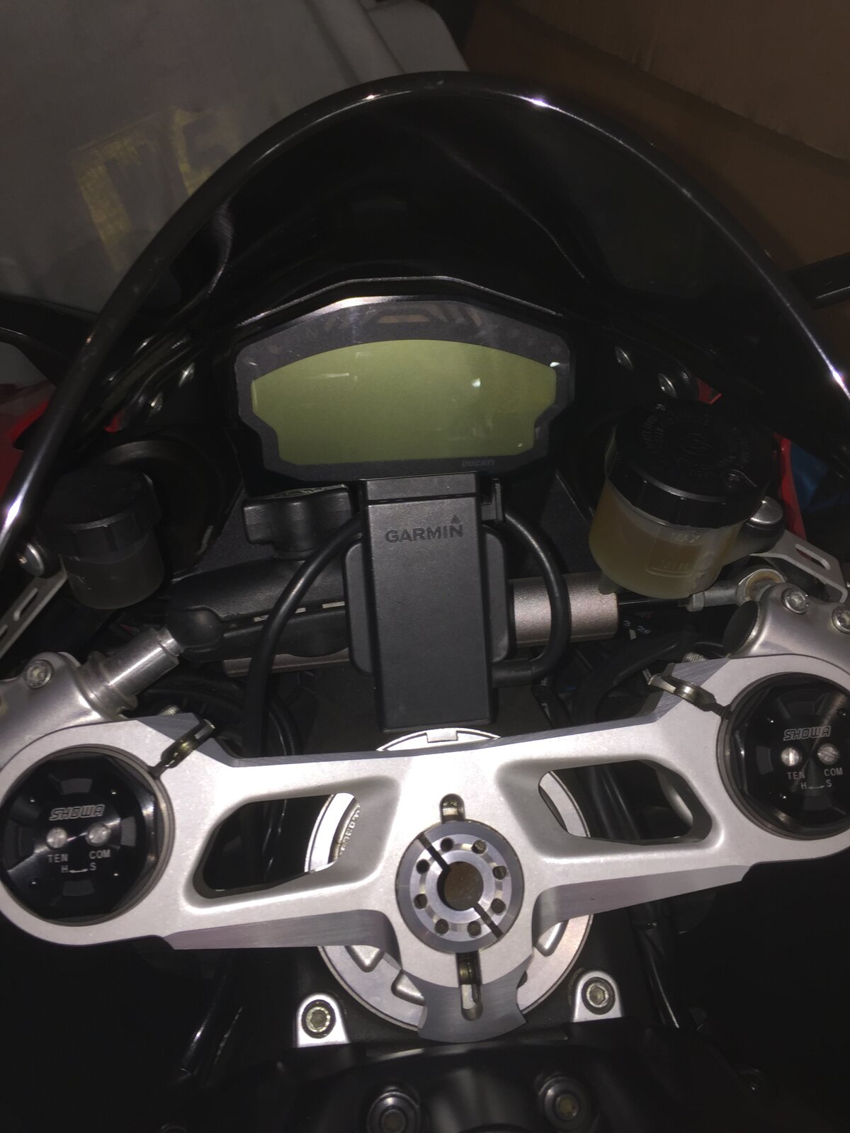

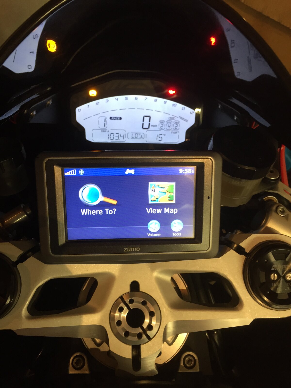

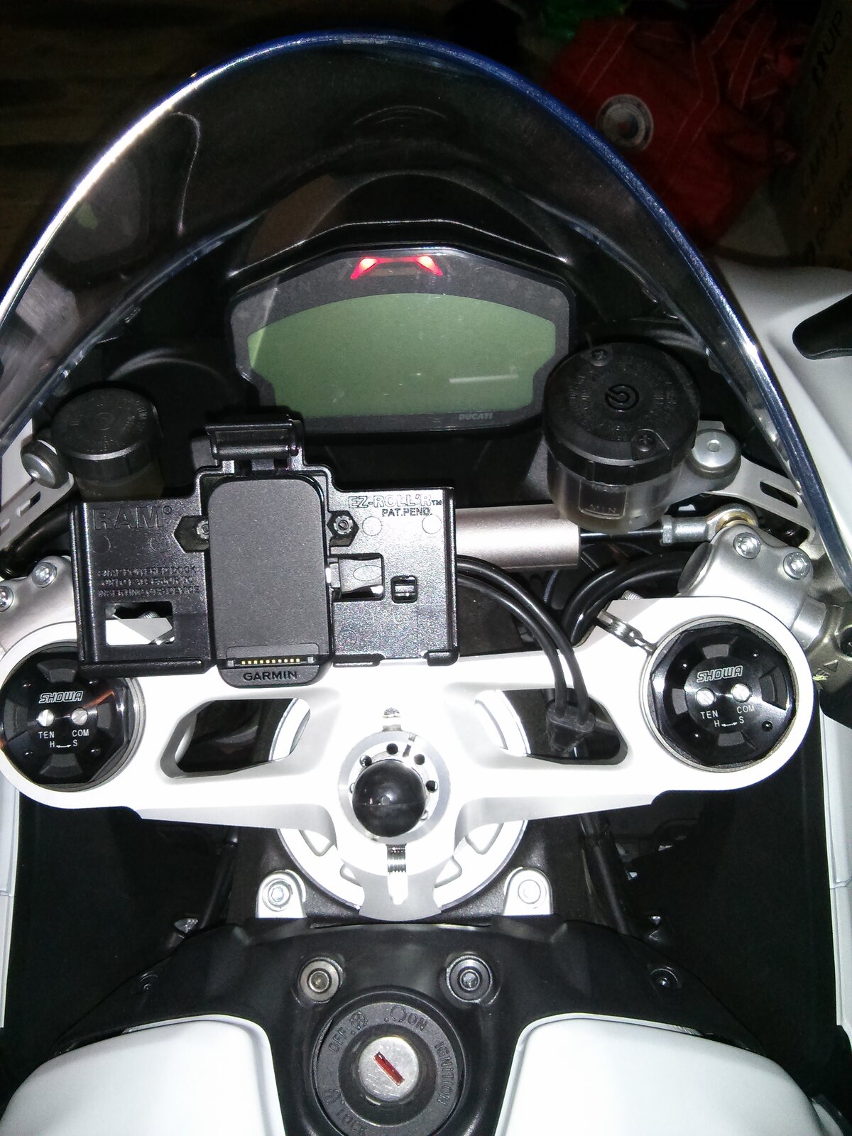

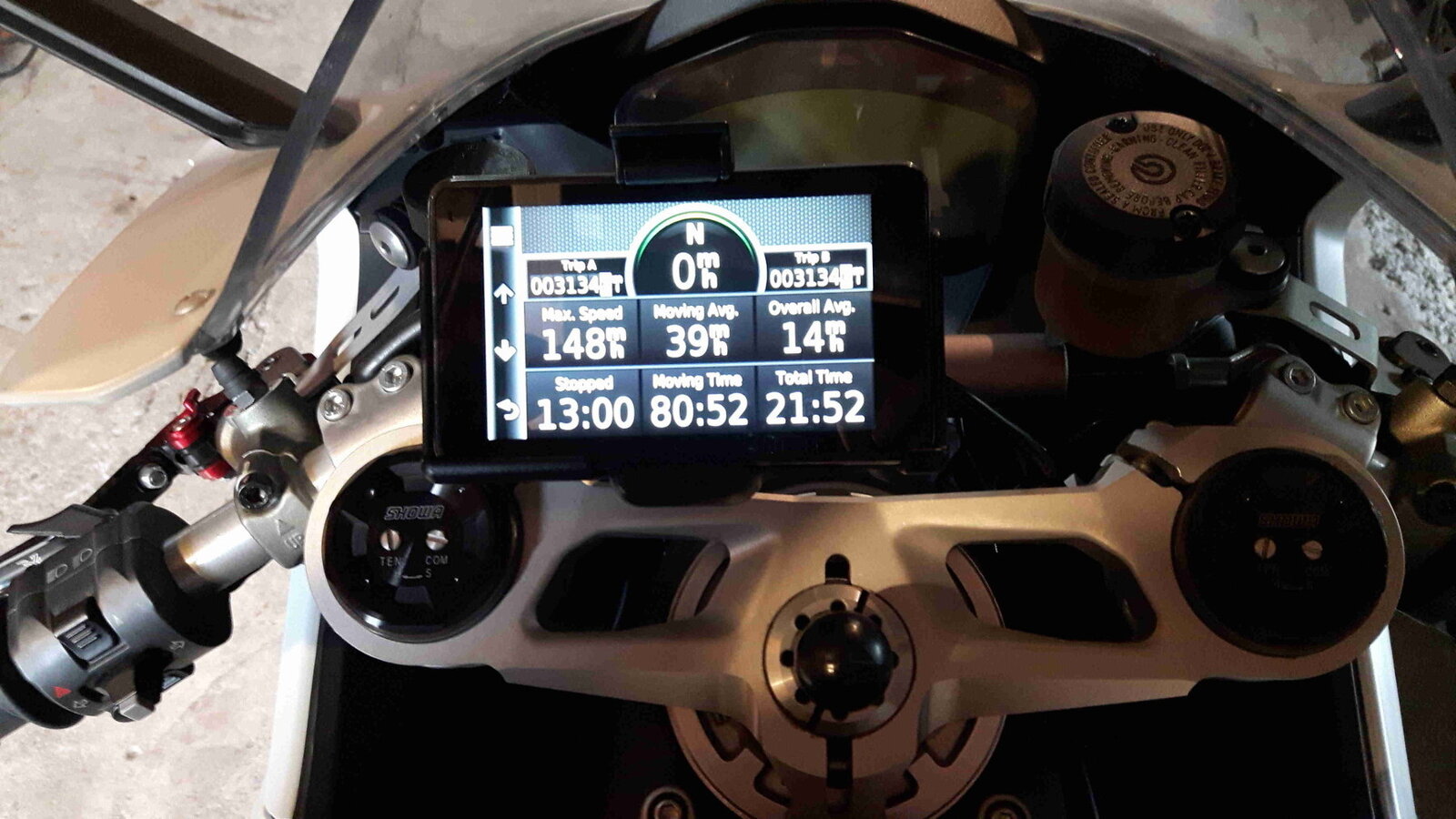

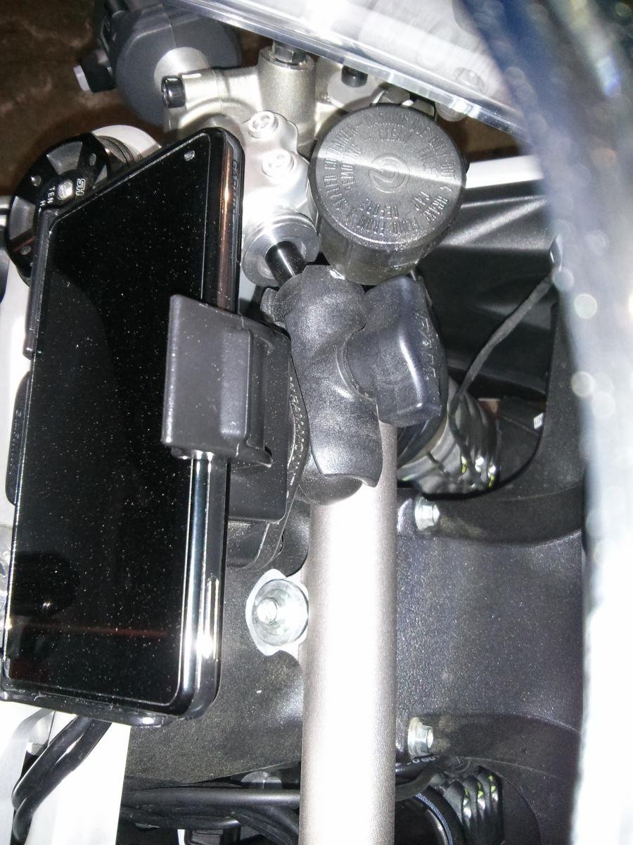

  4. Loads of room for sat nav, I’ve been running my Garmin 660 for years now on my 899, sorry the first two pictures are a bit dark, just taken them in the garage now..

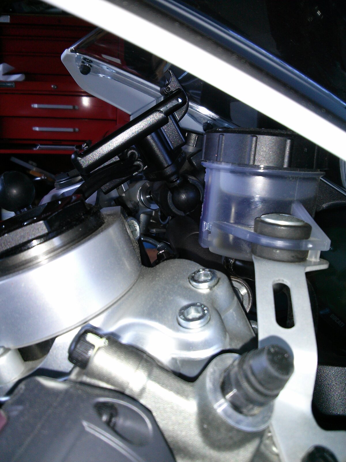

    I’ve used a custom made expanding RAM mount in the end of the lhs bar, to keep the Garmin central about the “U” shaped cutout in the top yoke, the whole lot is on a RAM mount and a quick release waterproof connector for the power lead, can be detached in a couple of minutes leaving just the RAM ball in the end of the bar.
    It’s a snug fit but doesn’t obscure the dash at all when you’re on the bike and not too close for you to focus on like some top yoke mounts.
    Sena Bluetooth helmet set and your good to go!

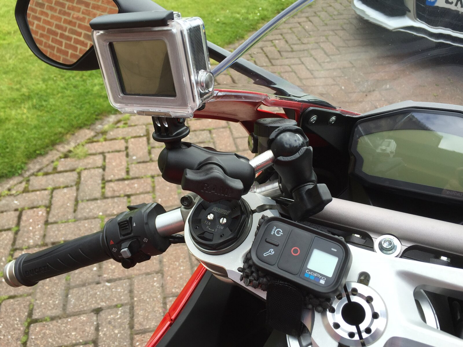

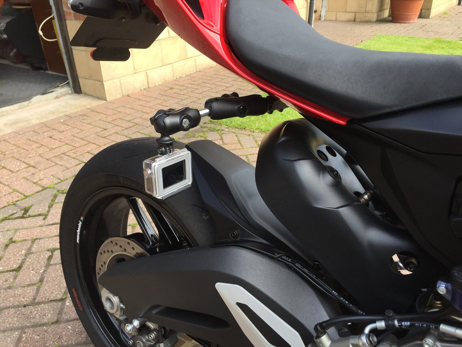

    Also doubles up just using the RAM ball on the very rare occasion when I use the Gopro on the bike....
    Forward facing..
    Rider facing, for the “sheer terror” look!
    And rearward facing so you can see who’s chasing you..
    The RAM mounts are a really sturdy and vibration free solution for me

  6. I’ve looked at this option and it certainly appeals using the computer you already have in your pocket. Did you use a toggle bolt to fit it in the headstock tube?

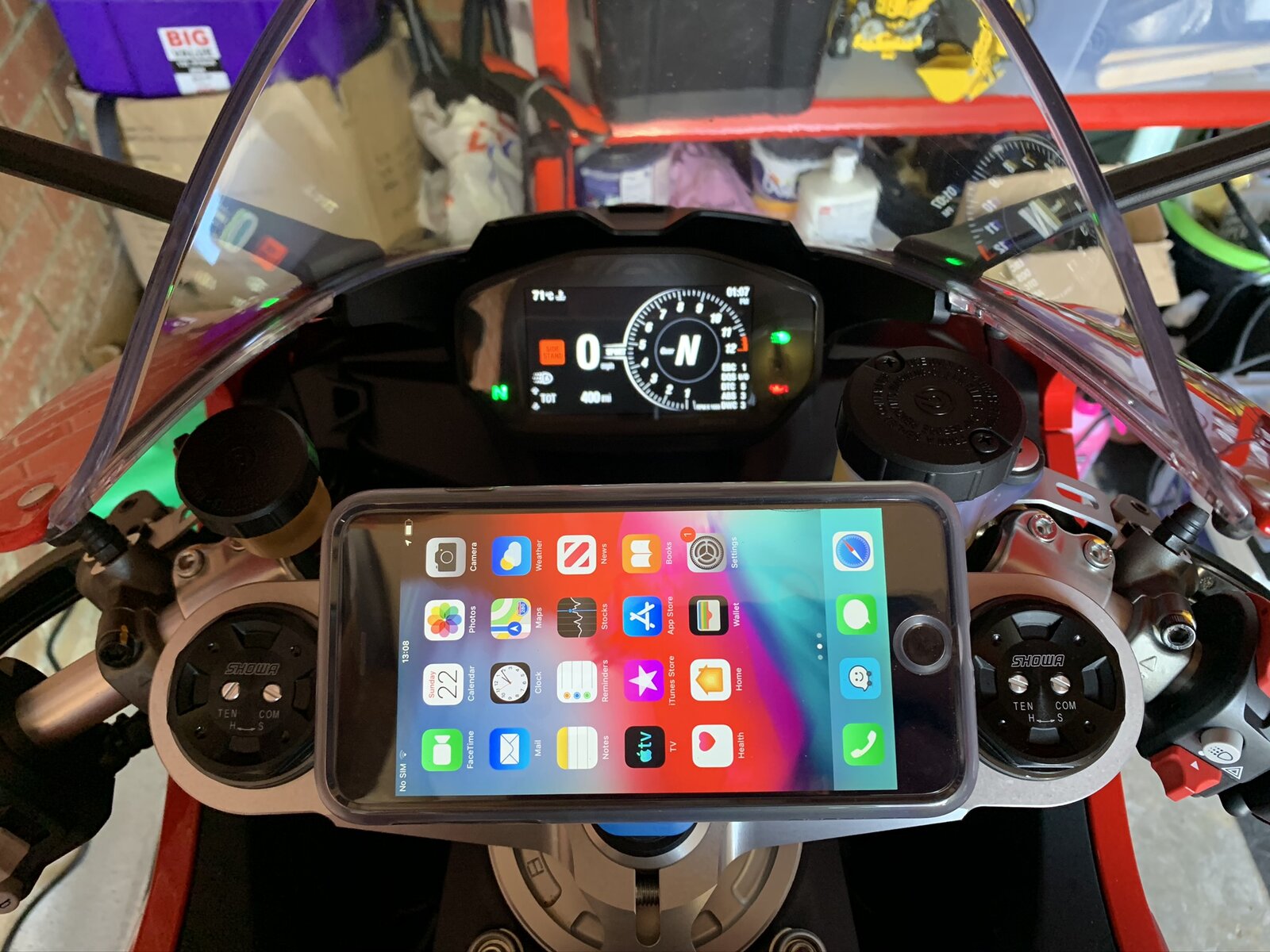

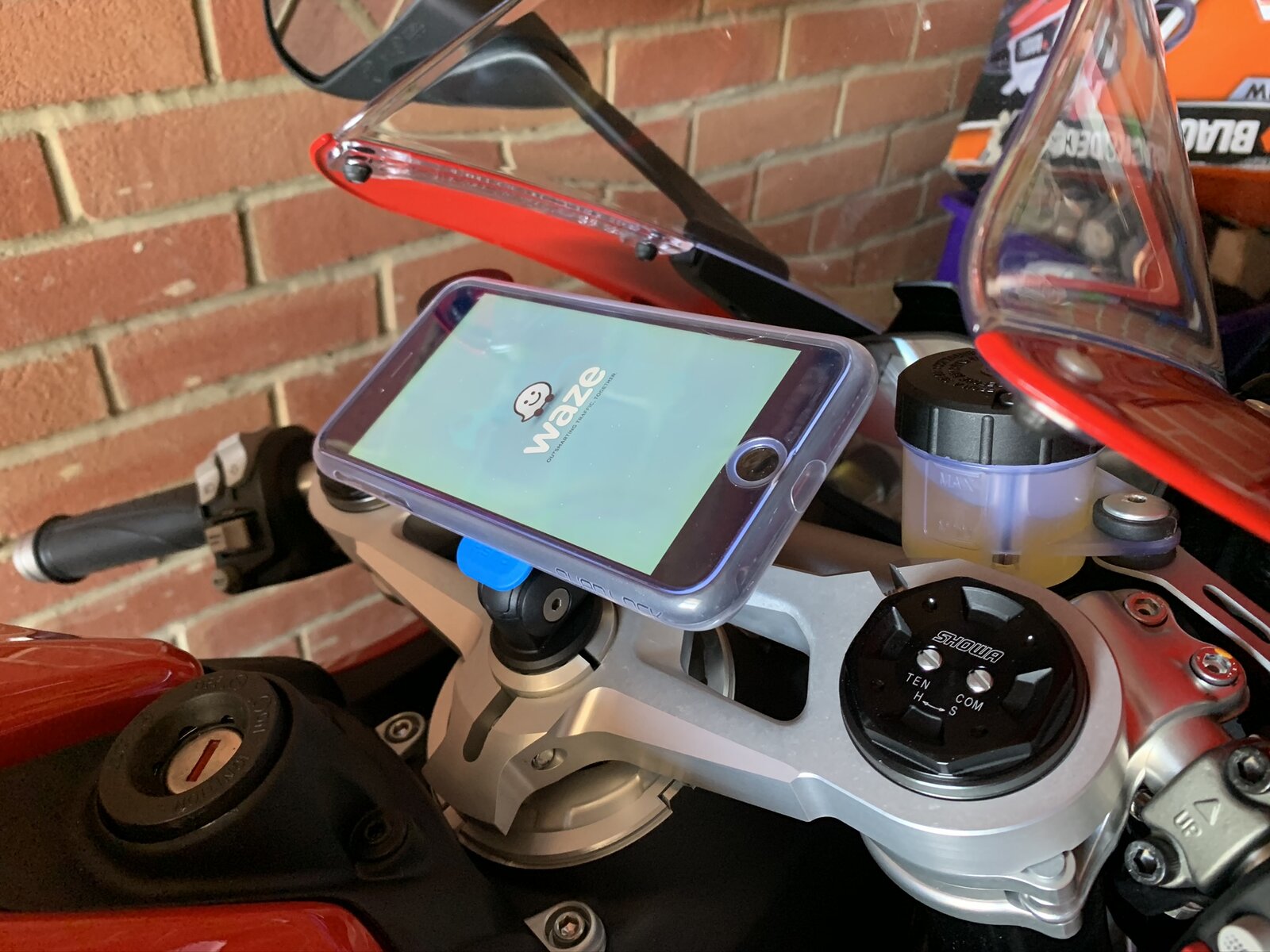

  8. +1 for quadlock although be warned if you have a newer version iPhone or Samsung. Because the mount is so incredibly stable an secure, the vibrations from the bike can actually ruin the camera stabilisation. I had mine go on my 11 Pro, luckily got Apple to repair under warranty as I took it in without the case on. Quadlock have completely confirmed the issue and have developed a damper attachment to solve the issue. Frustrating as it does ruin the sleekness somewhat but it's still a great option
  9. ive just seen that issue described by The Missenden Flyer on YouTube - it makes the beeline more attractive once you included the cost of Quadlock bracket and damper.

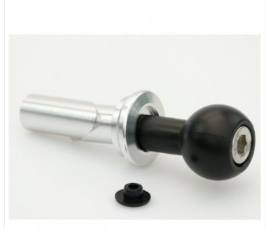

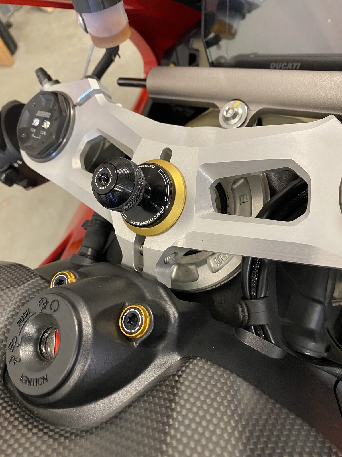

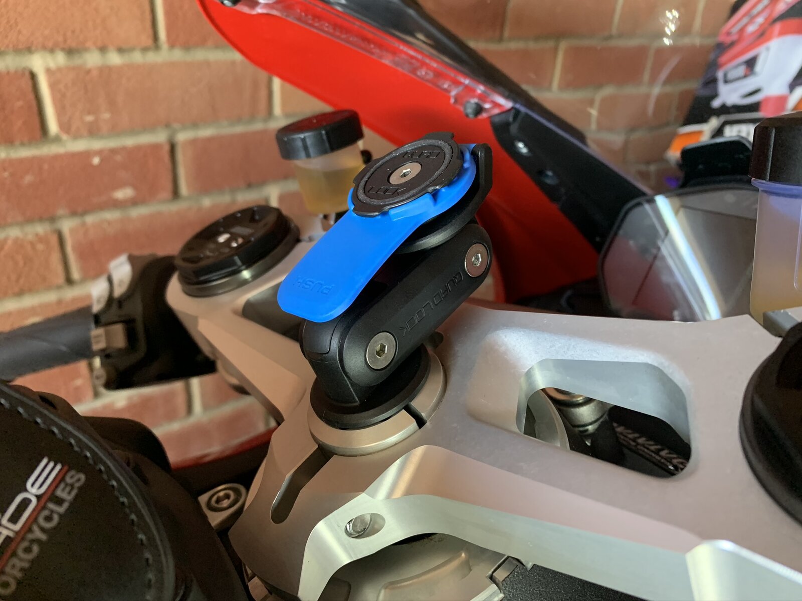

  11. I used the quadlock top but ran a bolt through with a plasterboard spring clip on the back that I could pop in an then it would expand out and grip up underneath the top face of the headbolt.
  12. What did you use to adapt the stem mount to work! I’ve seen a plastic insert that goes up from the bottom of the steering stem to make the small Quadlock stem mount parts fit or some spring loaded plasterboard load spreading fittings which looked a bit Heath Robinson but might be strong enough!
