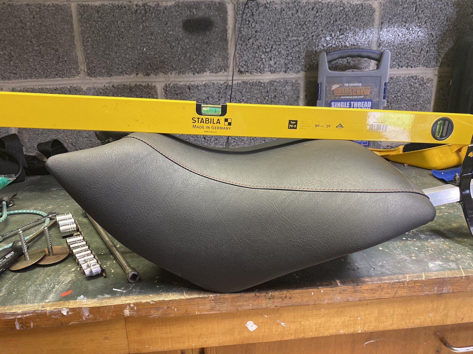

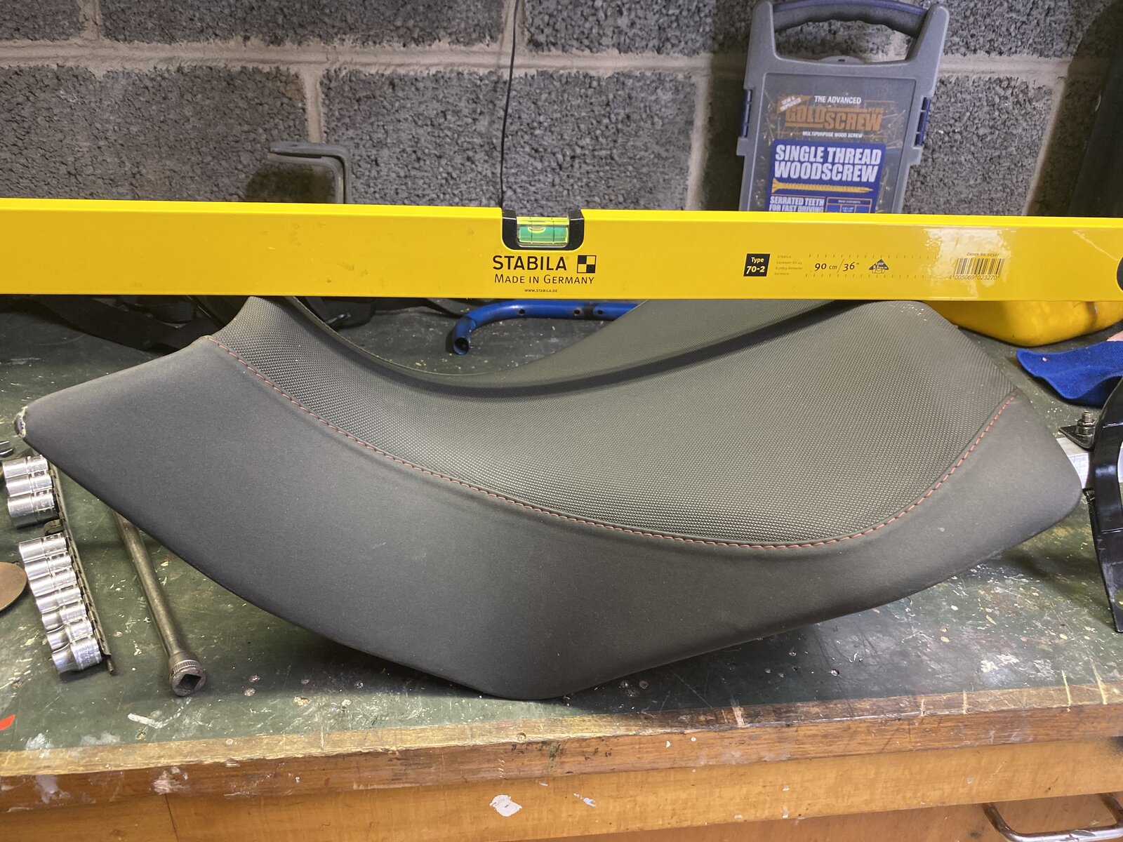

  10. I have one, i will send you some pics later. Seat is an Else made one, check out his website.
