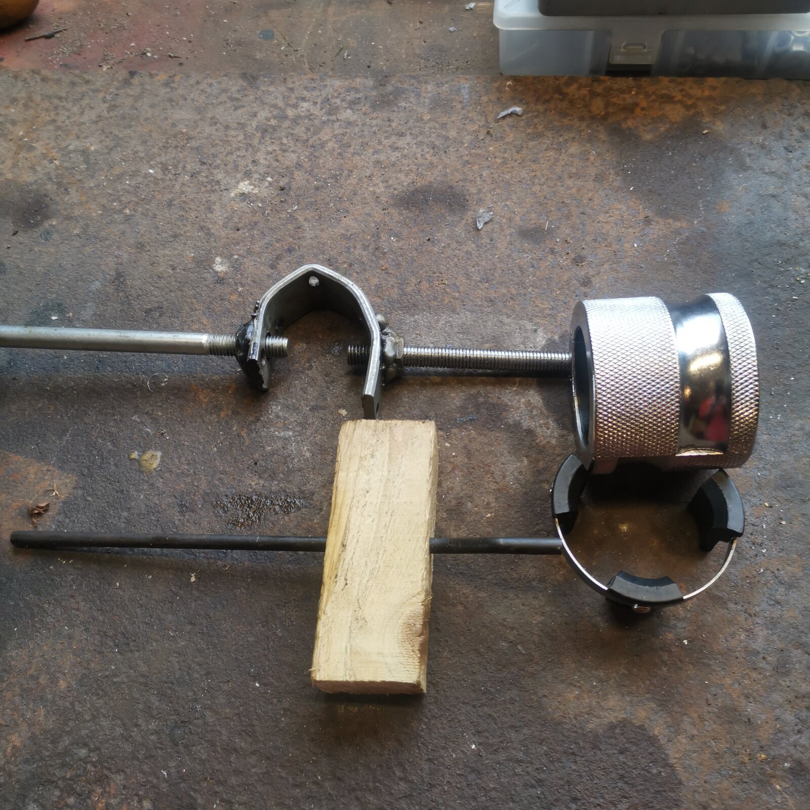

  6. I found I had to give them a right old bash with the seal driver, much more than I was comfortable with. On my first attempt I didn't drive it home far enough as I didn't want to bash it too hard, it's a bit like a slide hammer up and down the fork leg, but once I realised I needed to apply quite some force it was ok. I think..........:confused:
  7. Seal driver arrived from China yesterday£16 delivered.

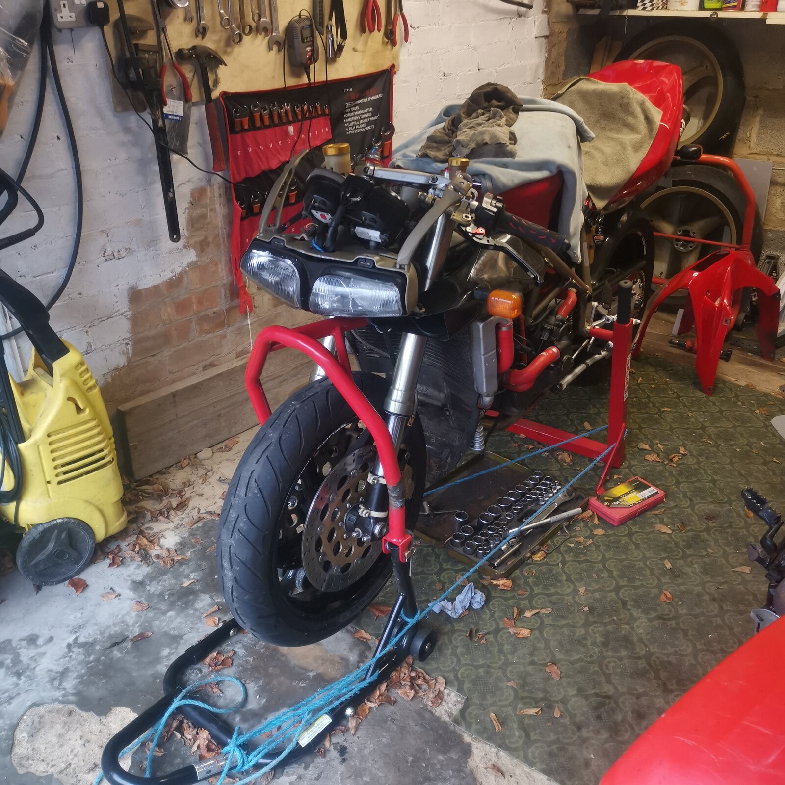

    Forks now reassembled and started refitting this morning.
    One part I made and one I purchased to make single handed disassembly and reassembly easy. I also knocked up a dip stick to measure oil height.
    Steve

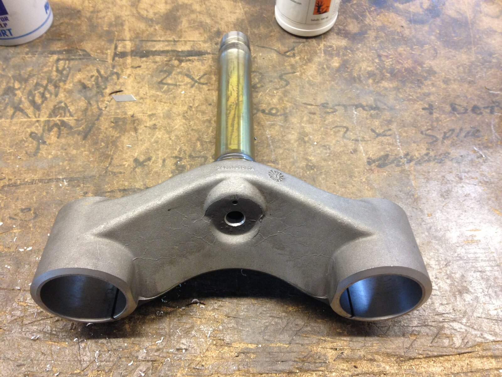

  8. My 748 doesn't have a hole for a headstock stand did your drill yours or came like on your year model?
  9. I drilled mine.
    Steve
  10. Good idea that, save a bit of hassle, Kept your original painted wheels :upyeah:
  11. Steve, could you please post a picture of the drilled hole when you take it off the stand. Just so I can see exactly where it is as it's useful. TIA
    • WTF WTF x 1
  12. It's directly below the headstock tube, central.
    Steve
  13. Not drilled into the headstock tube surely?

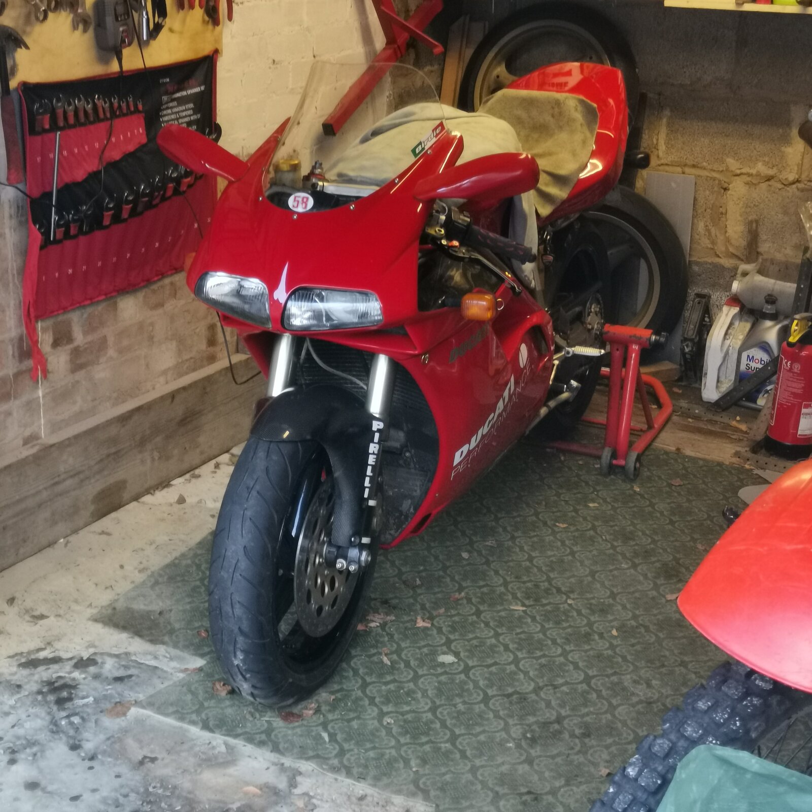

    Easier job doing the seals than I thought single handed.
    Steve

    Paul, @West Cork Paul, this where I drilled mine. 16mm or 15 hole. Got a mate to drill the hole using his lathe to keep the hole central to the steering stem.
    • Thanks Thanks x 2
  16. Thanks Ian, perfect:upyeah:
