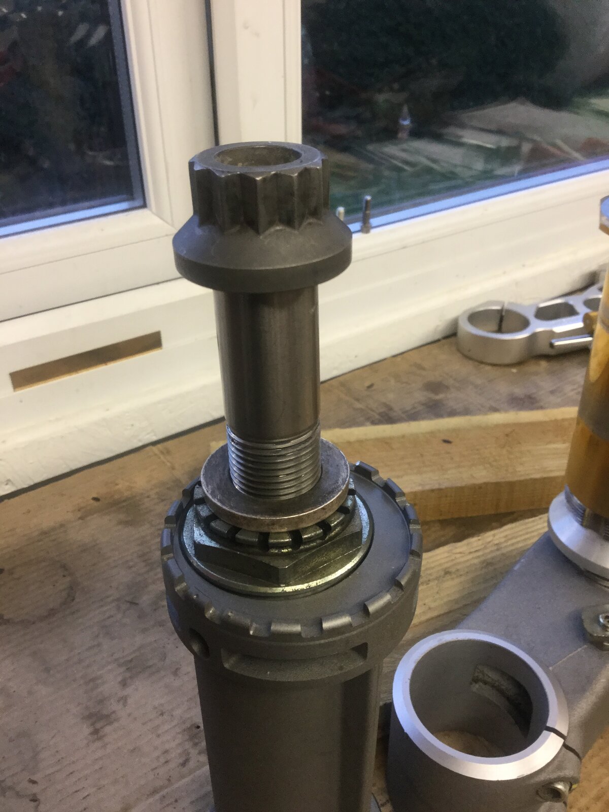

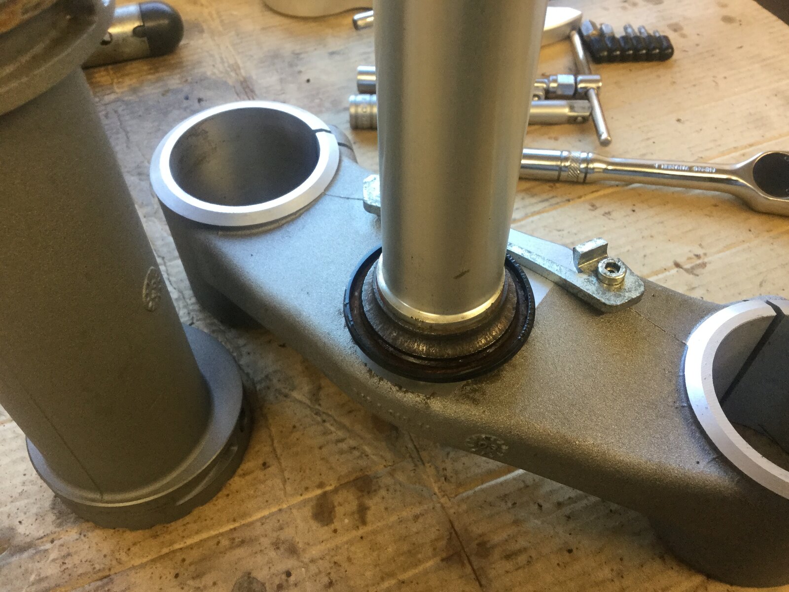

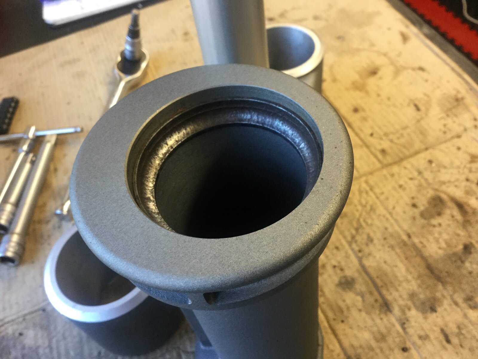

    Spookily, the headstock adjuster tube was beautifully greased and slid out just fine.
    Dunno what the bike was exposed to in the past that caused such nasty corrosion in the lower bearing...somebody poured saline solution down the headstock??
    93026FE9-A6B1-430A-AFEE-716AD17AD384.jpeg 94BFC754-1E9F-4F5B-8241-D3595F1FEDB0.jpeg
  4. You definitely need to get those off. As said by others can be a pillock. When putting new on I always heat the ring as andy says they are interference fit. Looks to me like the bike has had a lot of jet wash cleans.
  5. Those foaming cleaners often contain salts and solvents. For the same reason as you put salt in your dishwasher.
  6. I got the inner race off the stem and also the outer races out of the eccentric tube. Wasn’t such a pain, just needed to rummage about for a suitable ally drift to gently tap them out/off.
