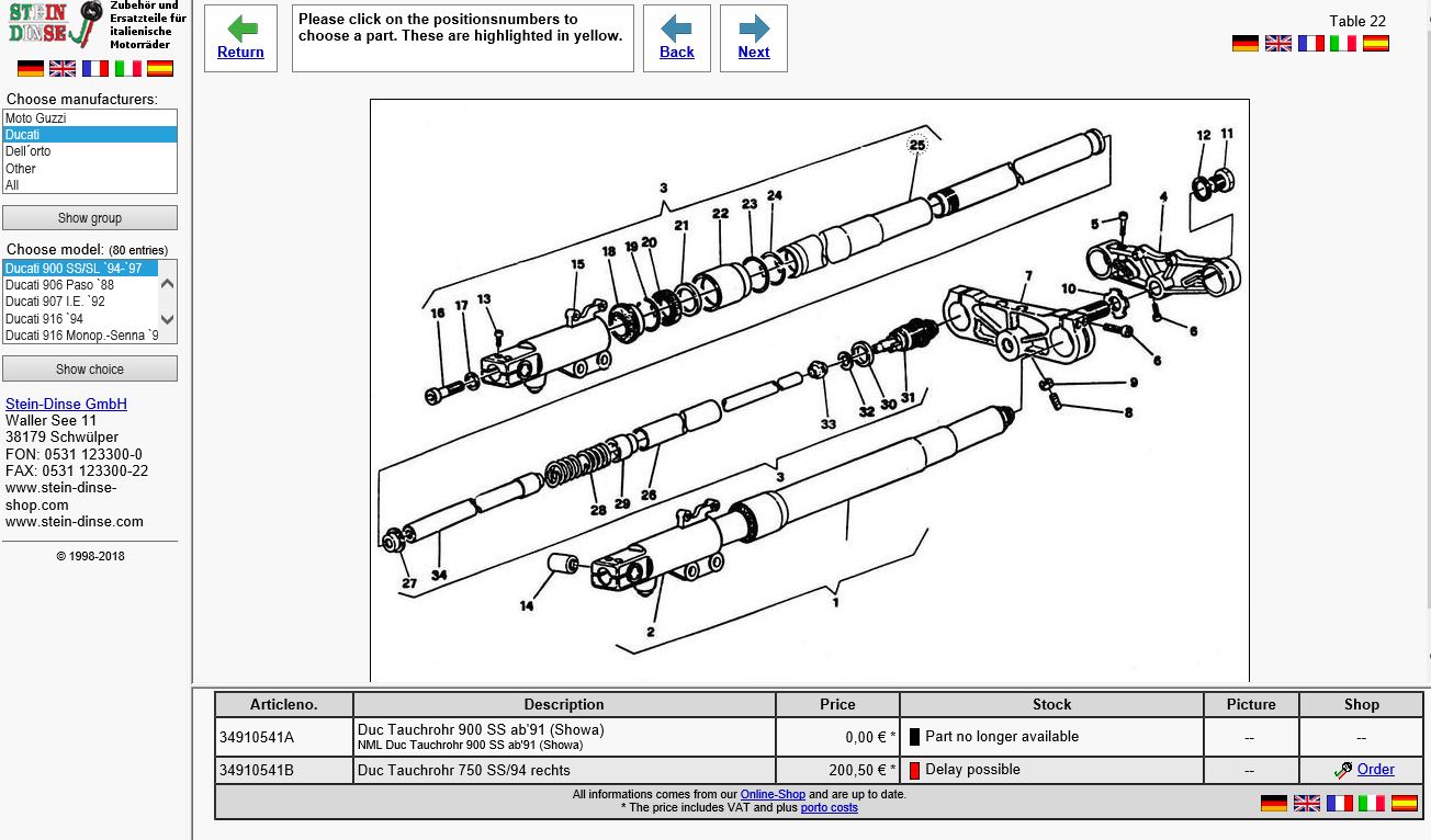

  18. Mind I ask a question on forks (not meaning to hijack)?
    Is it possible to replace the gold outers, mine have bad wear indentations from cable rub. If so, how much would it cost?
  19. Same on mine, it's character
  20. Another of that club here I'm afraid.
    It would appear #25 (34910541A) could no longer be available, so a search for a good used set looks like your best bet.
    Nasher
