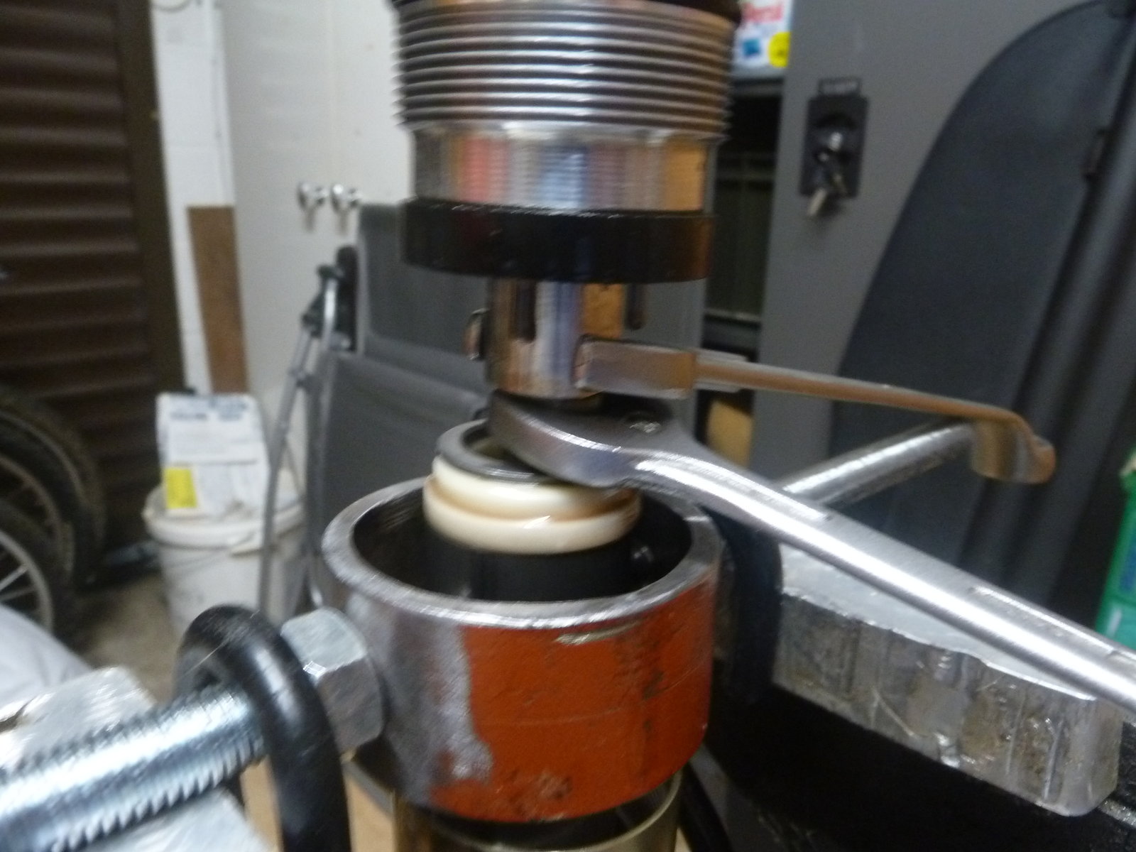

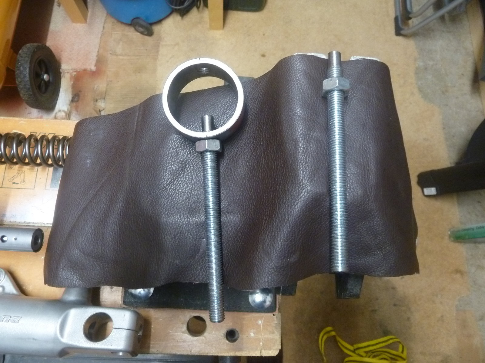

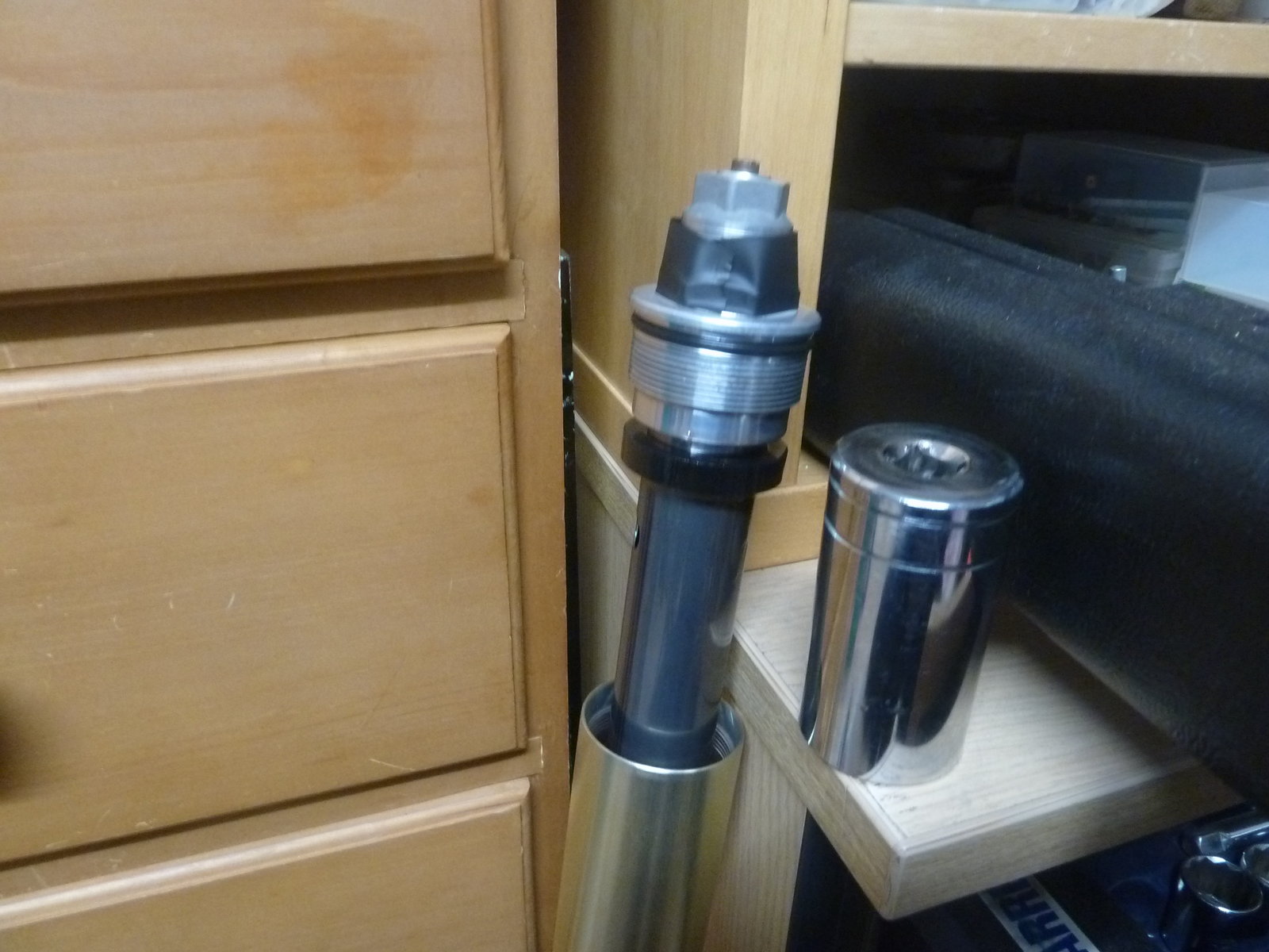

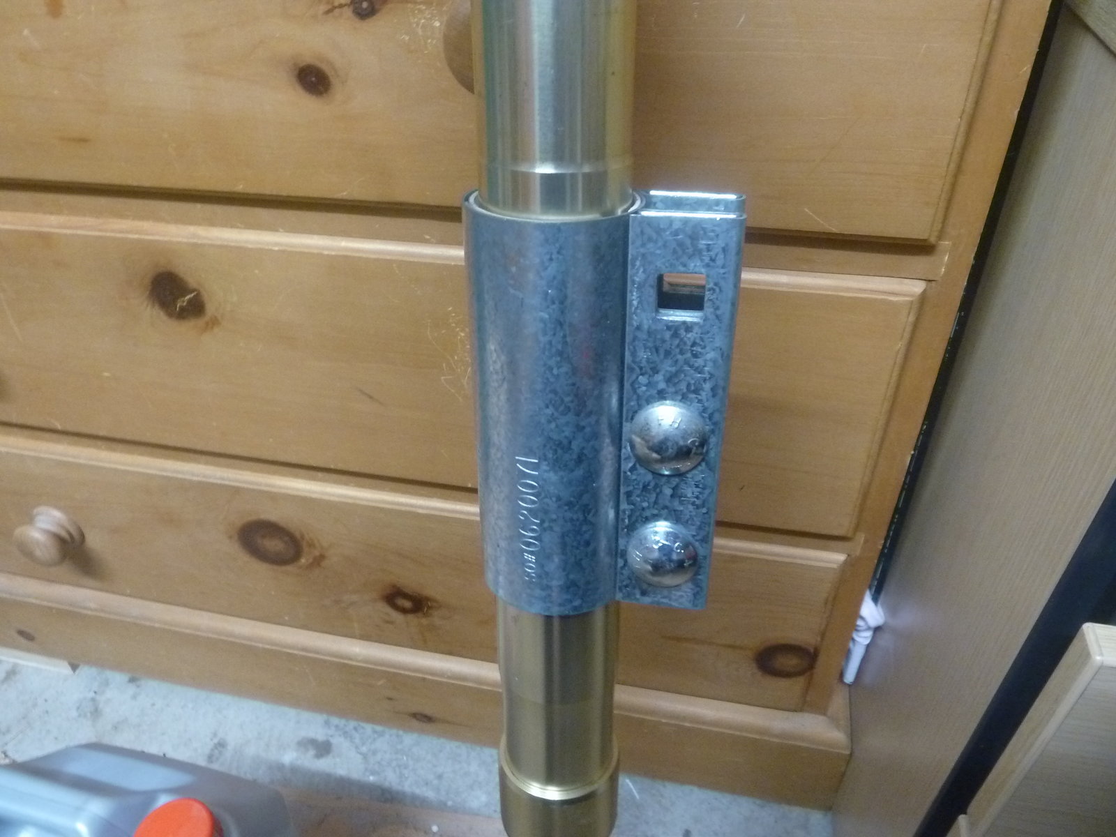

    2" pipe coupling to hold. Thought I had loosend while on bike but obviously not. P1040800.JPG
    Home made tool. 2" pipe 60.3 std sched 3,9 wall nicely fits over top of forks. M12 threaded rod ground to bottom of threads just fits in holes. Was going to weld nuts but could not fine any black ones but it seemed strong enough with the nut just nipped up P1040802.JPG
    14mm / 17mm spanner P1040806.JPG

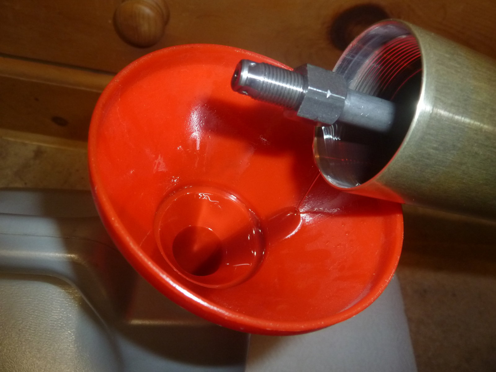

    Oil looks clean enough.
    Cheers Gaz

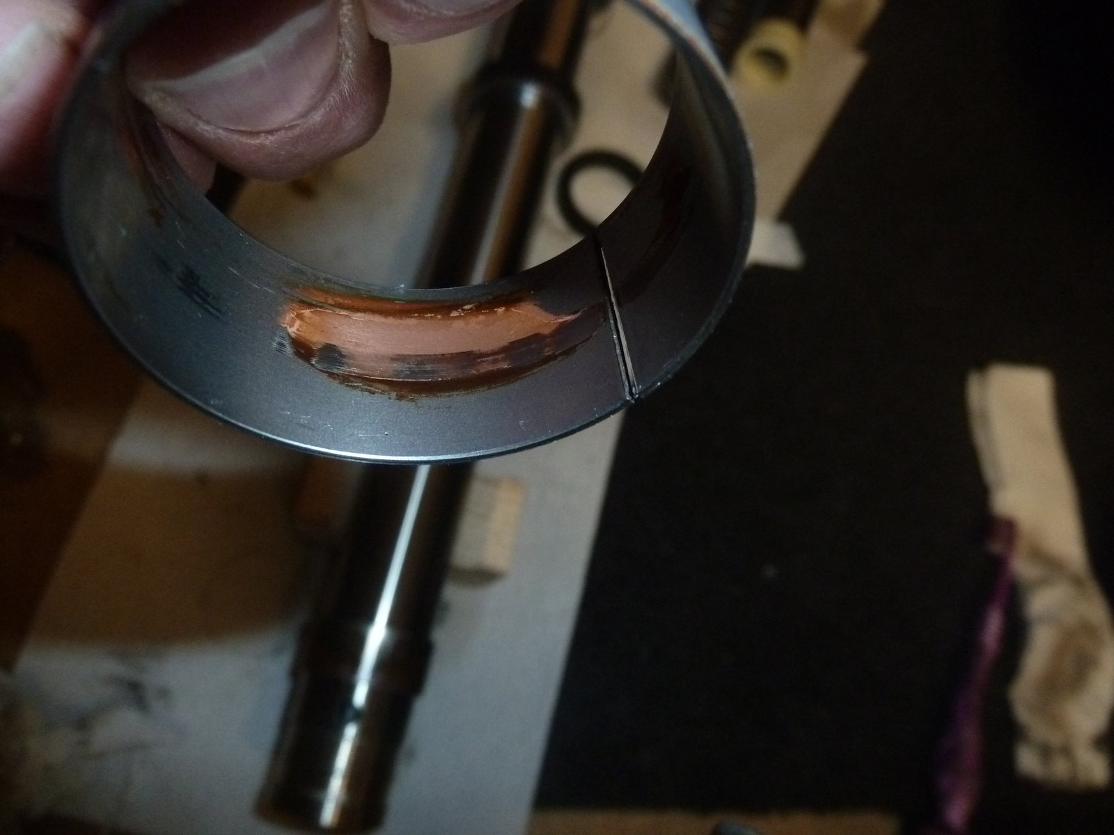

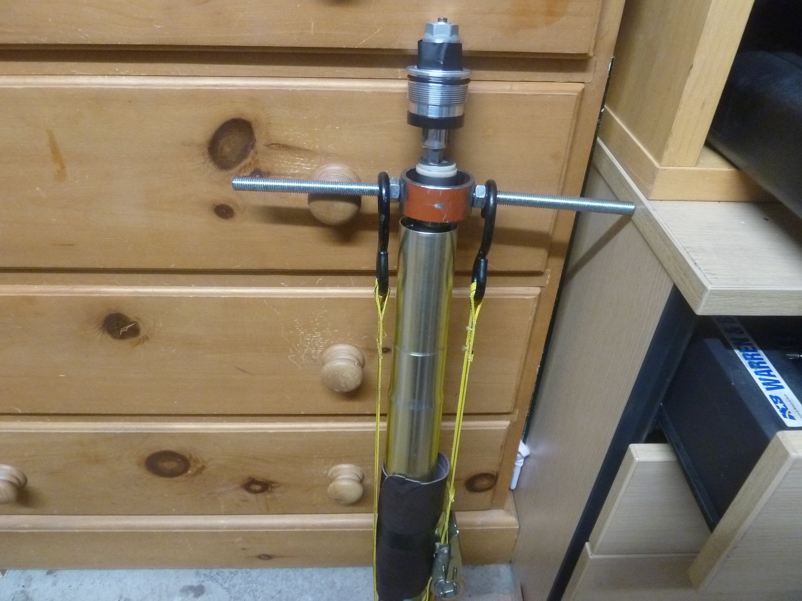

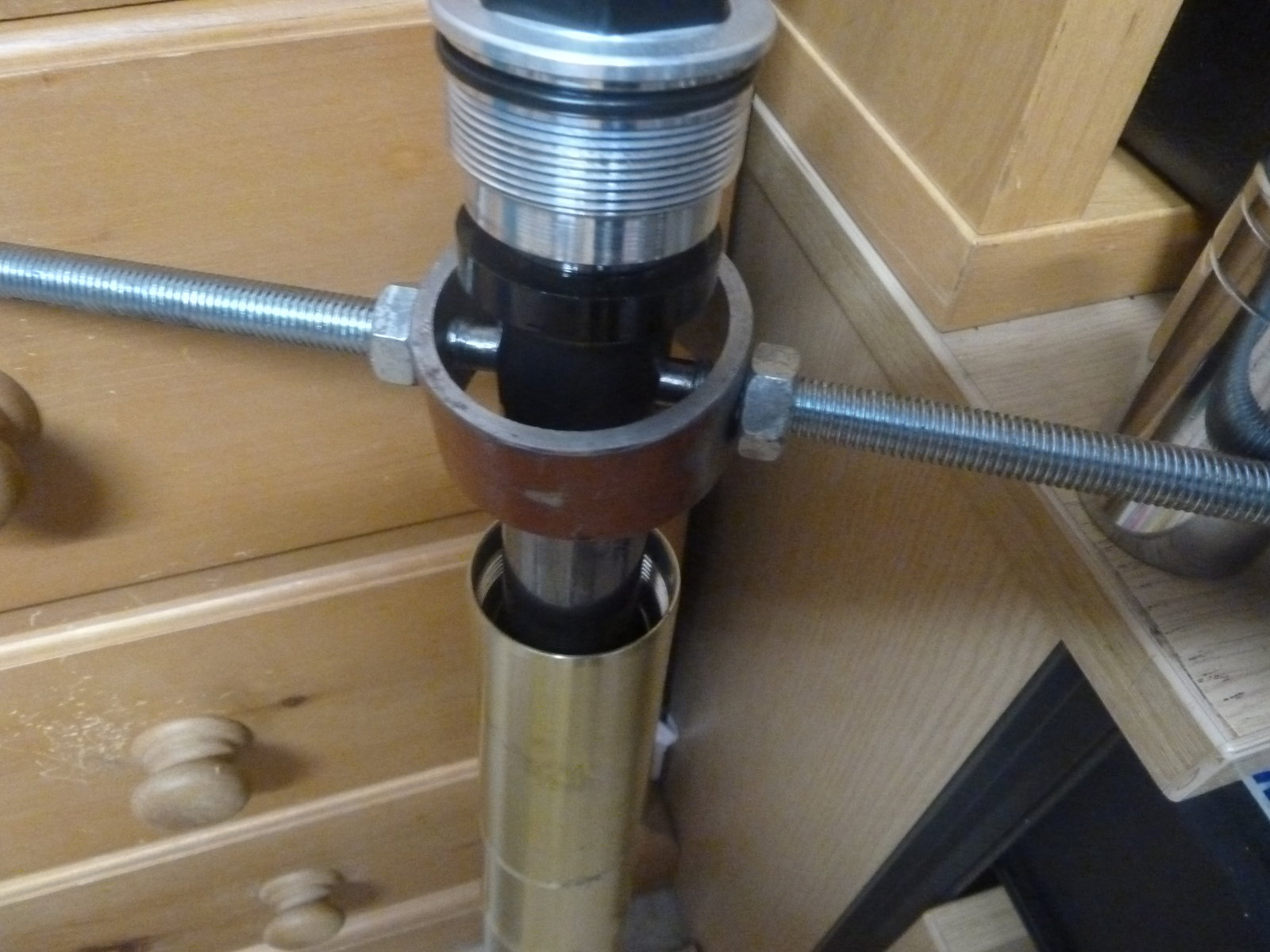

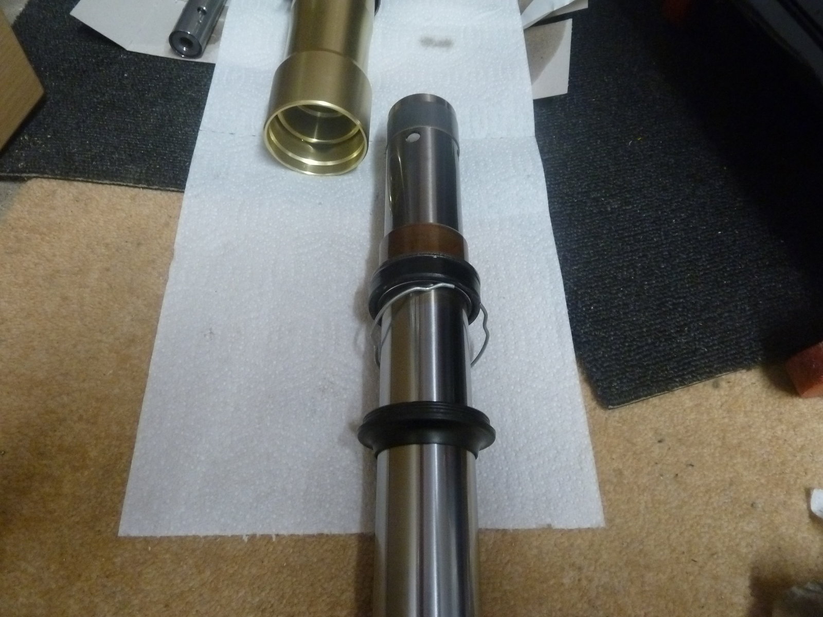

  3. Few more pics. Proof I am changing seals.

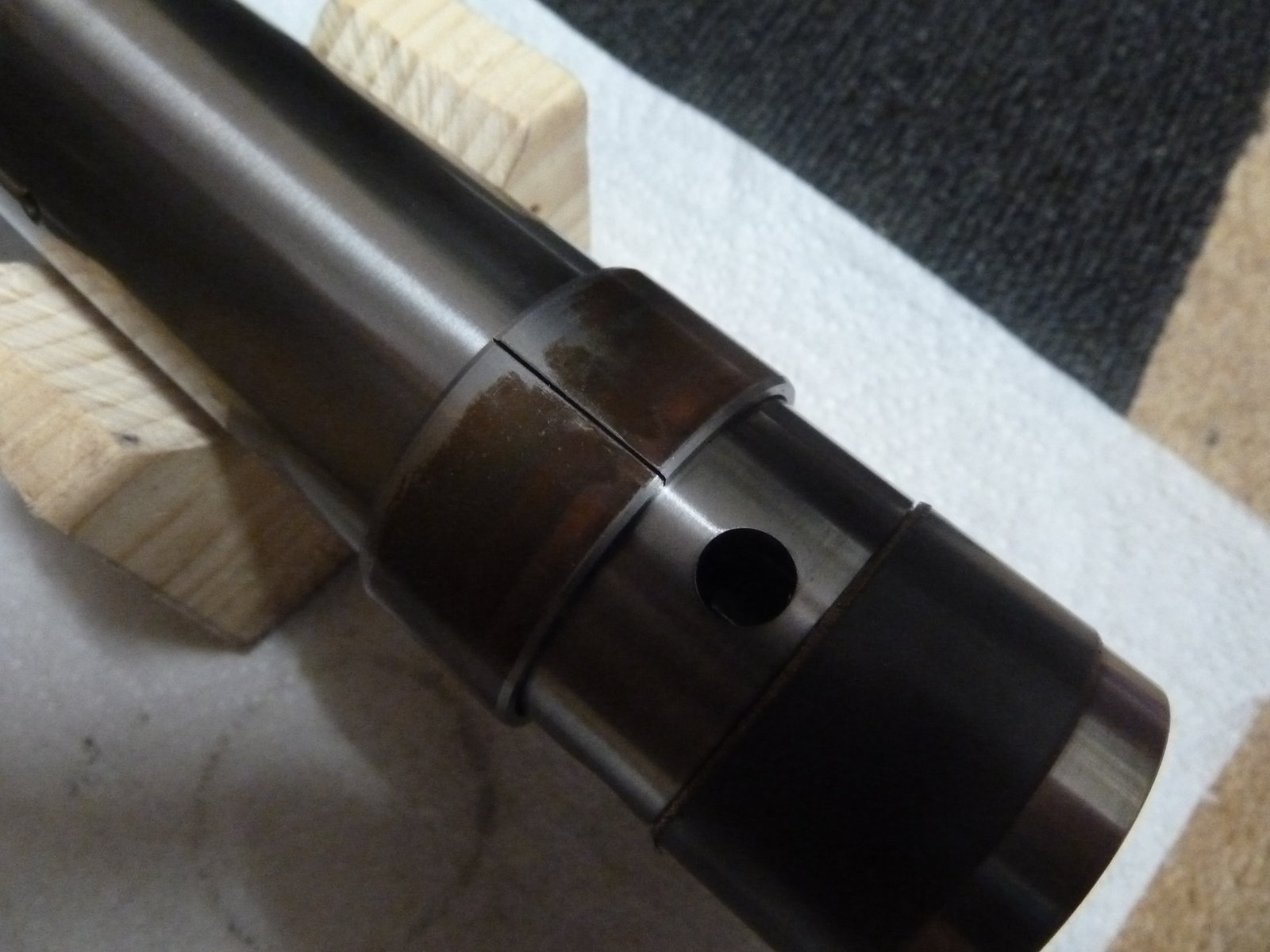

    A couple of tentative pulls and 3 forcefull pulls and the seal came out.
    There are holes in the shaft so would tape up to stop the seals being nicked on installation as they pass over hole.
    Might give these a go, double seal back to back.

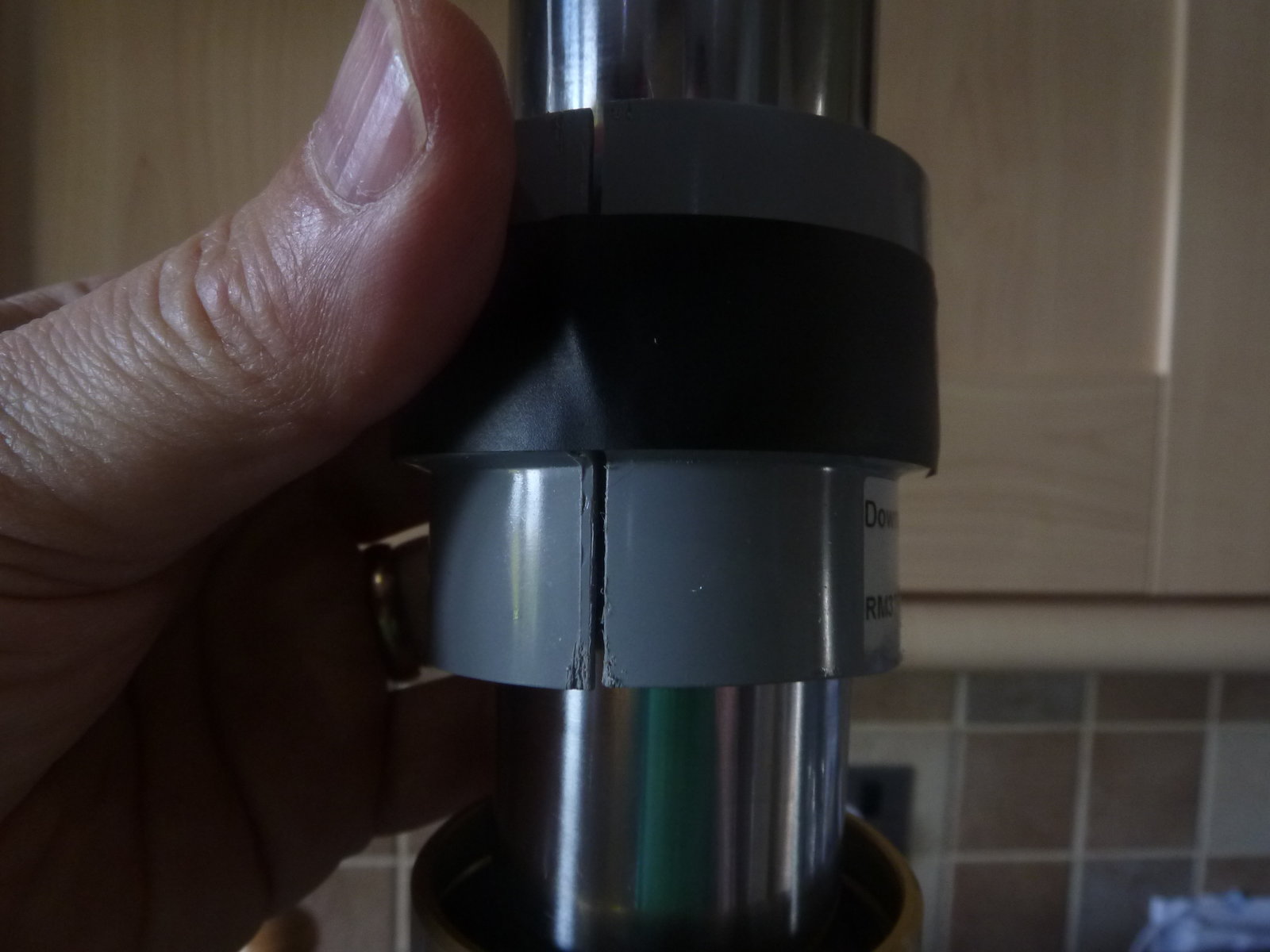

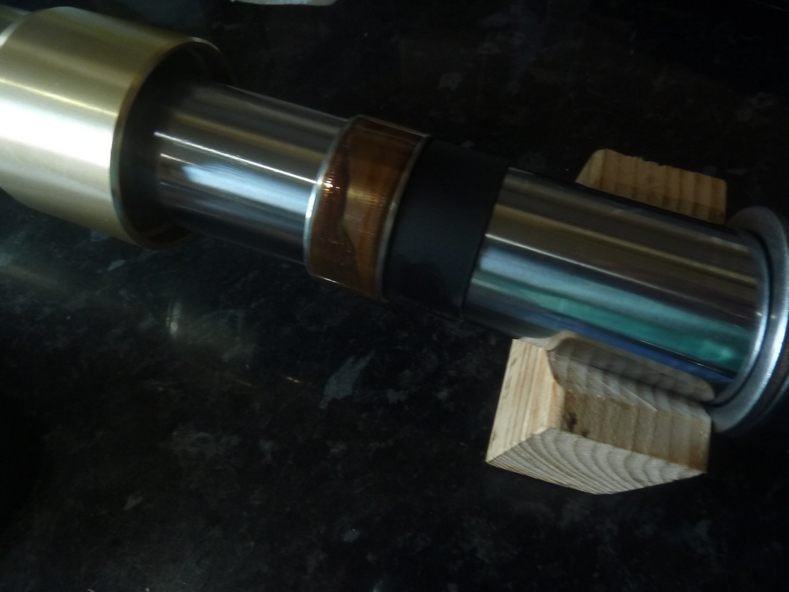

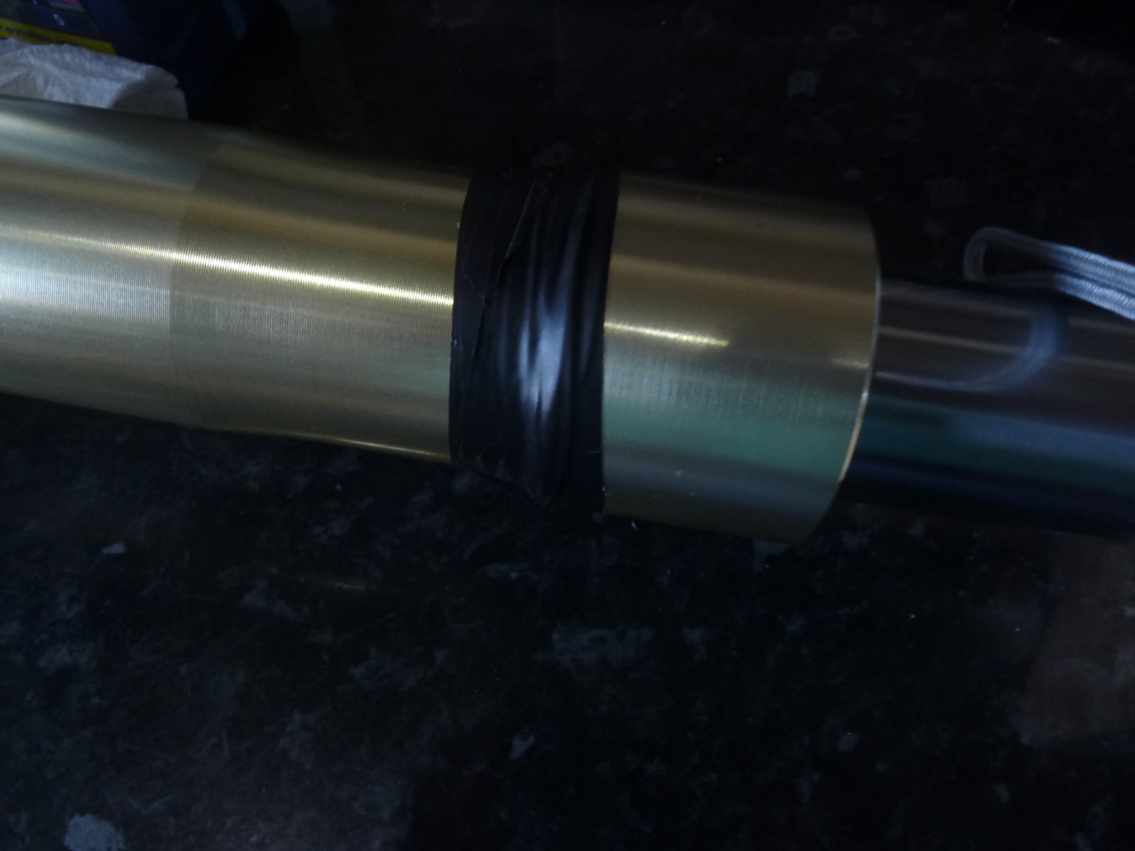

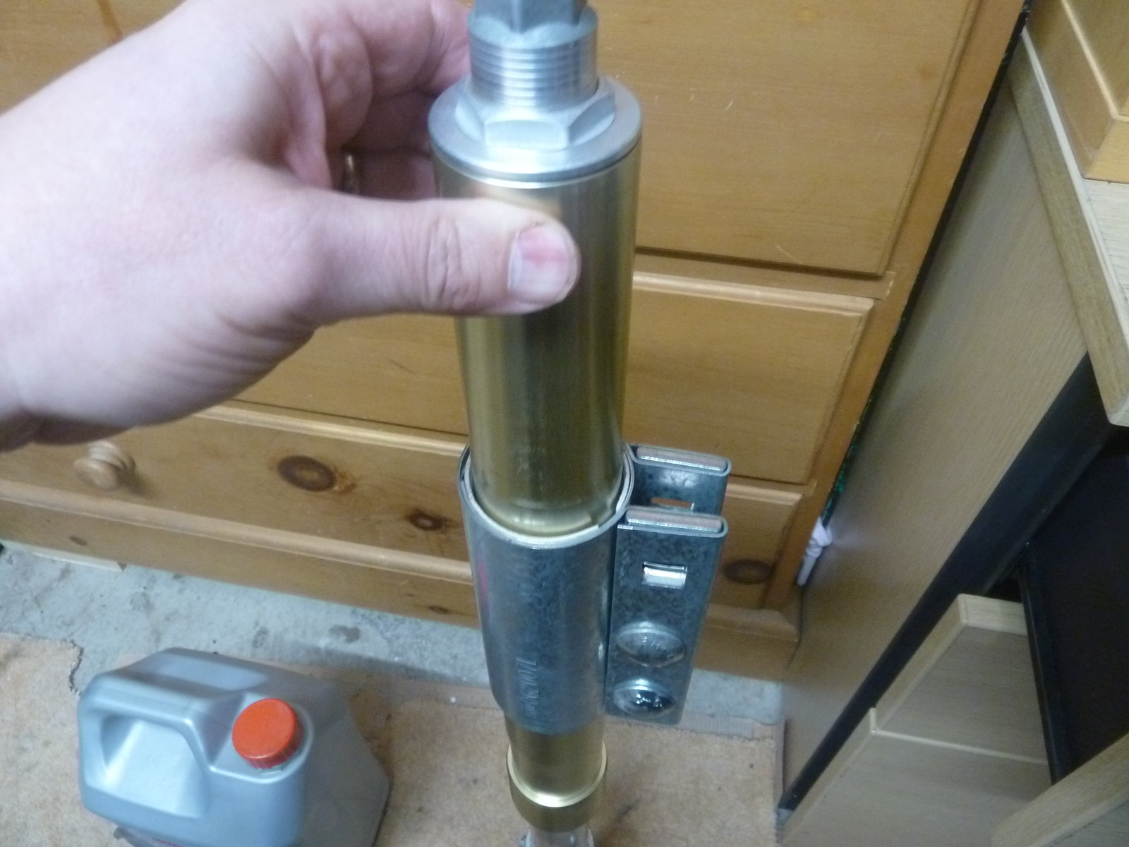

  6. Putting back together. Tape up under seal housing as this can move down when you are putting the seal, this did leave me scratching my head for a while wondering what had happened as I thought it was screwed but its not and just butts up to a snap ring.
    I found a trick on the internet with tape. wrap it round as square as you can, I used this to knock the top bush in (I suppose if you build it up you could do the seal but would be better pushing it in further to the outside) P1040842.JPG
    The seal went in pretty easy and I used a drain pipe connector from B&Q split in two just to push it down (packing it out in the middle helps a bit), so saved £30 on a seal driver. Oh yeh the wife was out and I did it in the kitchen, it was warmer in there.
