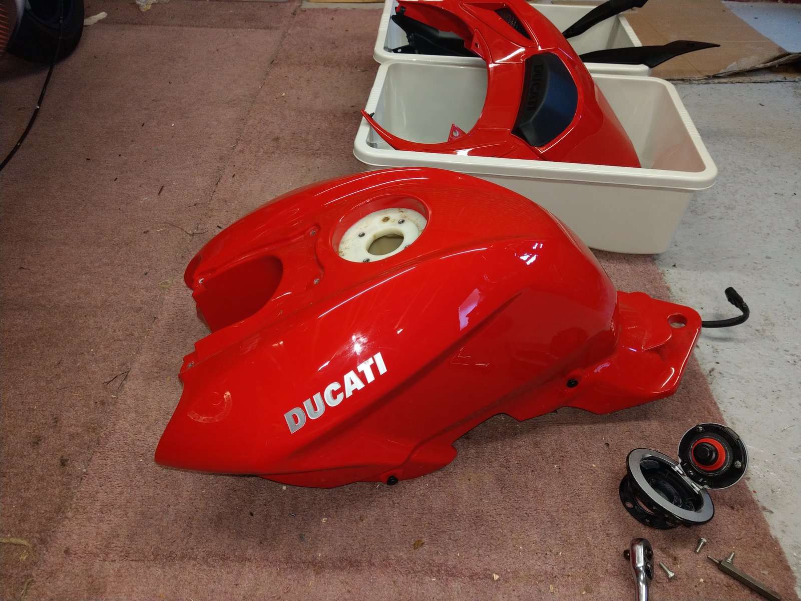

  1. Another chunk of expensive plastic..... Lucky for me its not badly affected by ethanol and to be honest the fuel in the tank didn't smell at all like petrol. It's maybe 4 years old ?

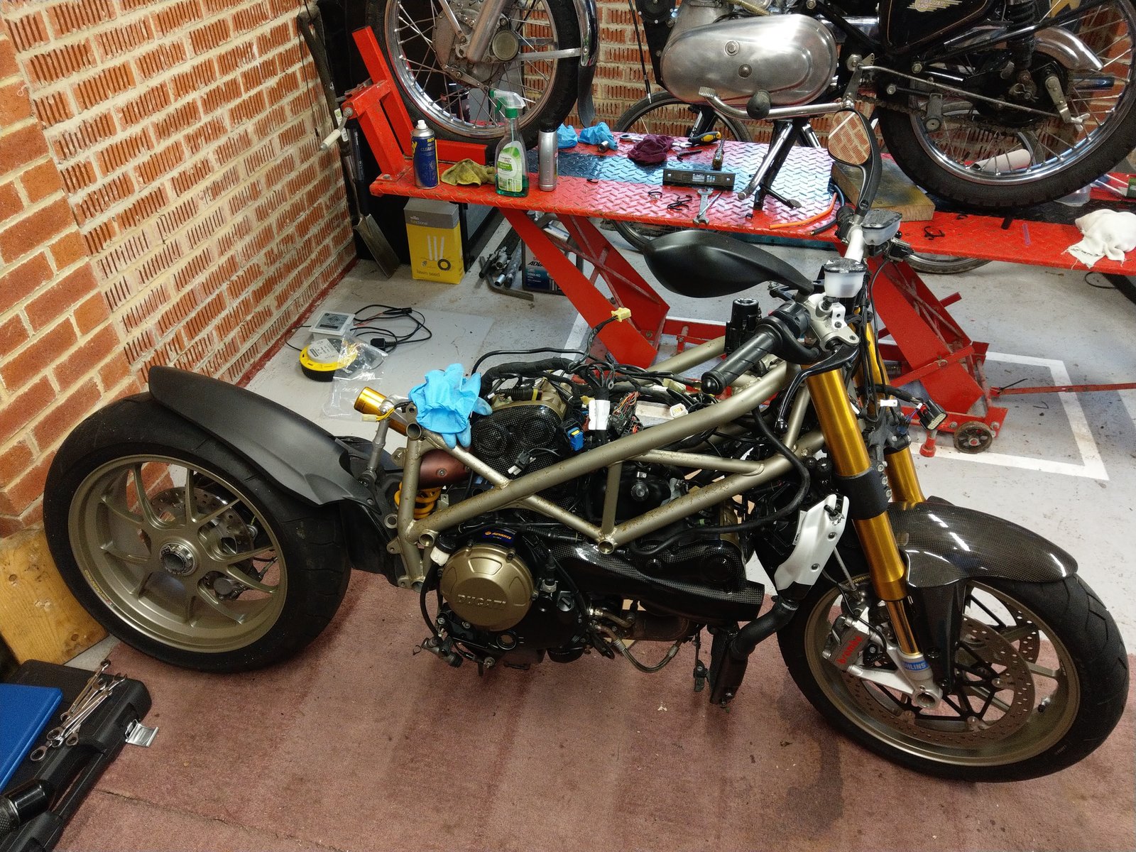

  4. The weather was unreal here in the North East so my full day on the bike turned out the be the whole afternoon at Whitby.... I did manage to get some work on the bike completed.
    The bike is looking uber naked now (even for a naked bike)

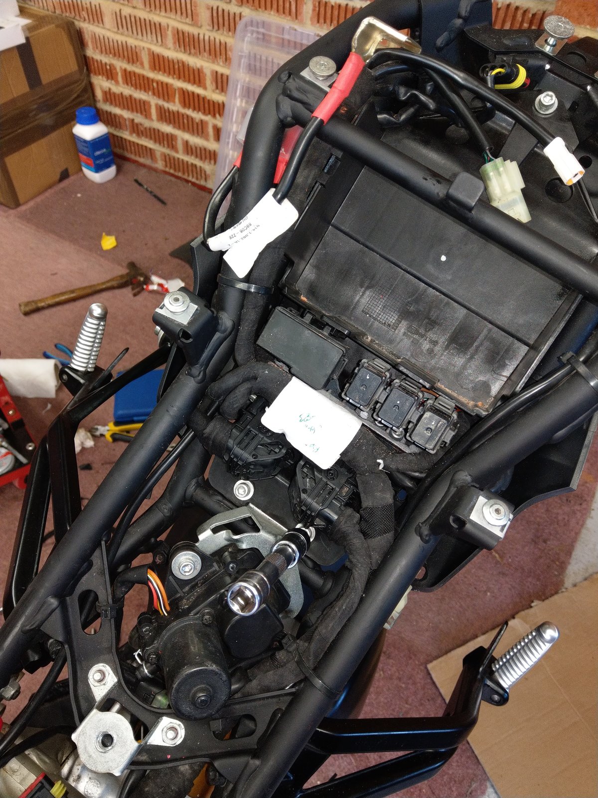

    Along the way I had a lot of fun getting the exhaust valve cable and holder off.
    I am thinking the ignition key I can remove using the two nut method (back one into the other and then spin it out)
    As the wiring goes over the top of the frame and up to the sub frame it looks like that is going to be a bit of a mare.
    What would be your next step, Forks out, or Swing Arm ?
  5. Nice bike !! Looks like your enjoying it. If you have a rear paddock stand then its front end off first - just make sure its well supported. I use multiple rachet straps from roof joistswhen getting down this far. Best of luck
  6. Thanks.... Yeah it's not really a chore to be honest. I don't have a paddock stand yet so I will jam the rear wheel in my bike lift and do exactly as you described...
    I needed to do a lot more electrical work today than I had hoped but it's all free now and I have plenty of pictures to help with reassembly ..... I Hope

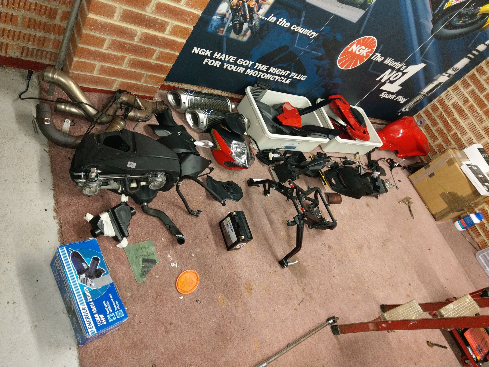

  7. Ok no at start of play time this morning I have only to take the front and rear off...
    Should be fun.
    Had a lot of fun and games getting the electrical stuff off the sub frame
    A lot of work but it's going to be worth it

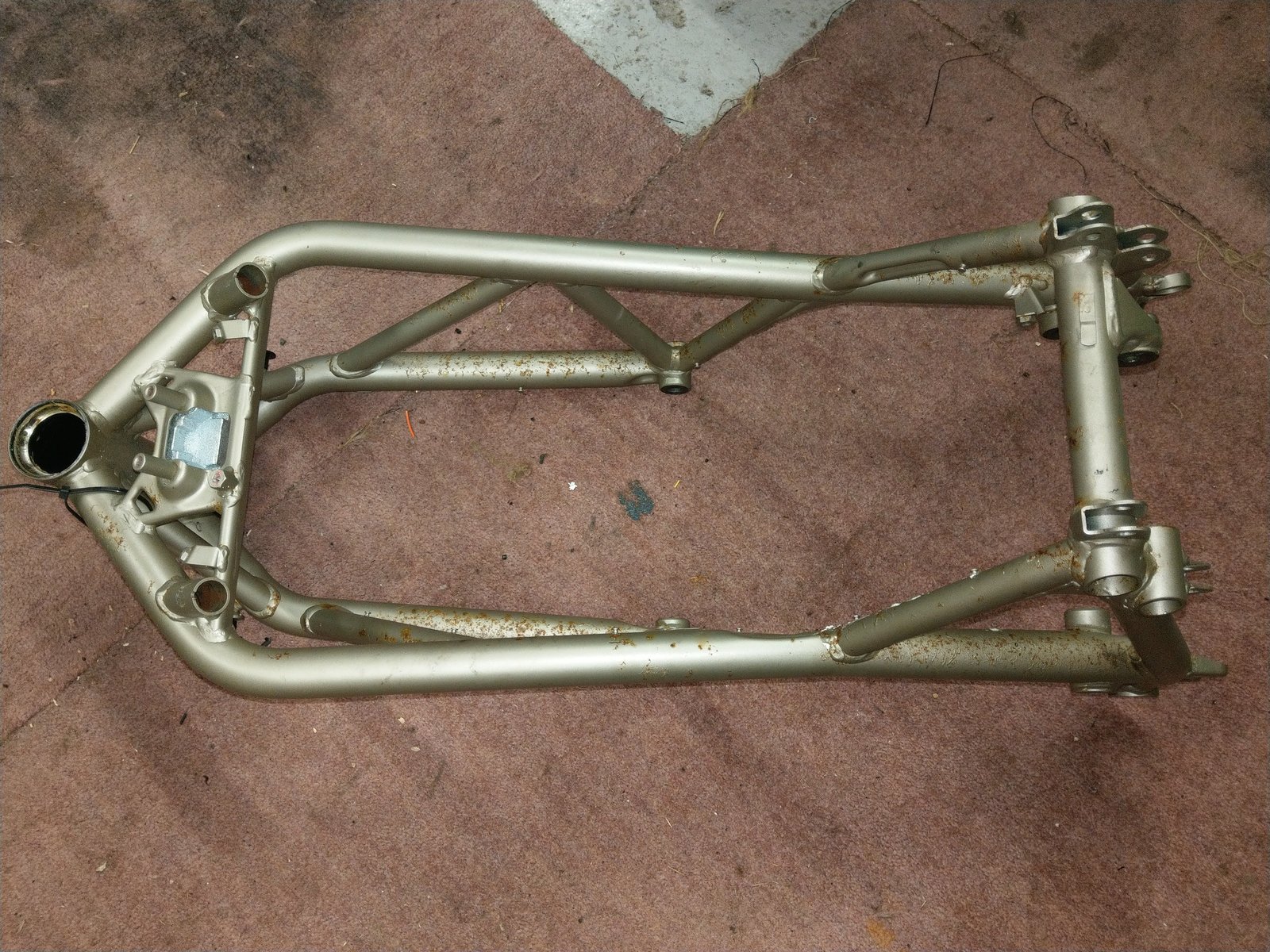

  8. Ducati Frame Refinish Part 1 Complete

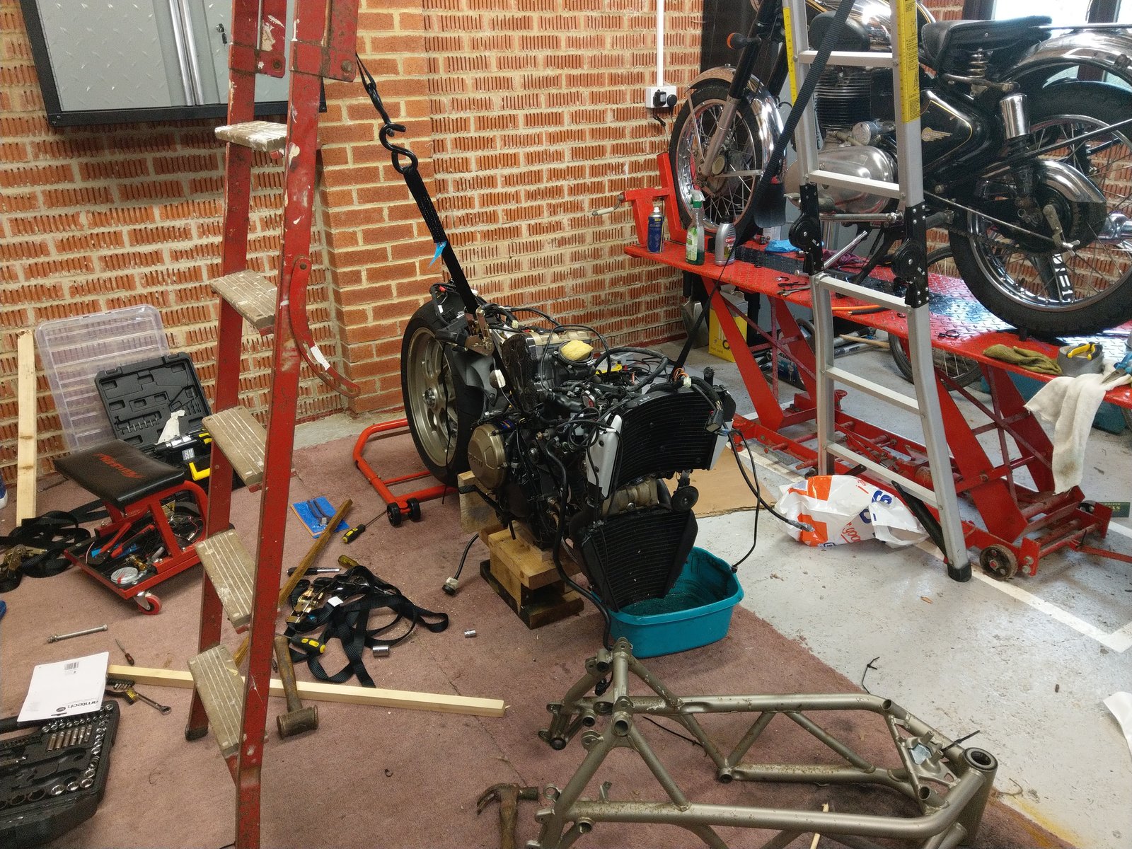

    I Popped up to The Ducati dealer on Newcastle and bought a paddock stand, i don't use them on my other bikes as I have an Ultipro but there was no way it was going to be possible without a wheel chock or the stand.
    This was my setup:
    I Red-necked an engine stand from some timber i had in the shed and then slung the front cylinder between my two step ladder's
    Worked a treat, I popped the swing arm pin back in and its plenty stable for a week or two..
    All in all in think it was about 11 hours work over two and a half days...
    I imagine it will be a lot quicker going back once I have the frame in situ.

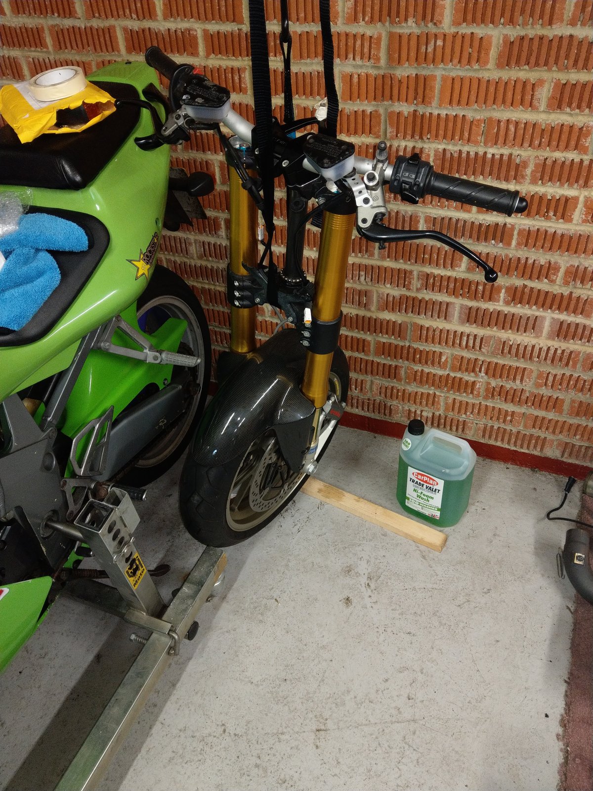

  9. I found a quiet place for the front end
    It's a good job I have a good sized garage.as this lots all over the place.
    • Dislike Dislike x 1
  10. Excellent - it just needs to be stable as you say. The problem with paddock stands when doing this amount of dismantling is that you can only use them for a short amount of time - ie a front one becomess a hindrance once you want to remove the yokes - good luck

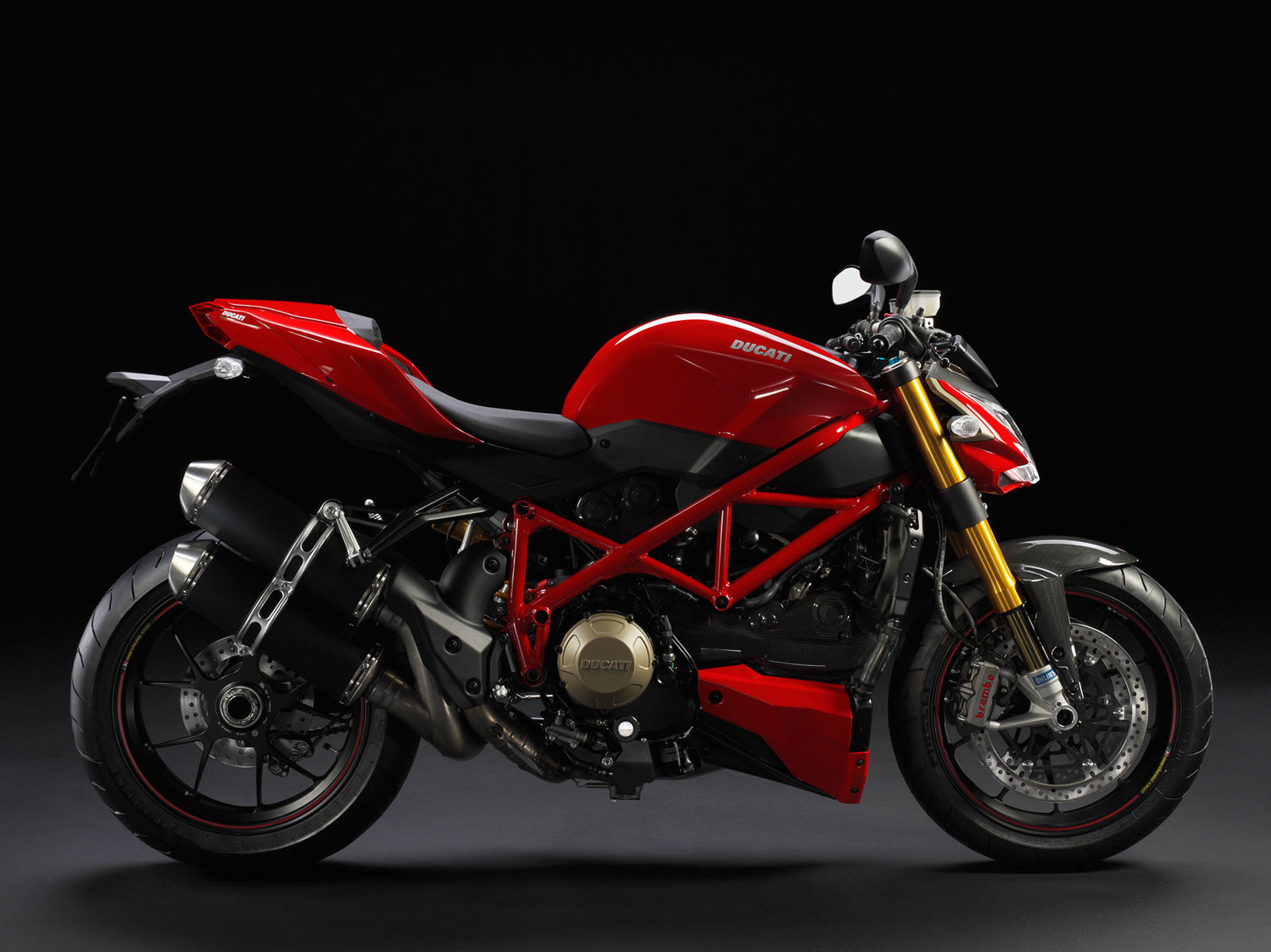

  16. Doubt you will match the gold anywhere near and it will look very odd - paint it as original if your not changing the colour :thinkingface:
  17. Personally, I'd go for Ducati Anniversary Red. It's not the correct colour for the year, but you have photographic evidence as to why it's been changed and was available on the last 1098SFS and SF848.
  18. :heart_eyes:

  20. There is a part of me thinks it should be red and that pictures just reinforced it lol
