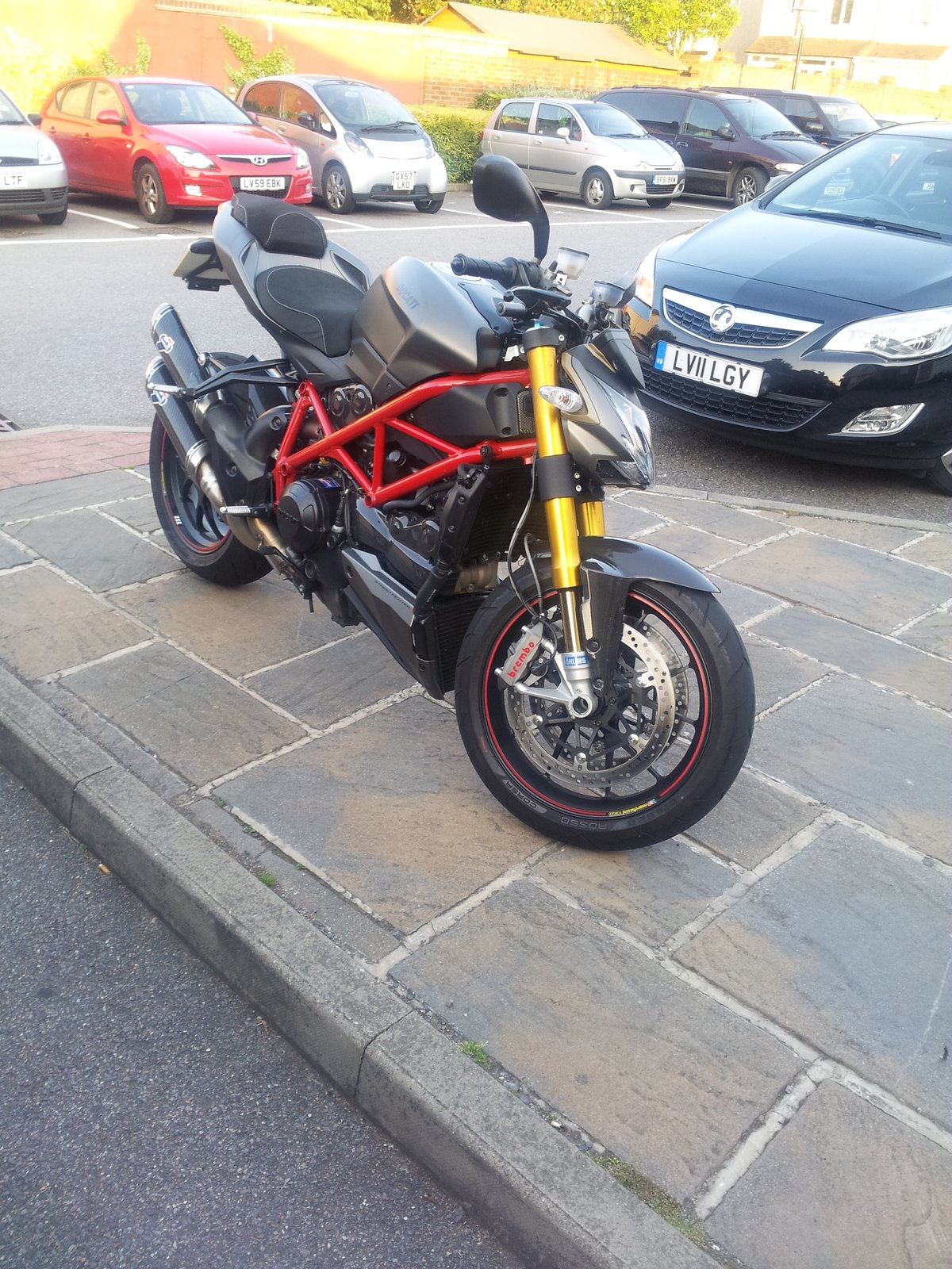

  1. My fave SF combo
  2. Red frame/gold wheels..think naked 1098R
  3. Yes I like......

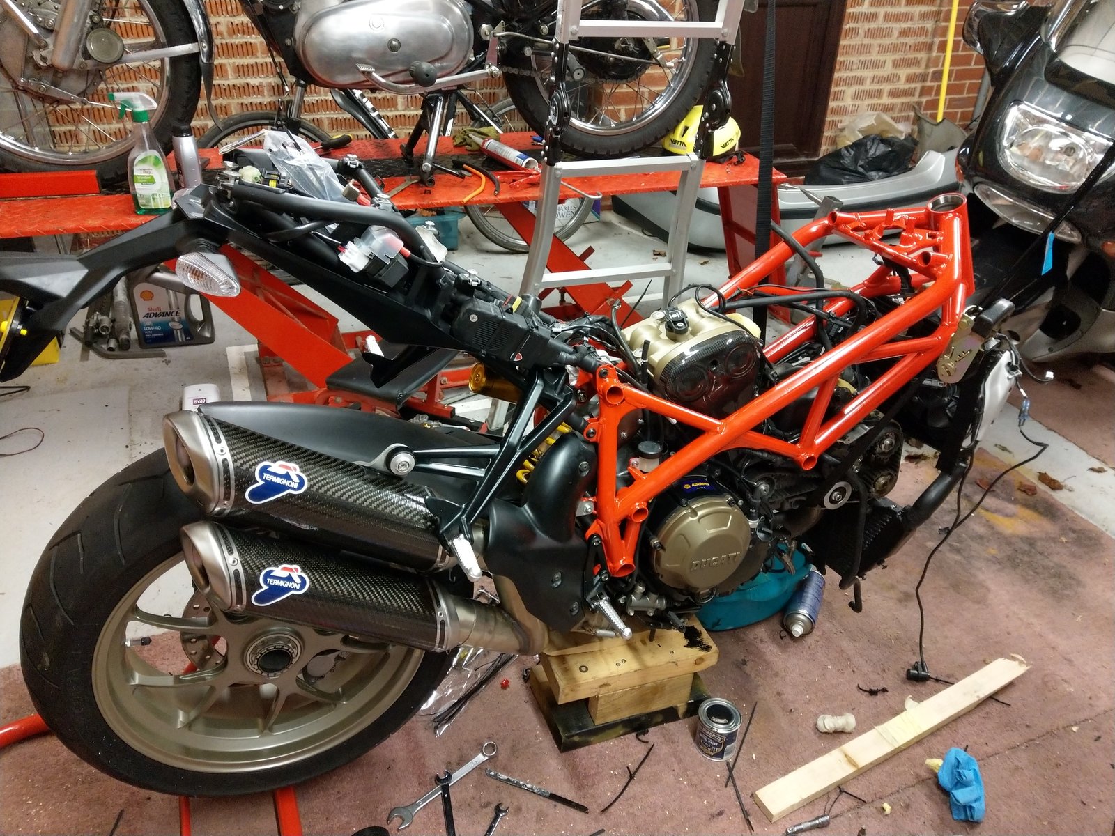

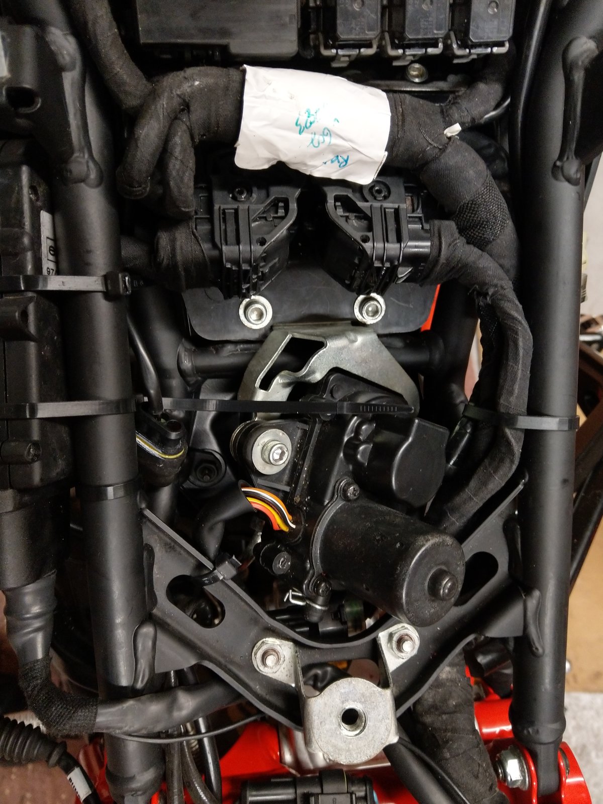

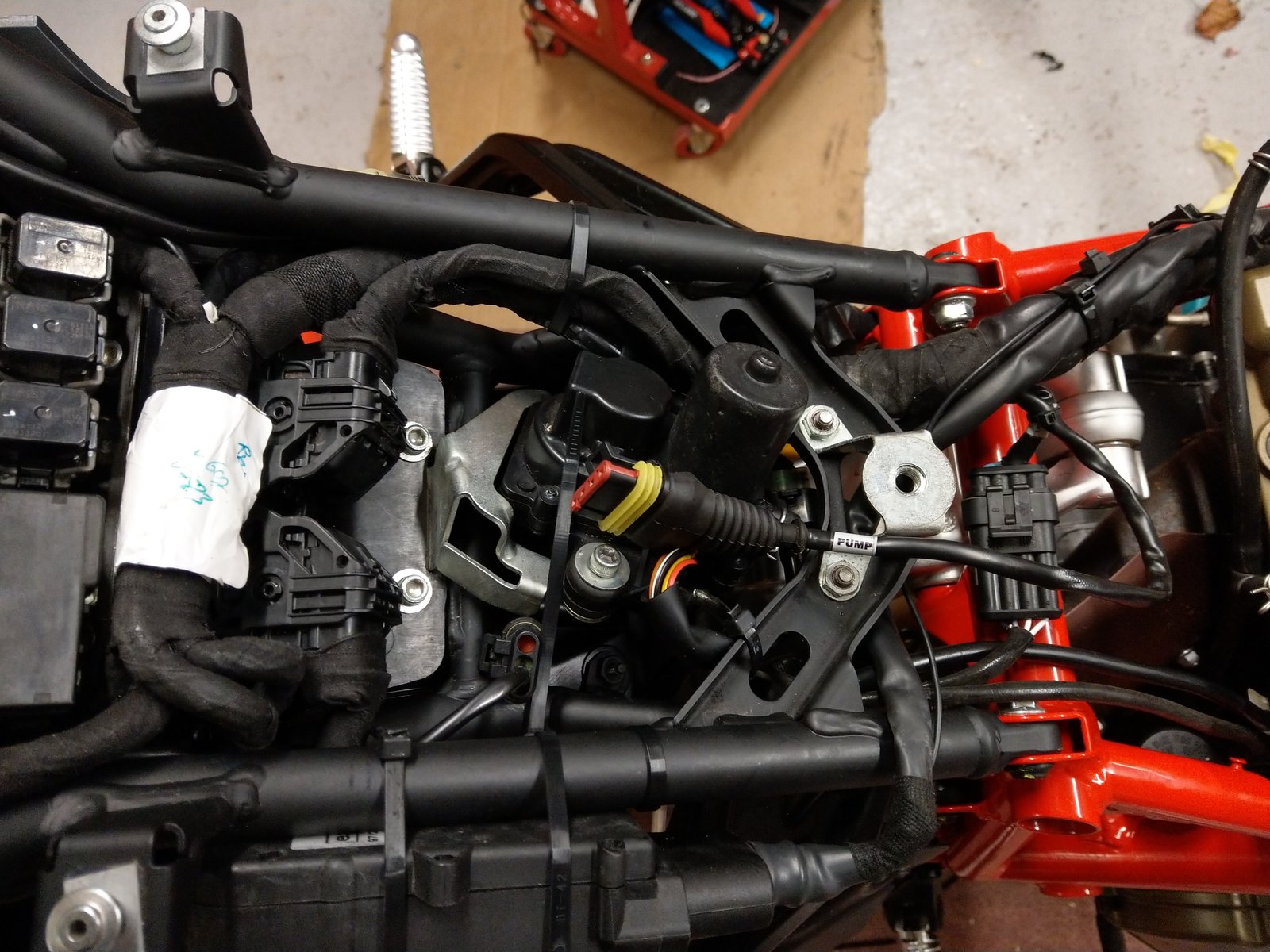

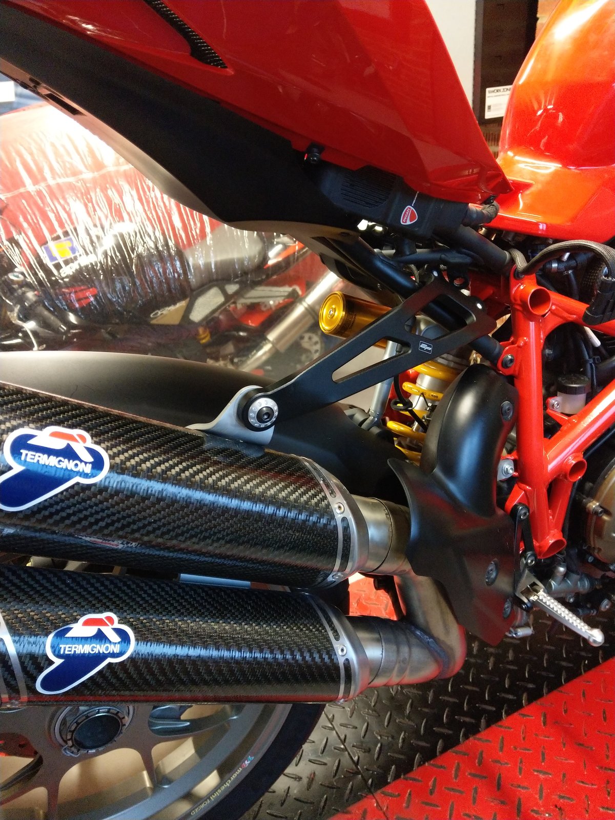

  8. Well Iv'e been making some good progress on the rebuild and thought i would post a couple of
    Piccies:
    I have to say that the replacement of the rear mudguard was 100% way more an arse ache than I ever imagined
    My cable routing is as good as it was to start with so happy about that. I am unsure about the rear foot pegs: Should I remove them I wonder ?
    #51 Eeza, Nov 22, 2018
    • Like Like x 10

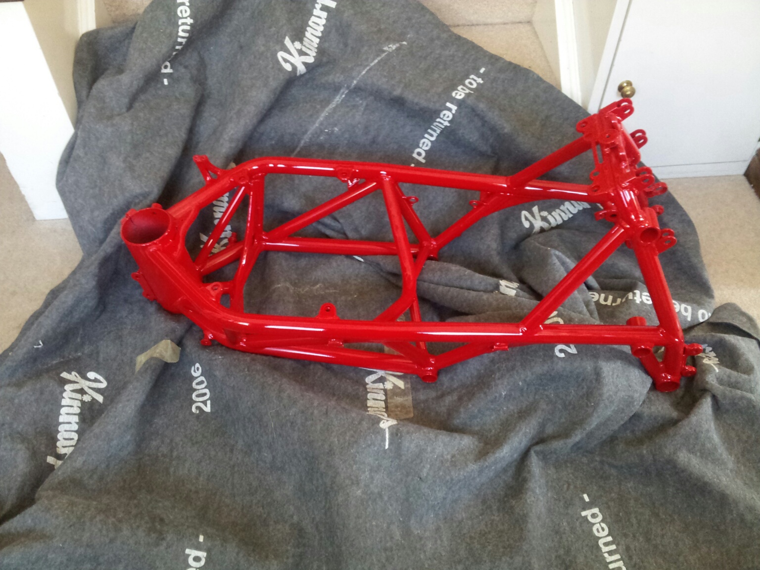

  9. I know its not the OE Colour but it had to be Red :)
  10. Looking good but I would junk those pillion pegs. .
  11. Just took them off :upyeah:;)

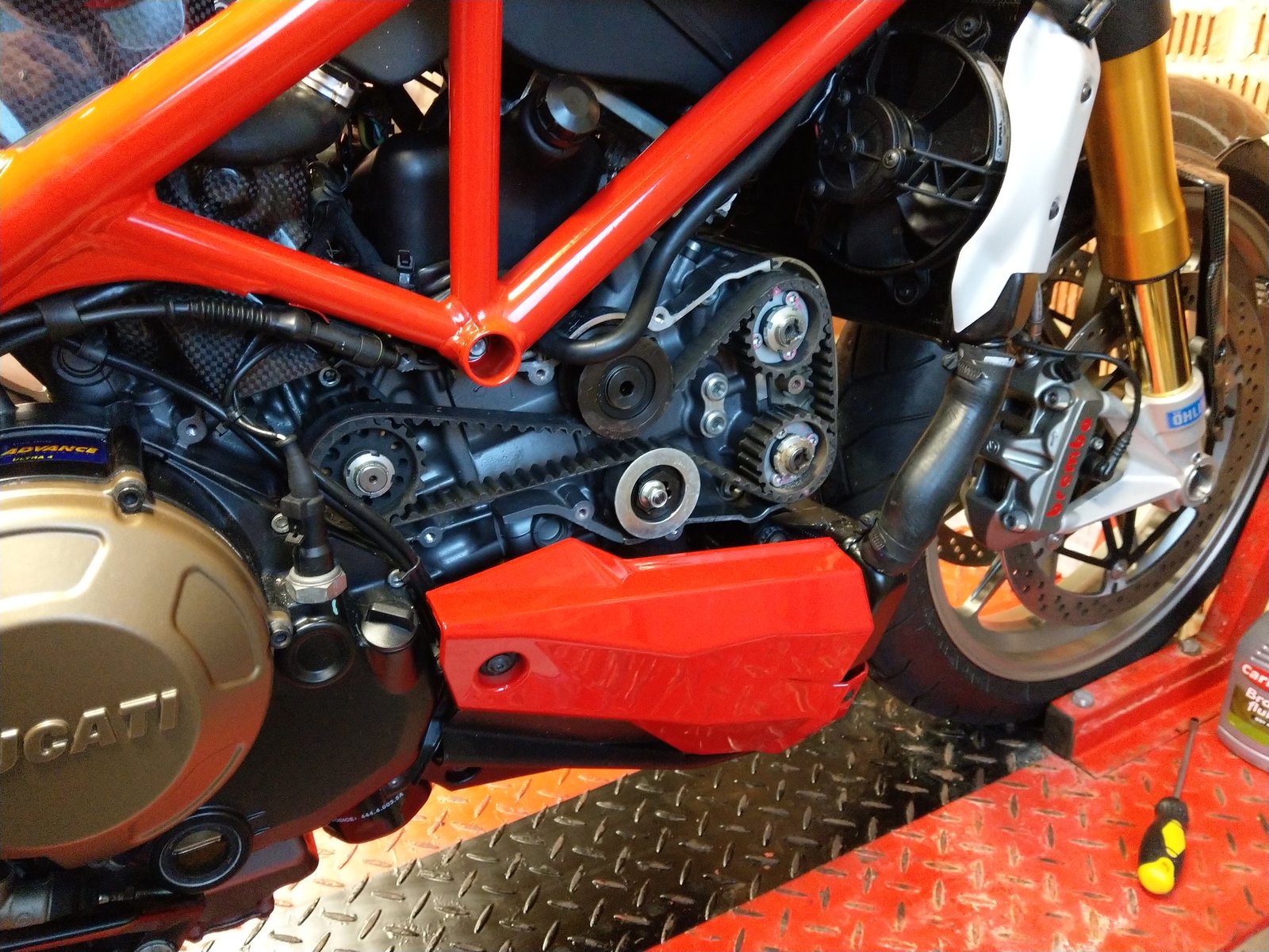

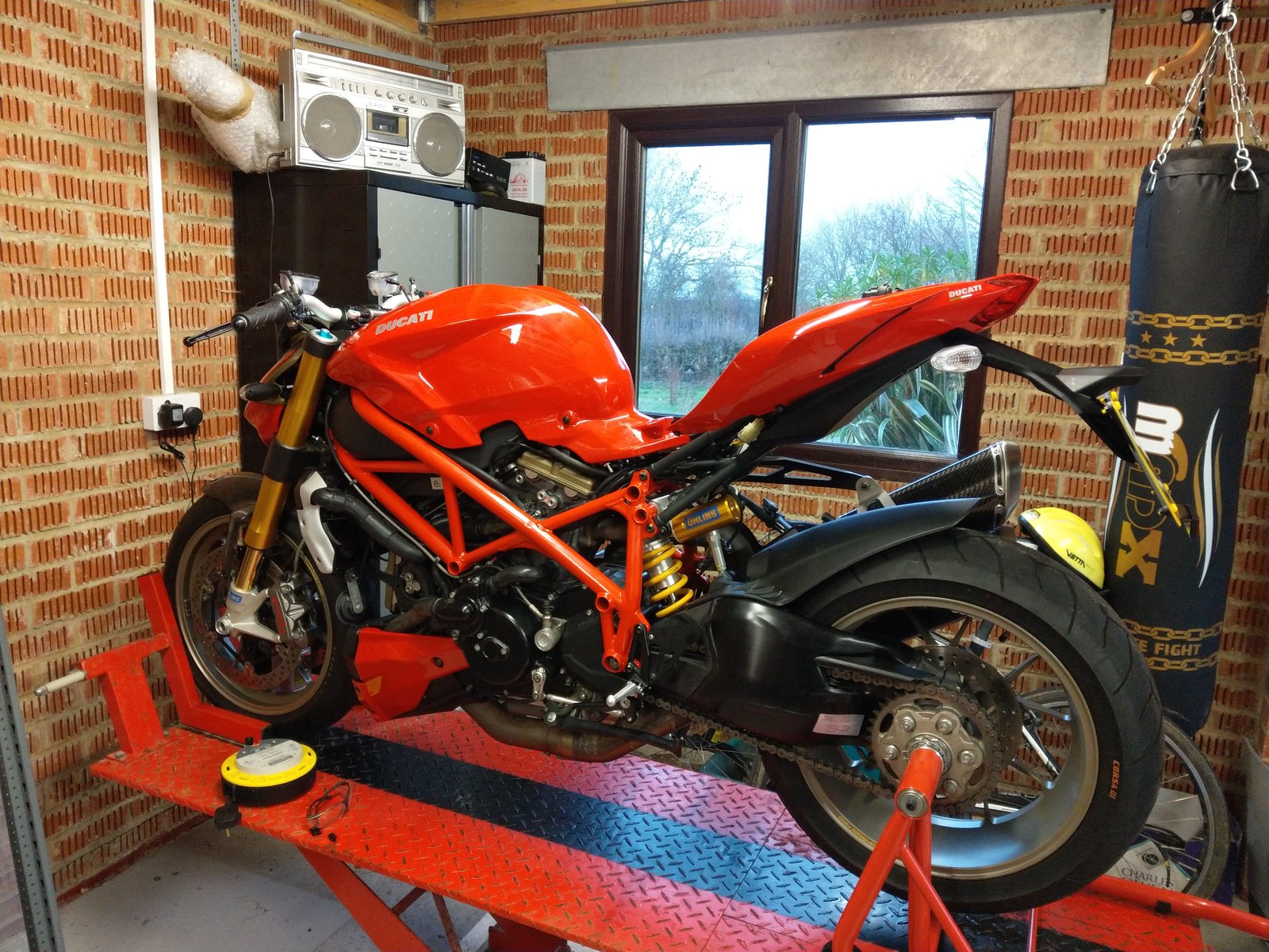

  15. I've all but finished the frame refurbish and just need to swap the belts. ... I am guessing it would have been easier with the frame off but it wasn't exactly solid on the wooden engine stand

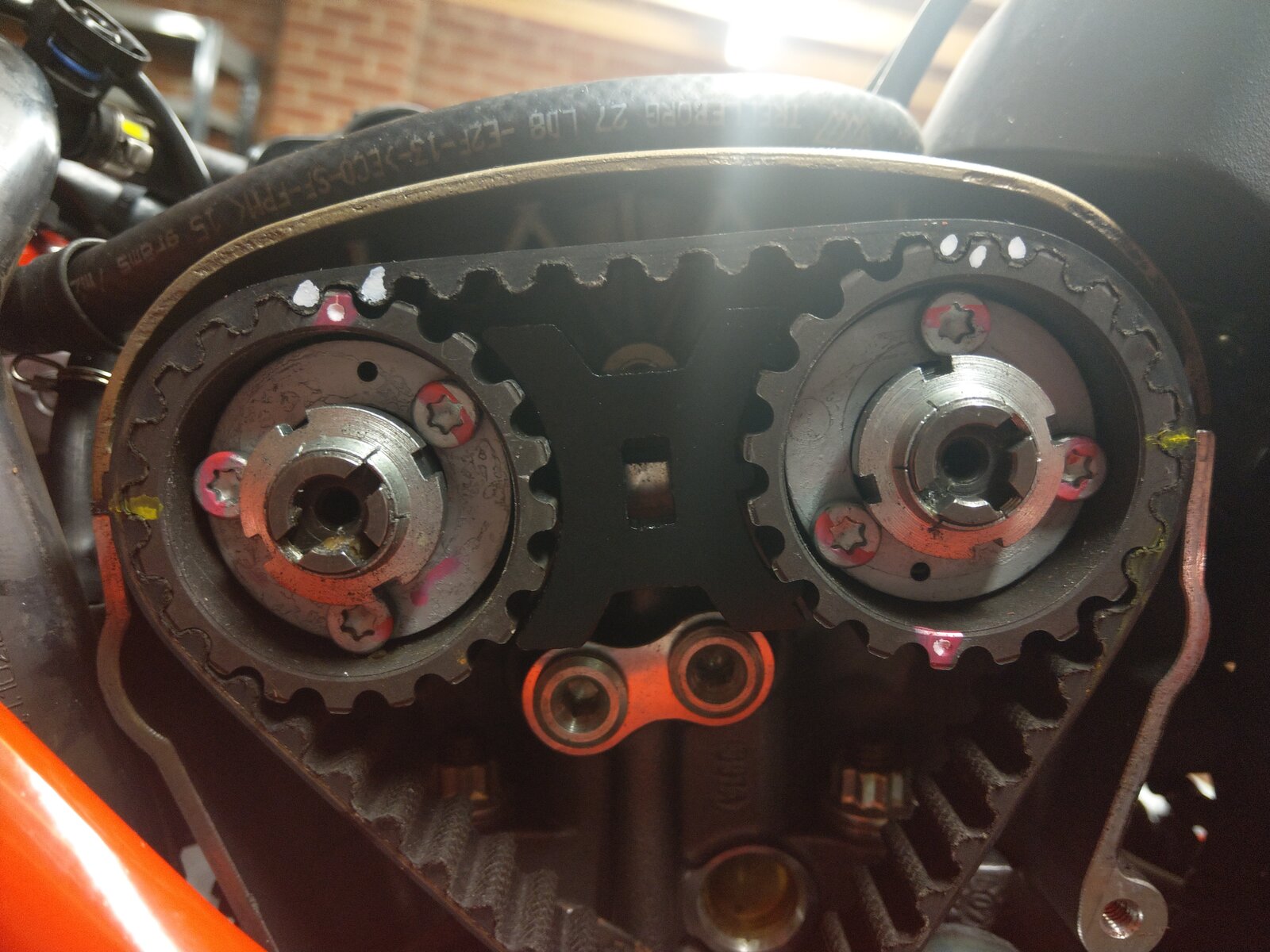

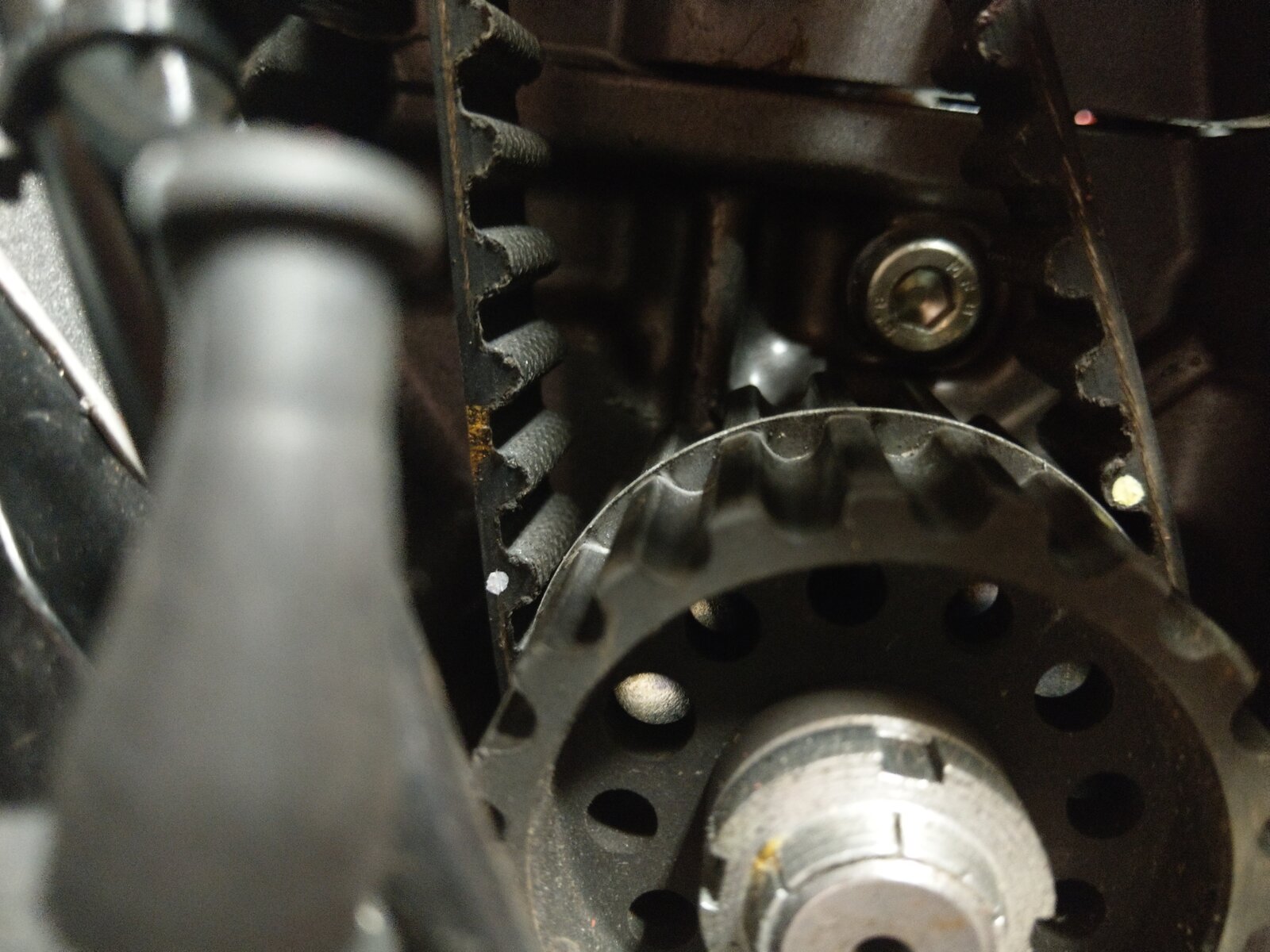

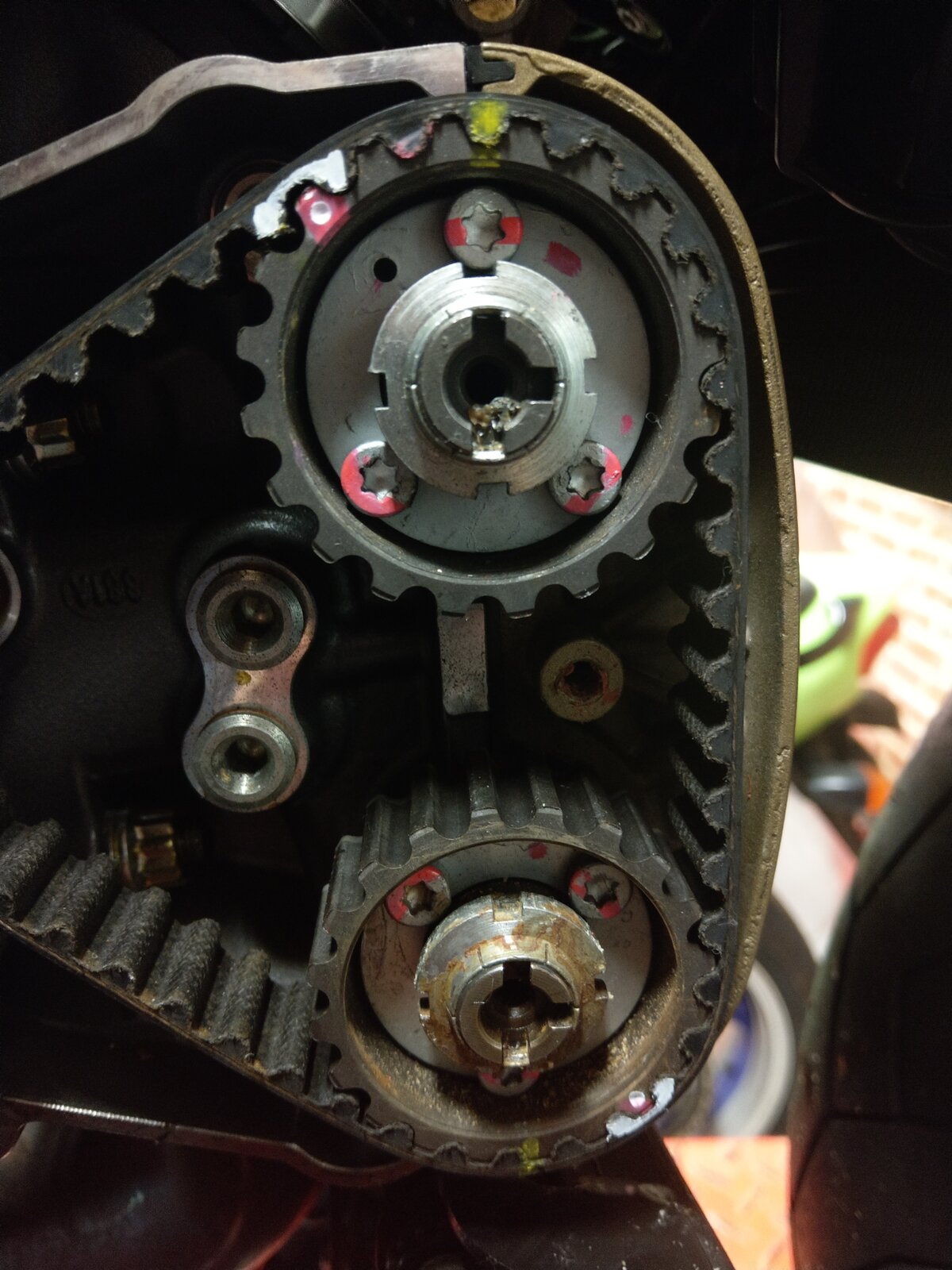

  16. I finished the bike 100% over Christmas and got the Timing belts changed as well, this was a very satisfying job. Don't be intimidated if your thinking of doing this as it really is a simple task.
    There is a pretty good guide on Youtube for the 1098 and its easy to follow.
    Honestly the hardest part was getting the carbon fibre covers off.

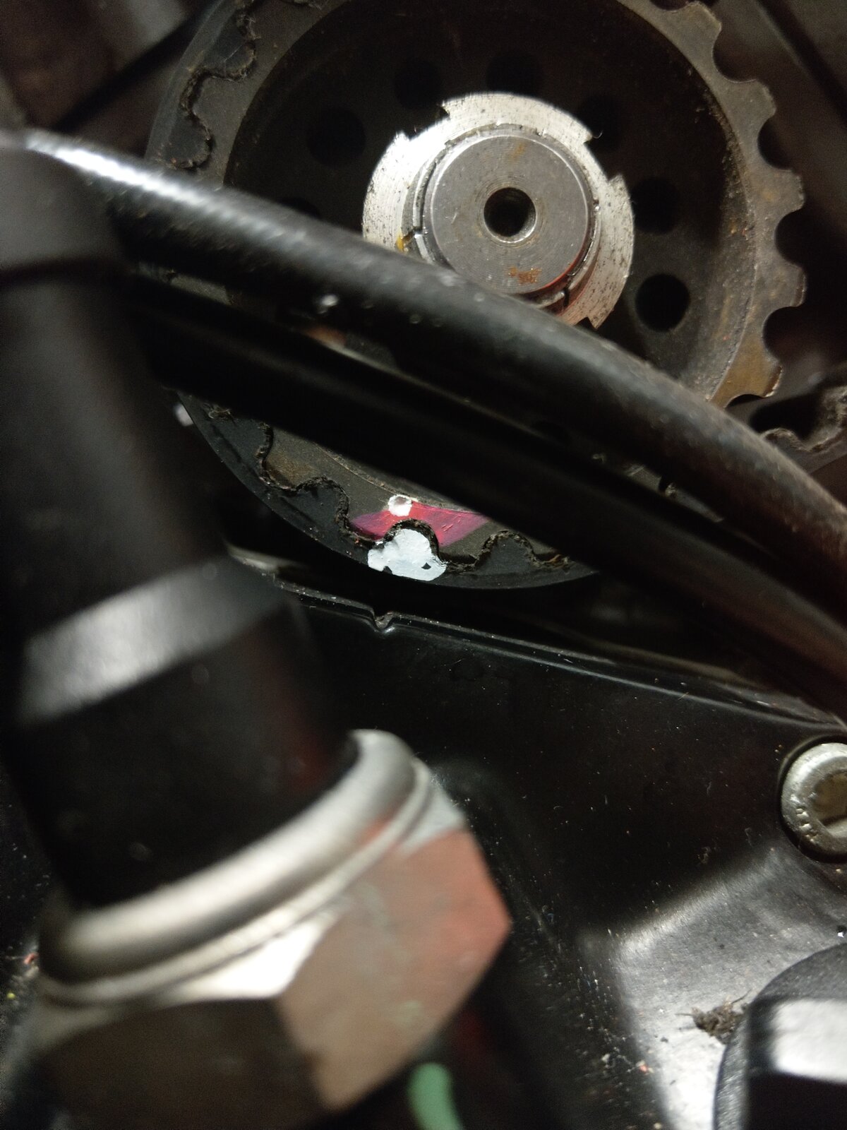

    I took some pictures of the cam's as they should be when the Horizontal Cylinder is at TDC and marked them up well.
    I bought a Cam holding tool to keep it all correct (Ebay) on the vertical cylinder and was able to complete the task in about 4 hours (Its a 3 hour job next time).
    I downloaded the Gates App to both my phones (Android and Apple) and got the tension to within 1hz of ideal on both devices so happy days.
    Here's some piccies but it really is simple and if you use your noggin and don't rush its a very satisfying job that anyone with a decent set of spanners can do. In this picture the Vertical cylinder is on its Intake stroke so the timing mark was not on the belt so just mark the belt AND the pulley to get it right.
