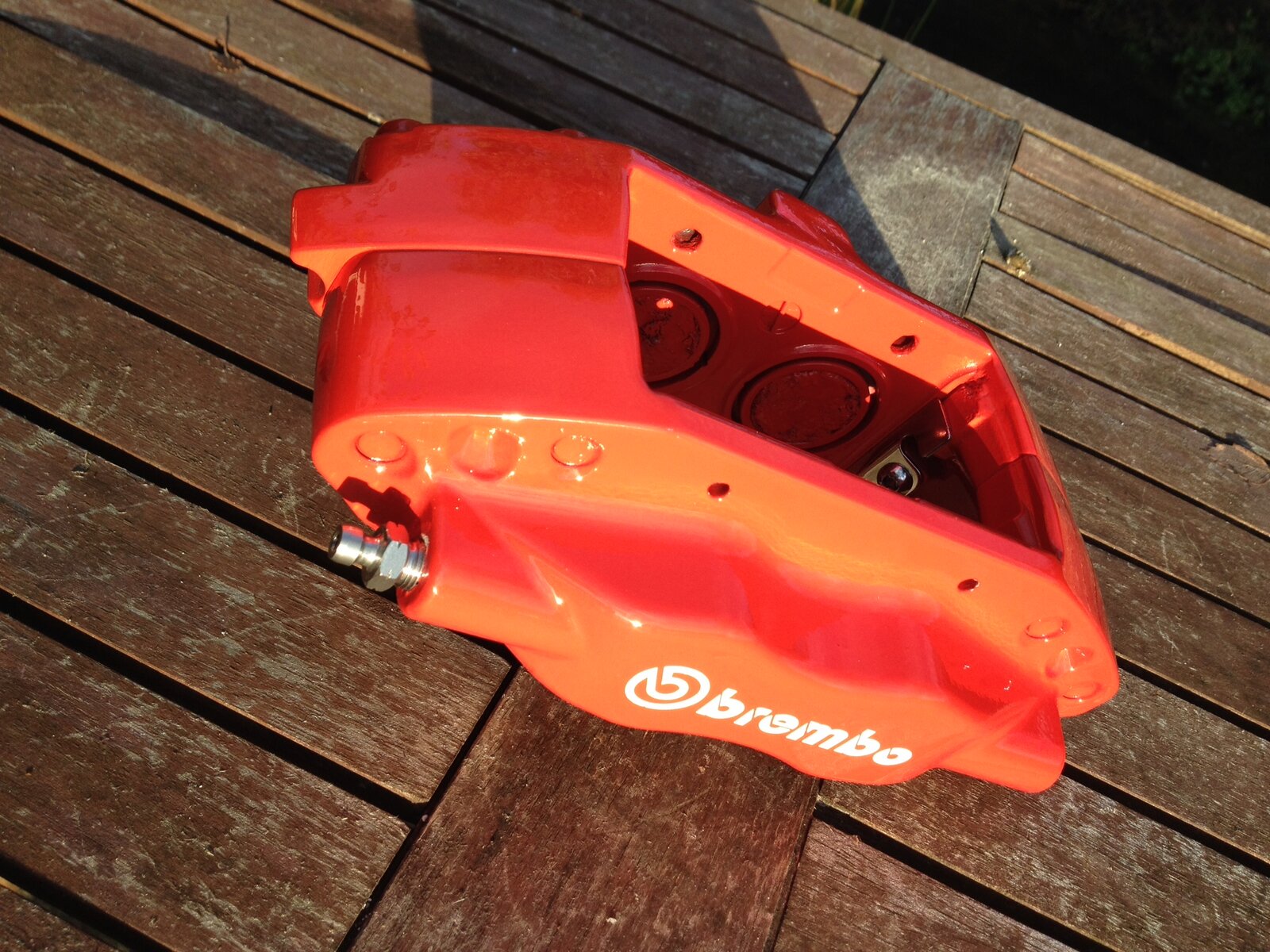

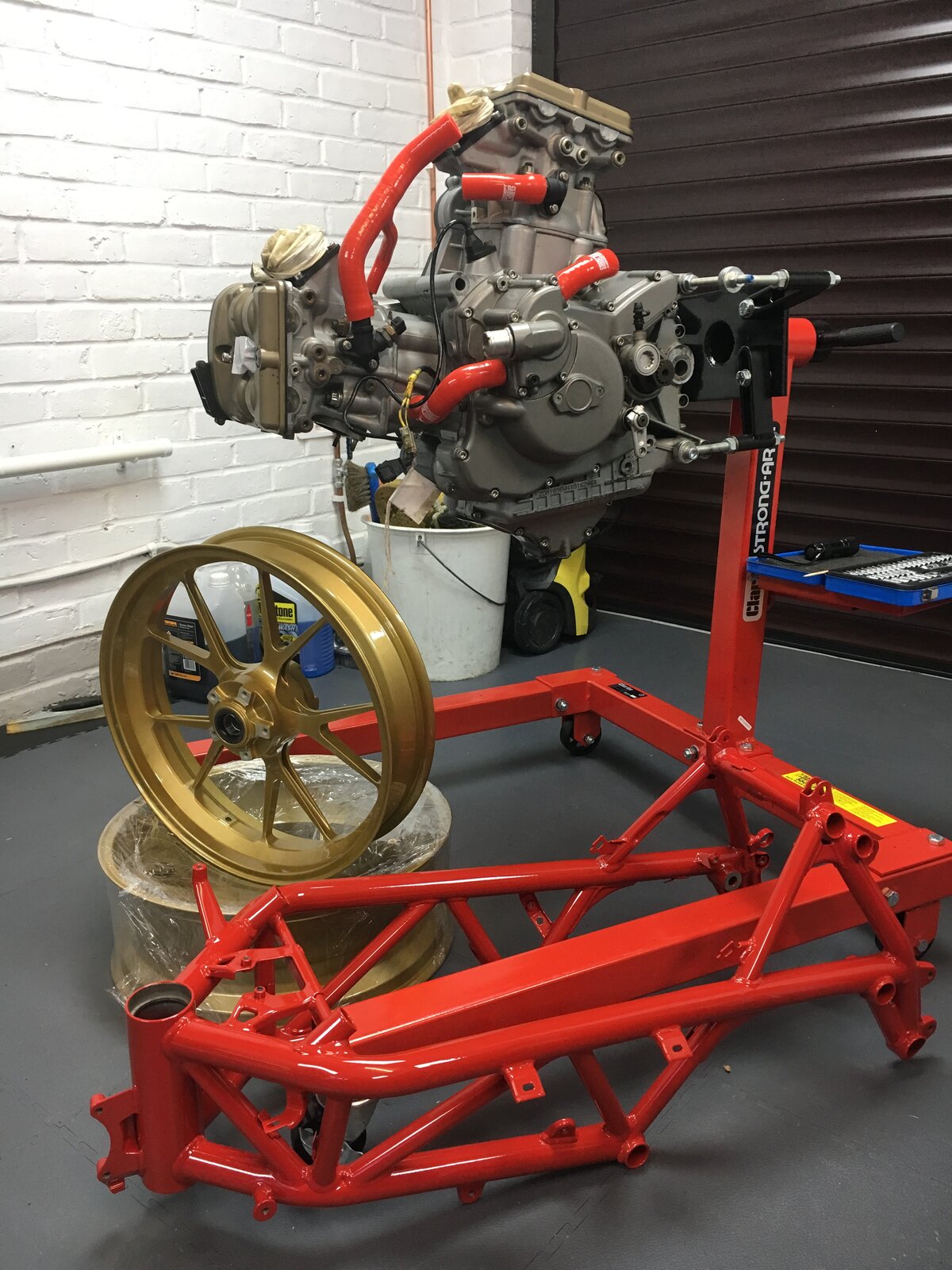

  2. 14ACDDF2-828B-4B9A-83FE-654D605BB433.jpeg Here’s one I did earlier, stoving (enamel) finish...

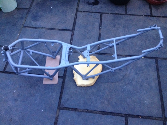

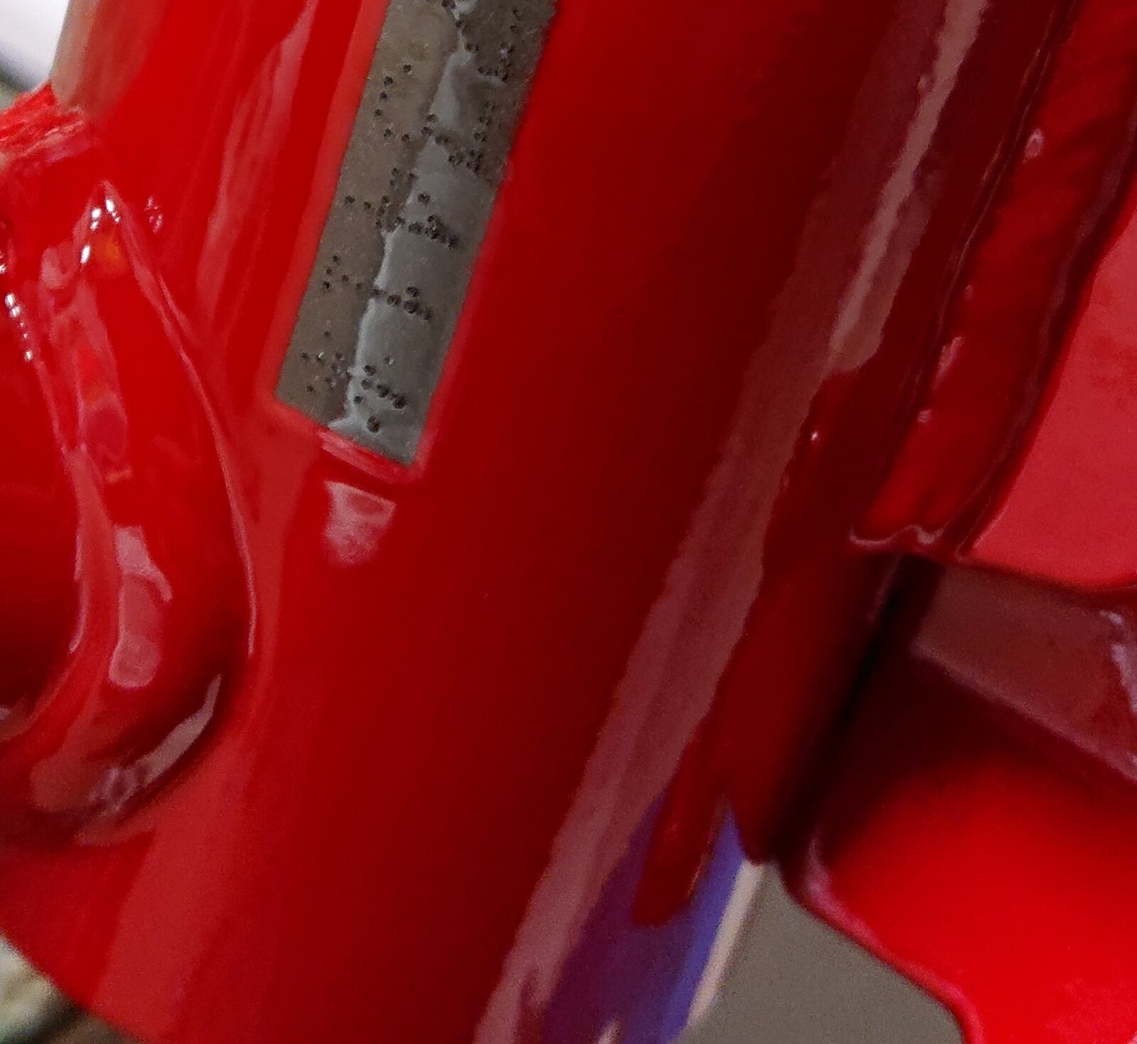

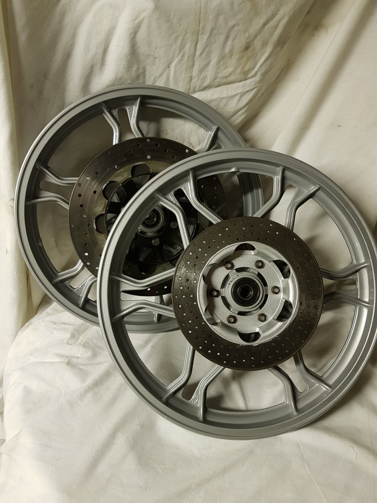

  4. IMG_5460-1.jpg IMG_5526.JPG I had a chat with Steve Turner at http://tpcs-magnesium-refurbs.co.uk/ decided to go for powder coating both the frame and wheels. Like Pete1950 I had him do the front wheel bearings to. I managed to coax the original VIN label off the frame using a heat gun and patience. Steve masked off the stamped number after blasting and before painting then clear coated it. Both the wheels and the frame are great, all the screw holes masked etc.
    Just need the engine overhauled and get the ride high adjuster bolt out the swing arm :mad: then I can start the rebuild!

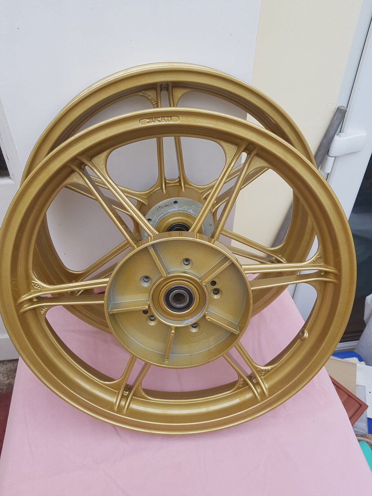

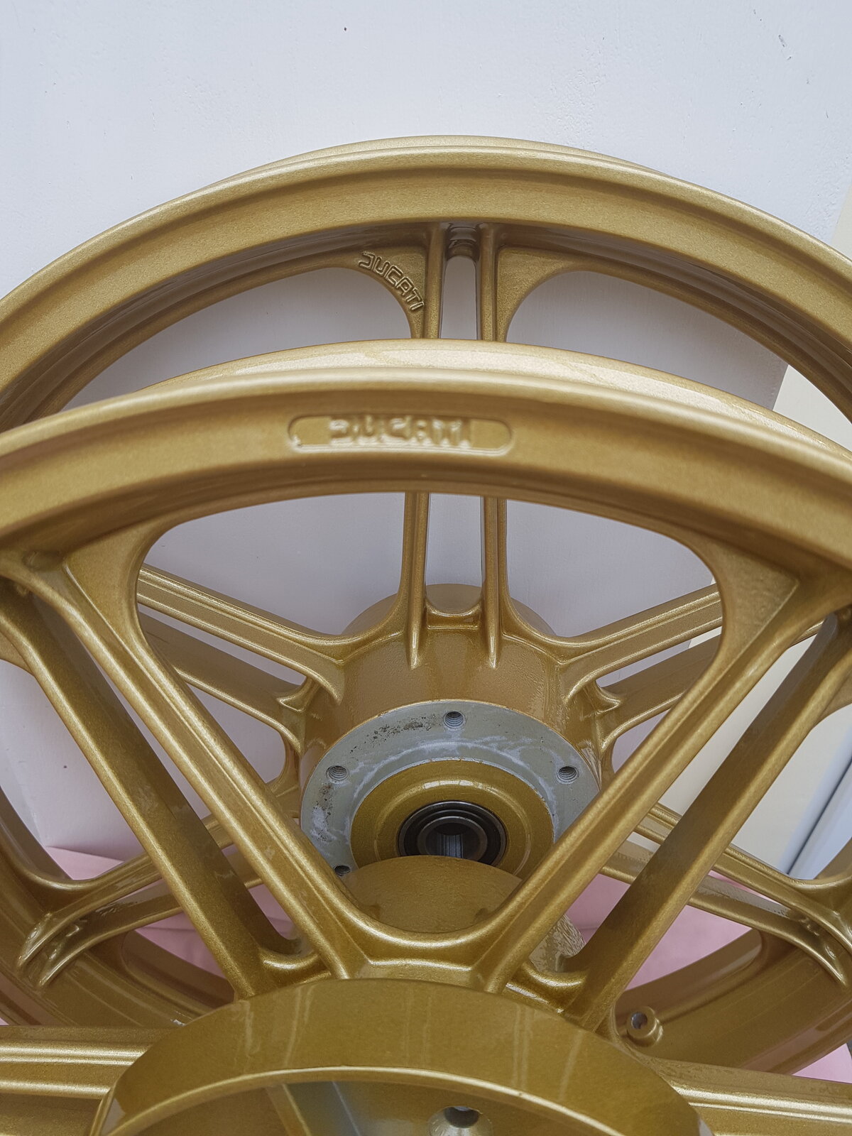

  5. Just got a pair of 1980 FPS wheels back from Steve Turner today, in Ducati gold. Up to the usual standard, i.e. excellent:
