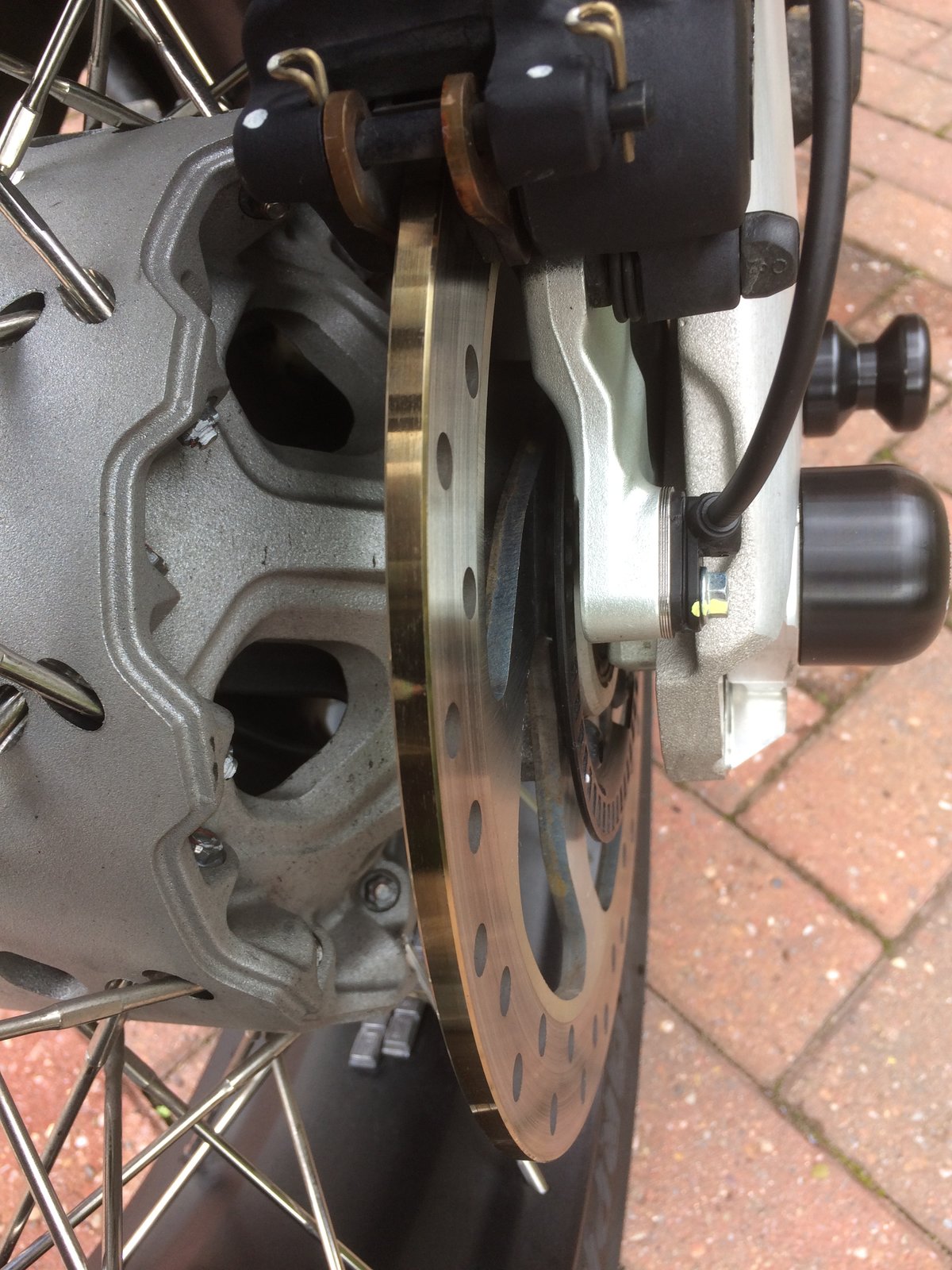

    The back brake on this Enduro is way better than my '10 MTS, but, after only 1500 miles the disc has gone a bronze colour. Seems like overheating, as if the 'hill hold' device isn't releasing the pads fully?

    I fitted a pedal extender so can now press no issue but it's also quite easy to drag brake without realising
    On my 2015 I incorrectly adjusted the brake free play reseting the pedal position
    Wheel turned freely on stand
    Took it for a ride next morning
    Less than mile from home and bike was not pulling well slowed down as soon as I let go throttle
    Pulled over as soon as I could less than 2 miles from home and a mile from when I noticed issue to find a glowing red rear disc....
    Slackened off pedal - let it all cool - no issues
    Disc was a blue straw colour everywhere and a witness of slight high spots next to drilled holes
    Brakes still worked fine no warp
    So the discoloration you see is nothing to worry about.
  7. Discolouration isn't anything to be majorly concerned about. It's probably got hot at some point but isn't an indicator that it's continuing to do so. The only thing to worry about is whether the overheating has caused it to warp, which is likely if it's a continuing issue. If it's warped then you'd be able to feel it.
