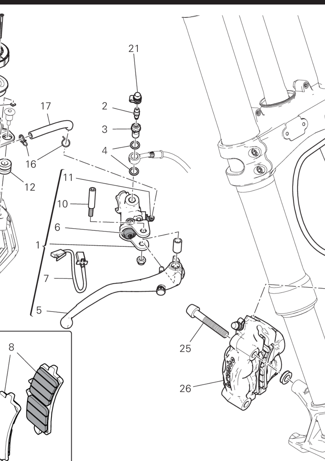

  2. Not heard of an issue with the micro switch on the master cylinder but certainly sounds like the prime candidate. The switch body has a split spigot that locates in a hole in the body and can easily (and gently) be levered off with a flat bladed screw driver. You can then operate the switch by hand to see if it works. Andy
  3. The micro switch that sits under the master cylinder is secured with a small philips screw and locates on a peg, so I think we’re on the same thing.
    I’ve taken it off and pressing it makes no difference to the light. I’m assuming it a break to make switch, the light comes on when the plunger is out. But nothing.
    Does this switch definitely operate the rear light?
  4. Item 7.. operates the brake light. Like you say, when the microswitch pops out the light should come on. It also should have been checked on the MOT.

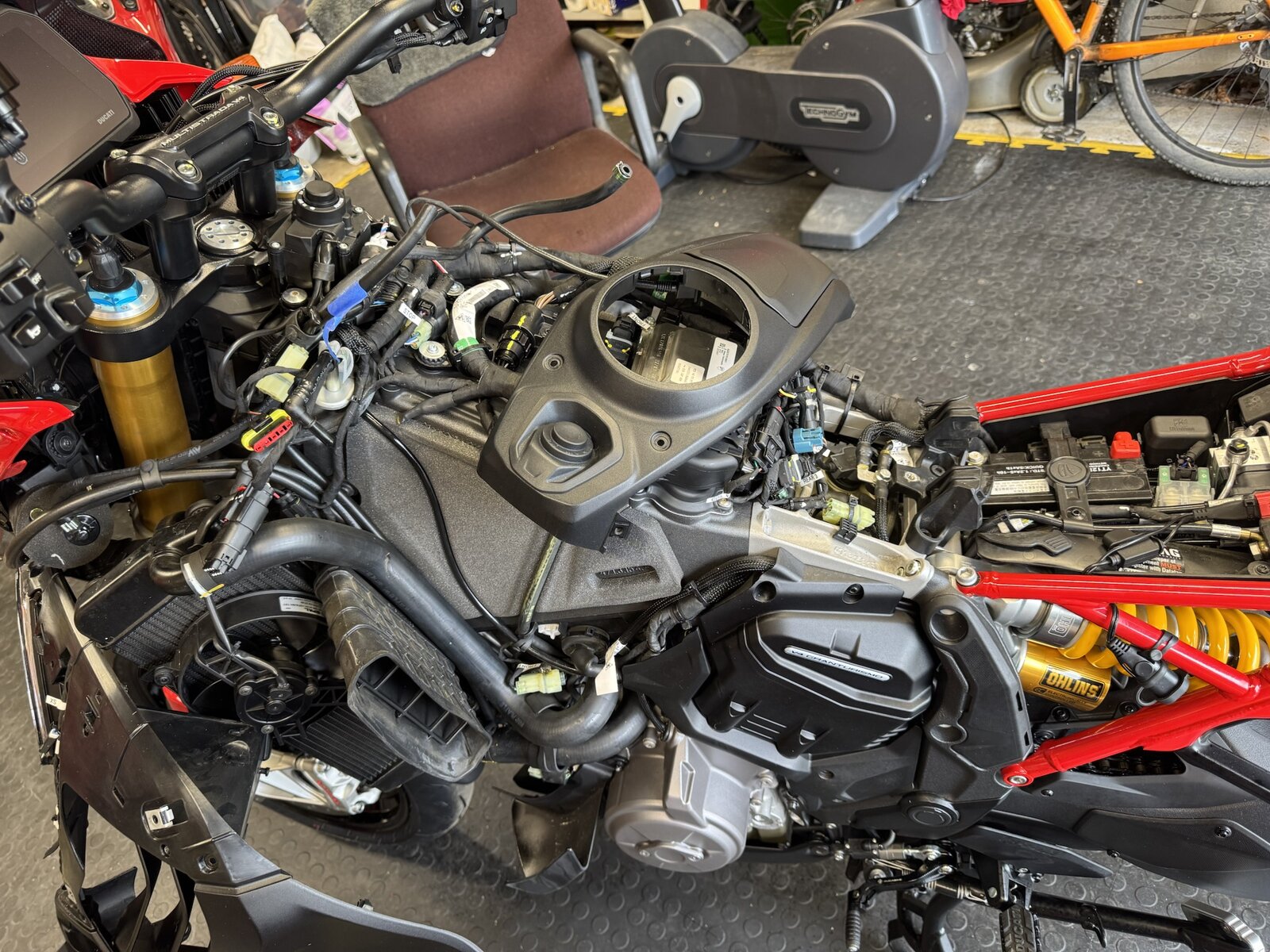

  5. Looks like I’ll be removing the tank tomorrow to get access to the plug, so I can link it out and establish that it definitely is the micro switch.
    Joy!

  13. You could have just shorted out the two pins using a multimeter on the microswitch, to test if it was boogered.
  14. I had to get access to the joint to do that and it’s under the tank. I was tempted to cut into the wires to test them, but it felt a bit heath robinson.
    Amyway, tank off, plug shorted and I’ve established the micro switch is indeed faulty.
