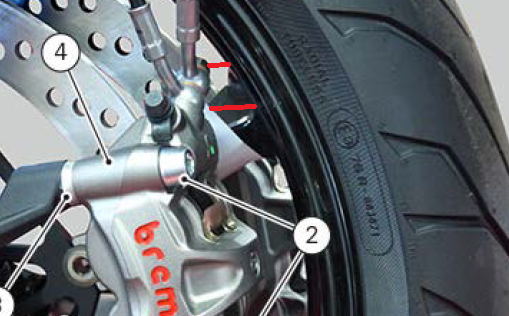

  1. well it depends if there is room to pull the caliper down on the pipes to achieve the same thing.

    Err, you may be overthinking this Simon - the problem is getting the calliper off the disk, the gap between the disk and the wheel rim is always going to be constant whether the wheel is in or out.
    Reading the post it seems it is possible to get the calliper off the disk but only just. Shame Ducati didn't do some joined up thinking and put an angled bango bolt in place which would make things much easier. Glad I've now done my pads so apart from a front tyre I shouldn't need to disturb the front end for some time.
  3. Didn't you mean "underthinking"?
  4. Guys
    I agree with the comments that you can get the caliper off - JUST - with the wheel in situ.
    But raising the wheel (by removing spindle) or dropping the caliper (assuming the pipes have enough play) increases the tangential clearance between the banjo bolt and the wheel - see the 2 red lines.
    That was what I was trying to say
  5. It does not really make any difference Simon as the main caliper body hits the wheel rim, so it's still got to be twisted off thus pushing the pistons back in before removal. :upyeah:

    :p
  7. removing the axle obviously won't make any difference, nor will "dropping" the caliper, not even sure what that means. The only way to make it easier is to unbolt the disk, which is completely unnecessary
  8. The caliper body (on my dvt) does not hit the rim, just the stacked banjo bolt.
  9. yup, missing a few geometry laws here
  10. In the picture the bike has 5mm spacers, so it's possible to drop the calipers a bit. Not certain it will help tho: still has to get over the same size disc
  11. when you are squeezing the caliper between the disk edge and rim the caliper mounts are right out of the picture
